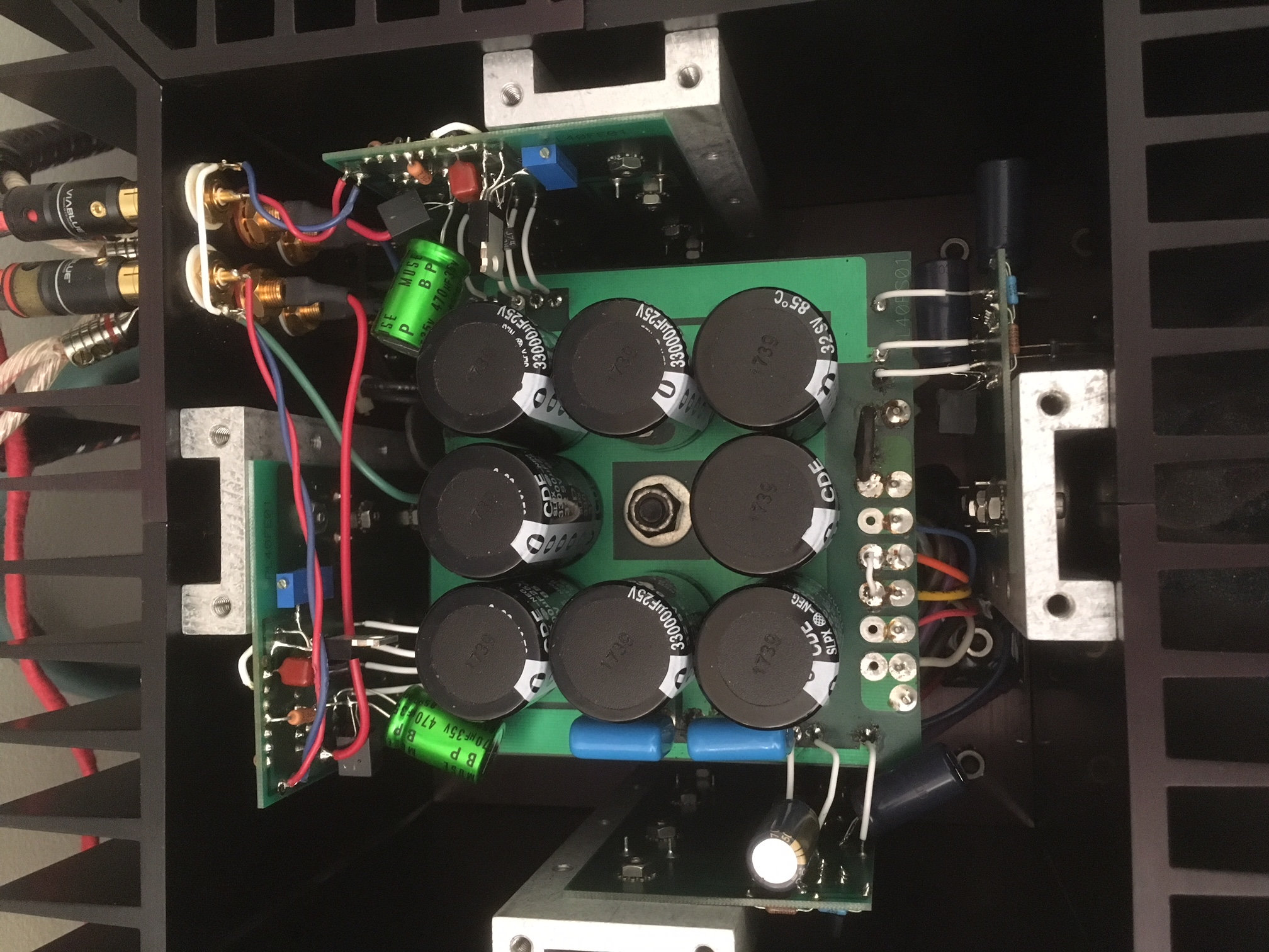

i have just finished recaping the power supply with 33000uf 25V cornell dubillier instead of the 22000uf . as it impossible to make a CRC or CLC with the stock power supply PCB . is it worth to by pass each rail with a 20 or 30uf MKP or just leave it at is 🙂

Same diameter caps ? What does it look like before/after ?
angle of green is much greater , when you succeed squeezing few motor-run caps in there
so , it's worth it
so , it's worth it
what's exact value of rail voltage now ?
25V caps ....... you need at least 2V leeway there , so rails higher than 23Vdc is just looking for trouble

the stock 22000 was 25V too , with 2. 3V,4V rail i didn't power up yet with the 33000uf as i'm waiting my 9610 replacement perhaps i should put small resistor between the + & - of the rectifier and the capacitor bank ?
the stock 22000 was 25V too , with 2. 3V,4V rail ........
in that case you're good

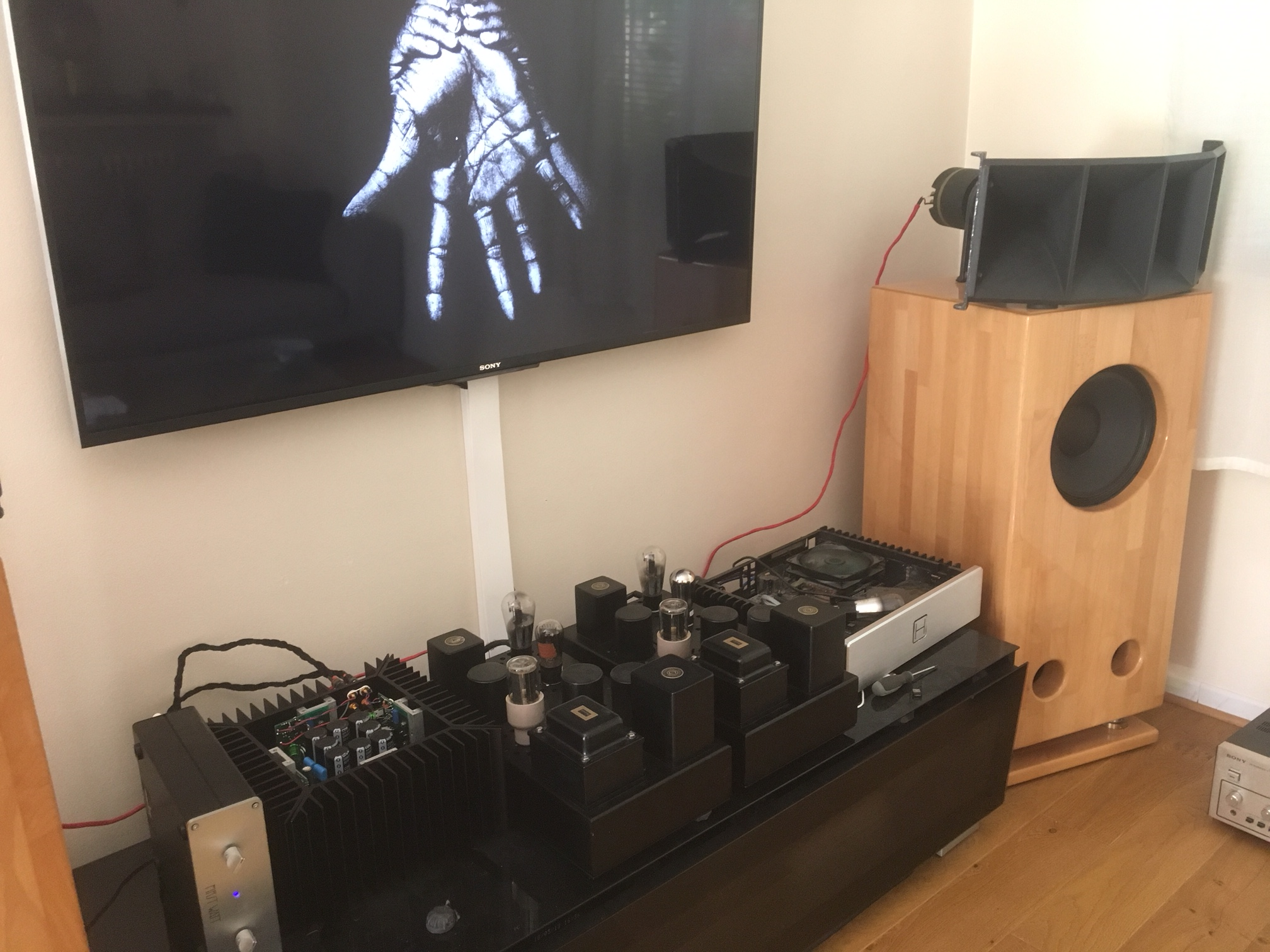

Aleph 3 new start , finally mounted with Jfet input , new bank of power supply capacitor , Zen mod
C1 C2 C3 with 470uf and 100nf parrallele ( FC and Muse BP for the feedbach)
what to say , the low end seems more present but with less control than with the 9610 input , medium a little recessed . let's have some burning time
the Sony pushpull VFET is still the winner for the moment with less bass but more refined medium. 🙂
