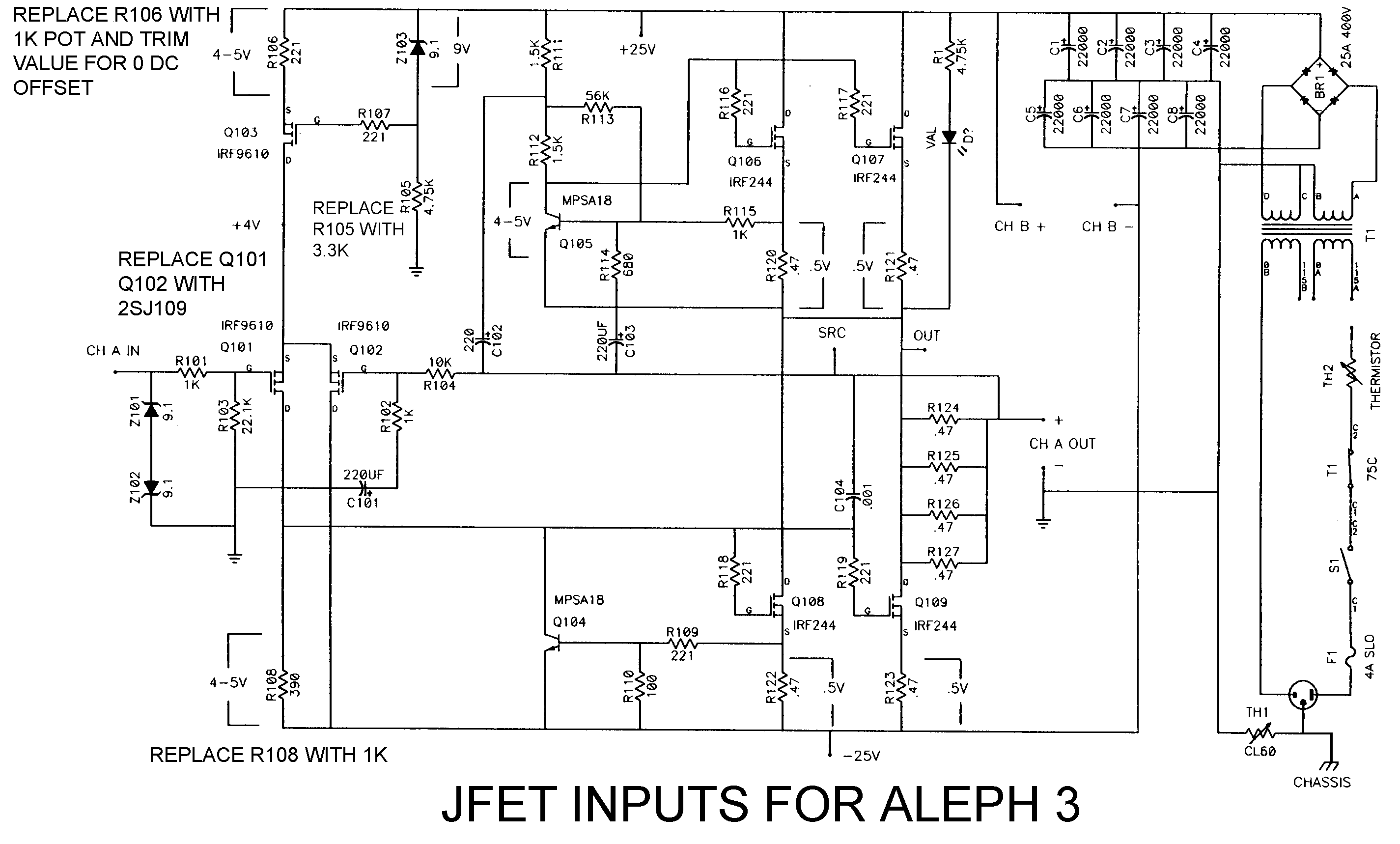

some strange idea comes to me this week i have change the irp244 on my aleph Mini with a Sony SIT 2SK82.
i just dial the upper CCS to 1.5amp and put a negative supply on the Vfet betwwen 21V negative rail and vfet gate to get 1.5amp bias
swap the input jfet and attack directly the Vfet input with a capacitor.
and put a 10000uf capacitor on the speaker output for safety 😀
so let say it's a L'amp CCS with bipolar supply.
but you know what it doesn't work , can't have 0V offset on the output ( always
-16V ) there is sound anyway not so bad ? is there a reason i can't have no offset here ?
i also wire it as normal l'amp CCS and it works fine at 19V 1.5amp so i have no problem with a chip somewhere..
i can't wait the ZM sentence 😀

Wakoo Froggie!
send that original Aleph to OPLDF , and play with some prototype ikebana style concoction ......... leave it be
without schematic , I'm refusing further (technical) dialog
i was pretty sure that was going to wake you up 😀
i have keep , the original PCB safe , but the aleph3 chassis is a perfect candidate for a Sitamp CCS. i will post a schematic of the monster later 🙂
