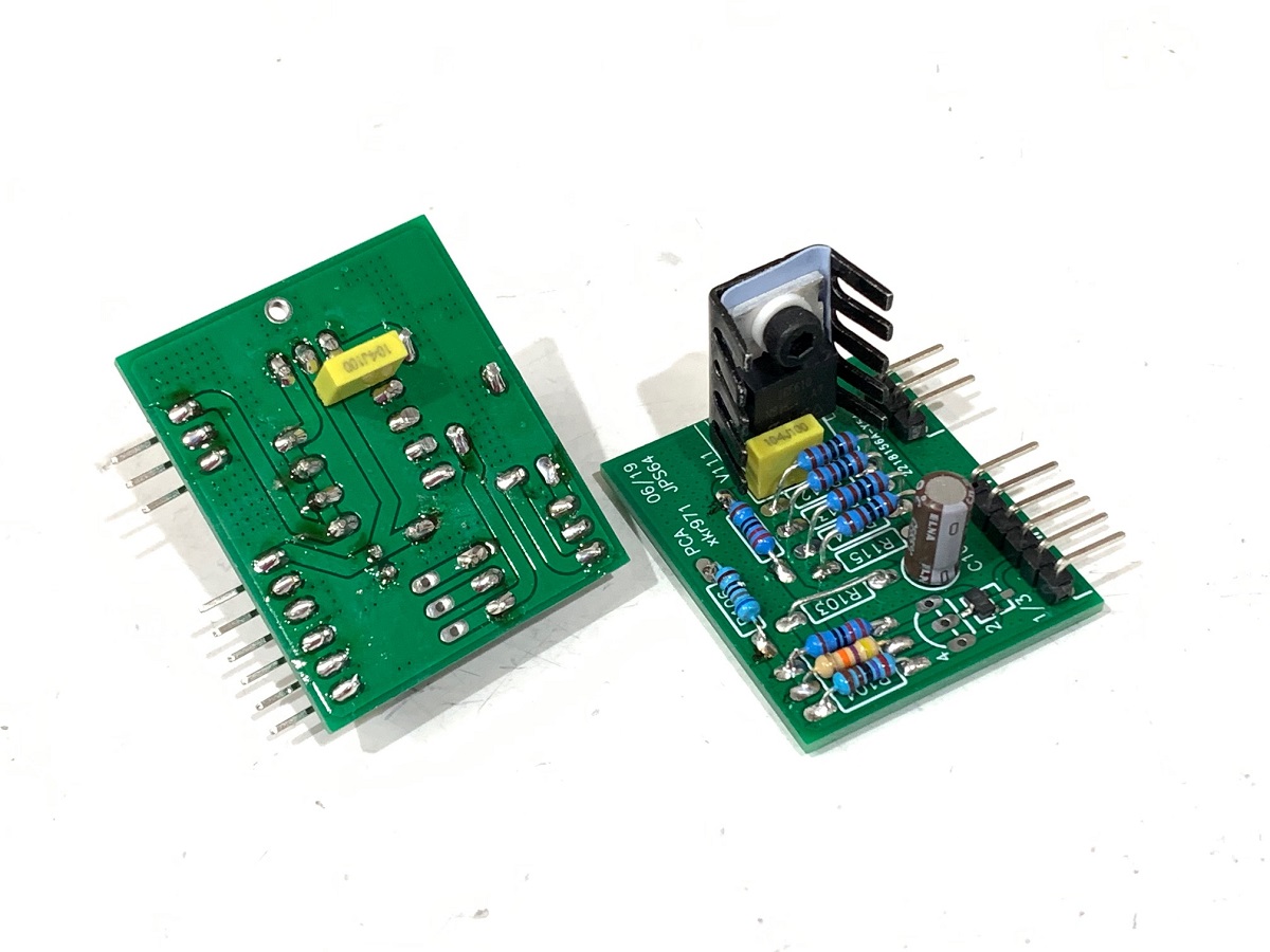

Hi vlv81. From one simpleton to another. It looks like you might be confusing the motherboard (MB) and daughter board (DB) resistors here. Just to make 100% sure – this is what you need:To me they are on the schematic as R14 10k, one for each channel, hence the 1 and 2 after R14.
R141 (MB) – 1 x 10k (Mouser: 71-CMF5510K000BEEB)
R142 (MB) – 1 x 220R (Mouser: 71-CMF55220R00FHEK)
R14 (DB) – 2 x 10R (Mouser: 71-CMF5510R000FHEK)
Thanks X and twocents. Posted and about an hour later sort of answered my own question but your replies have confirmed what I came up with. I have ordered the right parts so that's a plus. Thanks guys

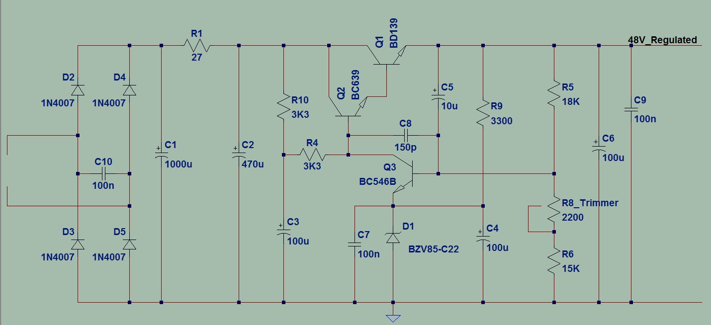

48V Power supply for AKSA Lender Preamplifier
Hello. I was looking for a suitable regulated power supply for AKSA Lender preamp and i came up with this design usually found in old receivers like Sansui,Marantz etc..
Is it a good idea to use something like that?Any other suggestions or improvements on this schematic?

Nice - what kind of ripple does it have under circa 45mA and 125mA load? Is it voltage regulated and what is output impedance?

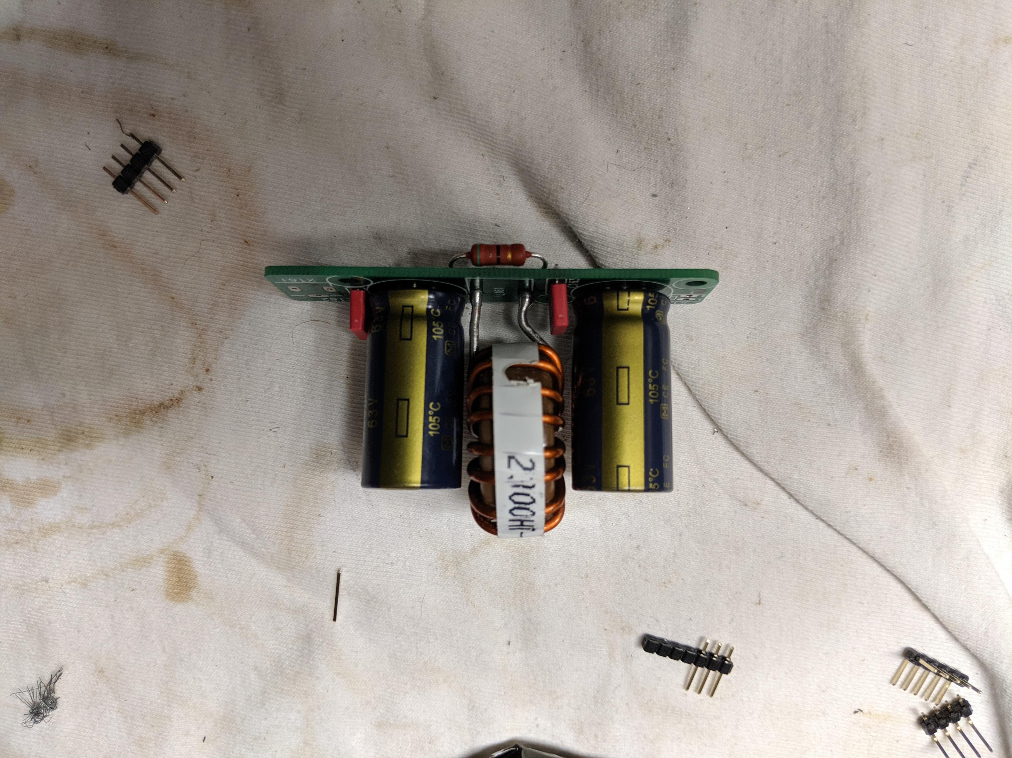

I built the included CLC so I could try some different power supply arrangements. I was under the impression that there would be some voltage drop through the circuit to account for. Hooking it up to a supply that measures 16.4v I still get 16.4v out the other side. What am I doing wrong? Ultimately I want to try a 24v supply for the HPA version I built.
Is that a no load test? At no load you aren't going to drop much voltage across the L||R
Yes no load. What would an appropriate load for testing be?
At the minimum test it at the load you plan to use. It can be helpful to test below and above the nominal load to record the response. Some SMPS perform best when they are operating near the rated load.
The DCR of that choke (designed for 3-5A) is almost negligible compared to the load for the Aksa Lender (about 100mA max). You won’t see any voltage drop really across the CLC filter. I would not expect to. The drop is going to be across the cap Mx on the board. That’s about 3.5v to 4v, then another 0.5v or so across the CRCRC after it. So the DC supply upstream needs to be 4-5v higher than what you want for rail voltage.
FWIW, member Vunce found that a linear supply at 48v gave much lower noise than a SMPS step up. It’s noise in the 100kHz range so you can’t hear it and neither can the speakers reproduce it.

Interesting. I never implemented the supplied CRC in my Lender build, but always wondered about where in the chain the CRC would work best – before or after the Cap Mx – or does that not really matter? I might just use the supplied CRC pcb in another project.The drop is going to be across the cap Mx on the board. That’s about 3.5v to 4v, then another 0.5v or so across the CRCRC after it.

The CRCRC is built into the main board and comes after the cap Mx. The small CLC that comes with the amp should be used before the cap Mx.

Thanks X – I clearly got the filters confused and don’t understand their differences or working yet.The CRCRC is built into the main board and comes after the cap Mx. The small CLC that comes with the amp should be used before the cap Mx.

The CLC is a high frequency filter designed to stop 100kHz and higher noise form SMPS. Although if you put 1mH ferrite and 1000uF caps it is good down to 100Hz. The CRCRC is supposed to take care of any residual mains 50Hz/60Hz noise and other low frequency stuff.

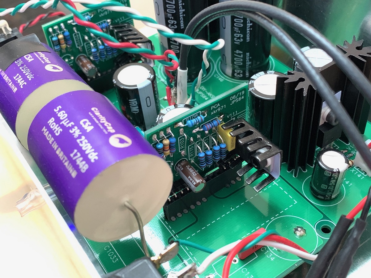

Just placed my order for a set of PCA boards. I am very interested to see what differences if any I can hear on my system using both speakers and headphones. Also assuming I can just plug these in since I have 24v going to the main board.

Thanks. If you have 24v going to the main board you should be fine as there is a 3-4v drop across the cap Mx. You don’t want the voltage to be above 20v and ideally about 18.2v (at the mosfet drain pin). I have a ton of orders to send out this weekend and probably next week too. But should be able to get the smaller orders like yours and Twocents our quickly.

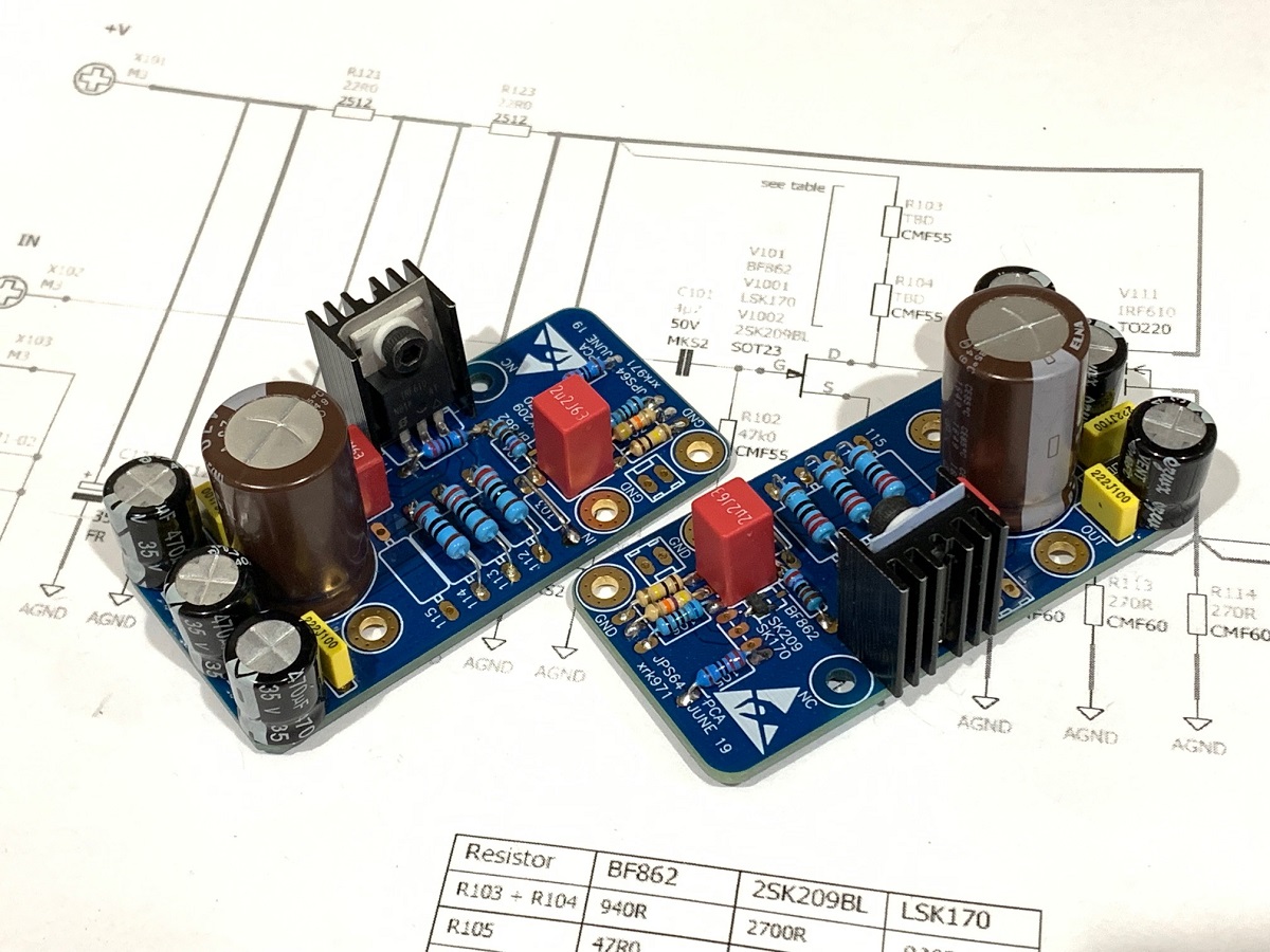

I tested the PCA for the Yarra and it works great. Head to modify the source resistors for setting the proper bias with the Sk209. Looks like the model for the sim was a bit off but using a pair of 2W rated 270R resistors gave me 122mA at a Vcc of 27.5v (yes I know that is high but what I had on Yarra). That voltage won’t kill the board with 2SK209, but would not work for the BF862. I am almost finished building the BF862 and think I will use a setting for a much lower bias of around 60mA for use as a preamp or higher impedance headphone amp.

The PCA for Aksa Lender has been tested and it sounds great! Easy to build too.
