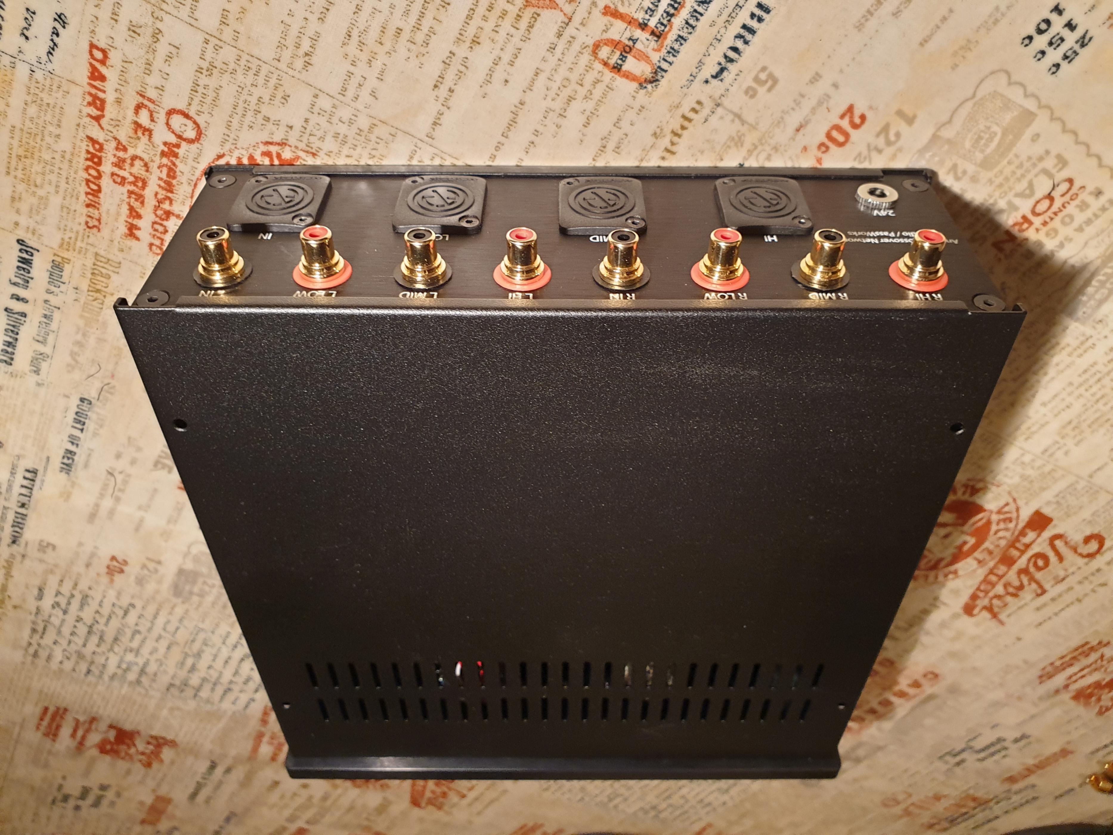

Regarding the chassis, I used the Analog Crossover Network case. I haven't got access to a drill press to accurately drill holes for the various sockets and such. The back of the front panel already has pilot holes so the volume and selector switches were guided by those.. Four £0.79 blanking plates took care of the XLR holes.
I have the volume control and connector cable and its socket free to anyone who wants them, for the price of the postage.
The black phono connectors were ordered in error but I didn't want to waste them. One of the mistakes I mentioned previously.

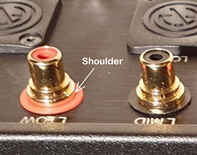

Yes, Skylar, you are 100% correct. The should ensures that the inner metal part of the RCA does not touch the panel.
HD
HD
Oops. I'll sort that out after work. That's a sharp pair of eyes you have. I had checked them all with a meter to ensure no shorts to the chassis though. Thanks Skylar.
I think that’s a reflection / optical illusion. I think shoulder is indeed correct.
And I think you are correct, X. Looking at it again, it does look like it's just a reflection. 😱
Sorry for the false alarm, SuppersReady.
Thanks for looking out for the potential error.

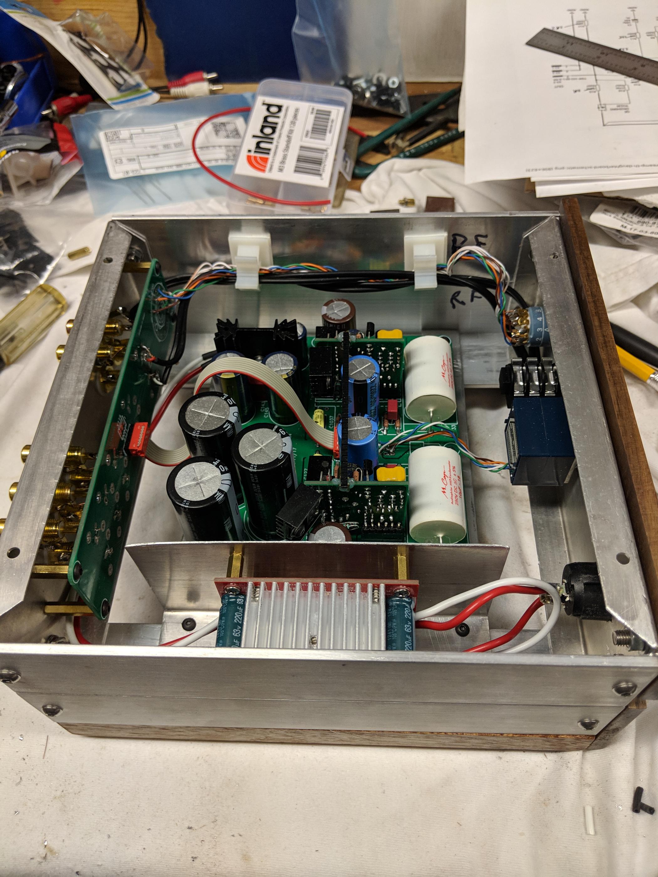

Internal construction details:
Aksa Lender HPA
