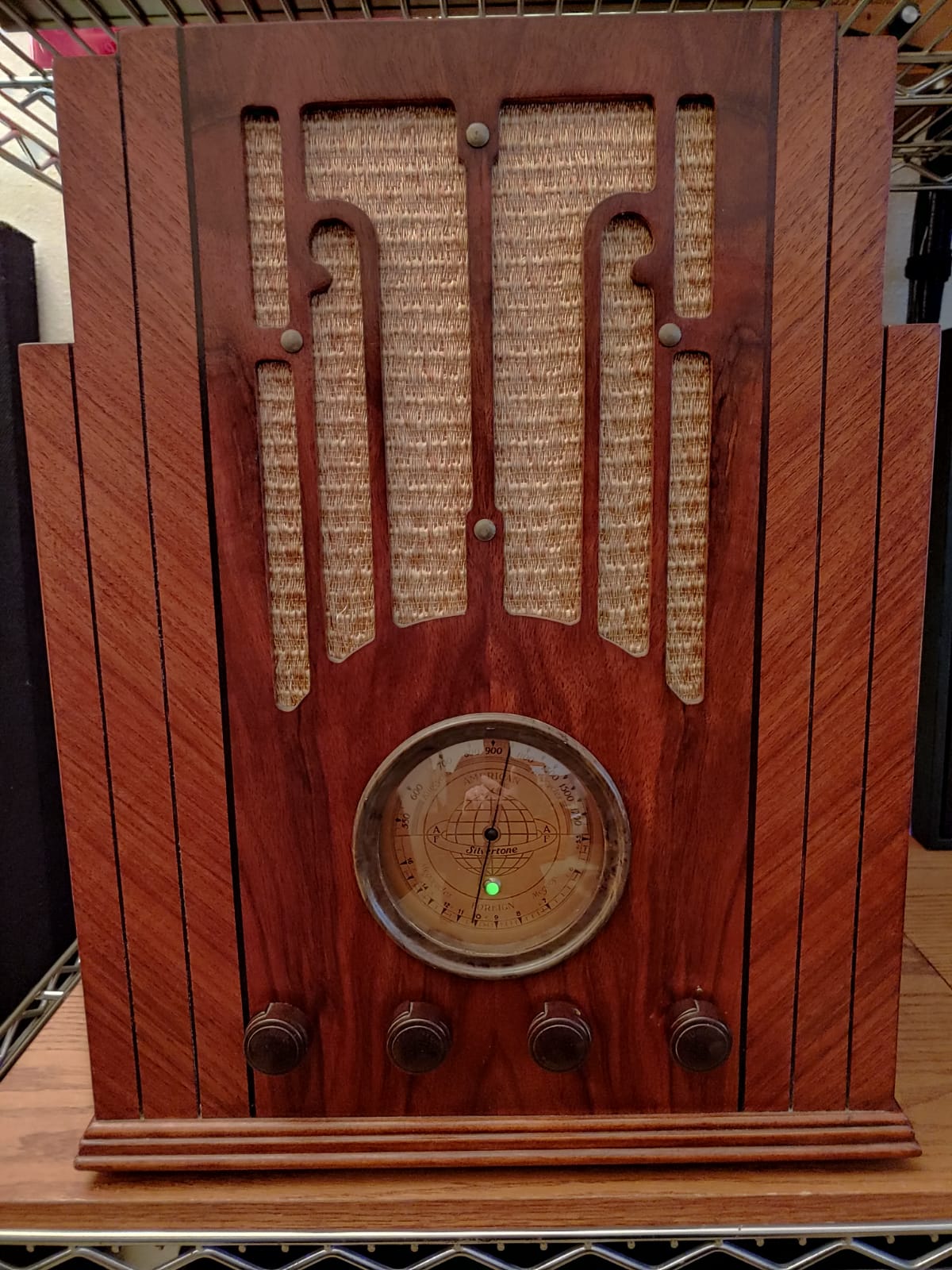

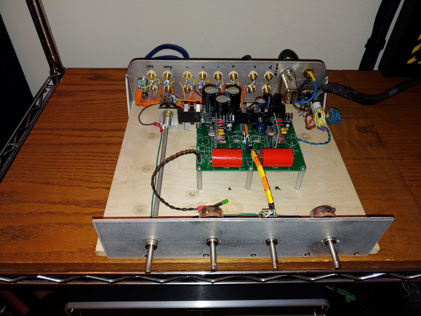

I ripped out the guts of the tube preamp chassis that I made to go in an old radio enclosure and re-purposed it for the AKSA, Lender preamp.
I made it with @ 6db gain as it is only feeding an external BSS processor, which is the crossover for my speakers. I think the gain is perfect.
I have only been listening to it for the last few hours, so expectation bias is inevitable. That being said, I really am thrilled with it. Unless I am fooling myself, it has given my system that nuance of holographic realism that had been missing since transitioning from the VTA SP-14 preamp and AKSA Maya-200 amplifier to my current system.

Fitero,
Really cool, unique look for your AKSA Lender preamp!!
It’s a fantastic preamp and very versatile, ENJOY 🙂

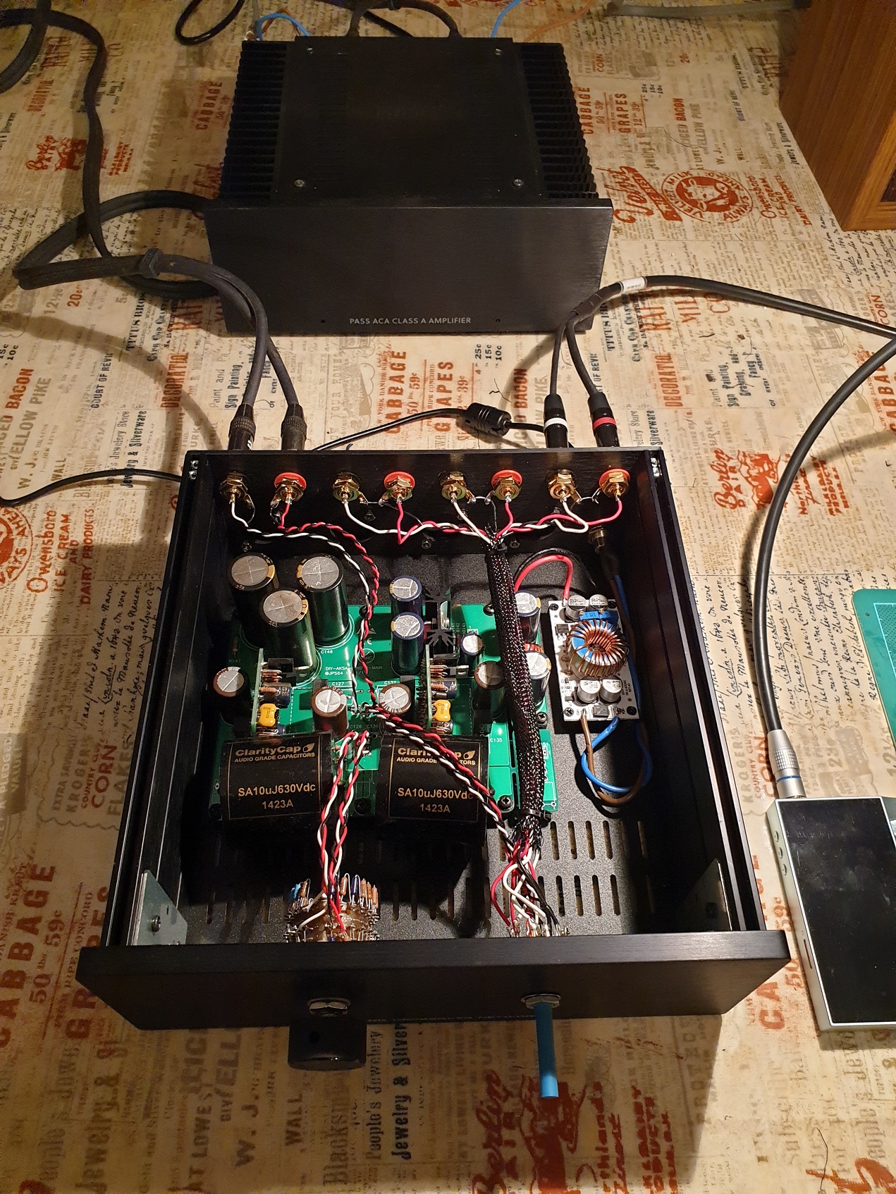

If the sound happens only on high crescendos then it sounds like your ACA is clipping. You can tell if you connect a more powerful amplifier and crackling goes away. ACA is limited to 5w rms for 19v supply. 5w is 18vpp. Tweeters often draw high voltage transients on crescendos.
Hi.
Finally pulled out my old Musical Fidelity P150. Connected it and turned it on. The output was huge, had to turn it off and bring the volume way down! The ACA was at around 80% on the volume and crackling and the P150 is around 25%, louder and no crackling.
The sound from the MF definitely isn't sounding as good as the ACA but it is an old ancient amp. Shows that the ACA is way too low in output in our system.
So now have to decide what to build - the extra ACA, the MoFo or something else.
Now knowing that the ACA is way too low, would either of them have enough power for our system? The MF150 is 150w

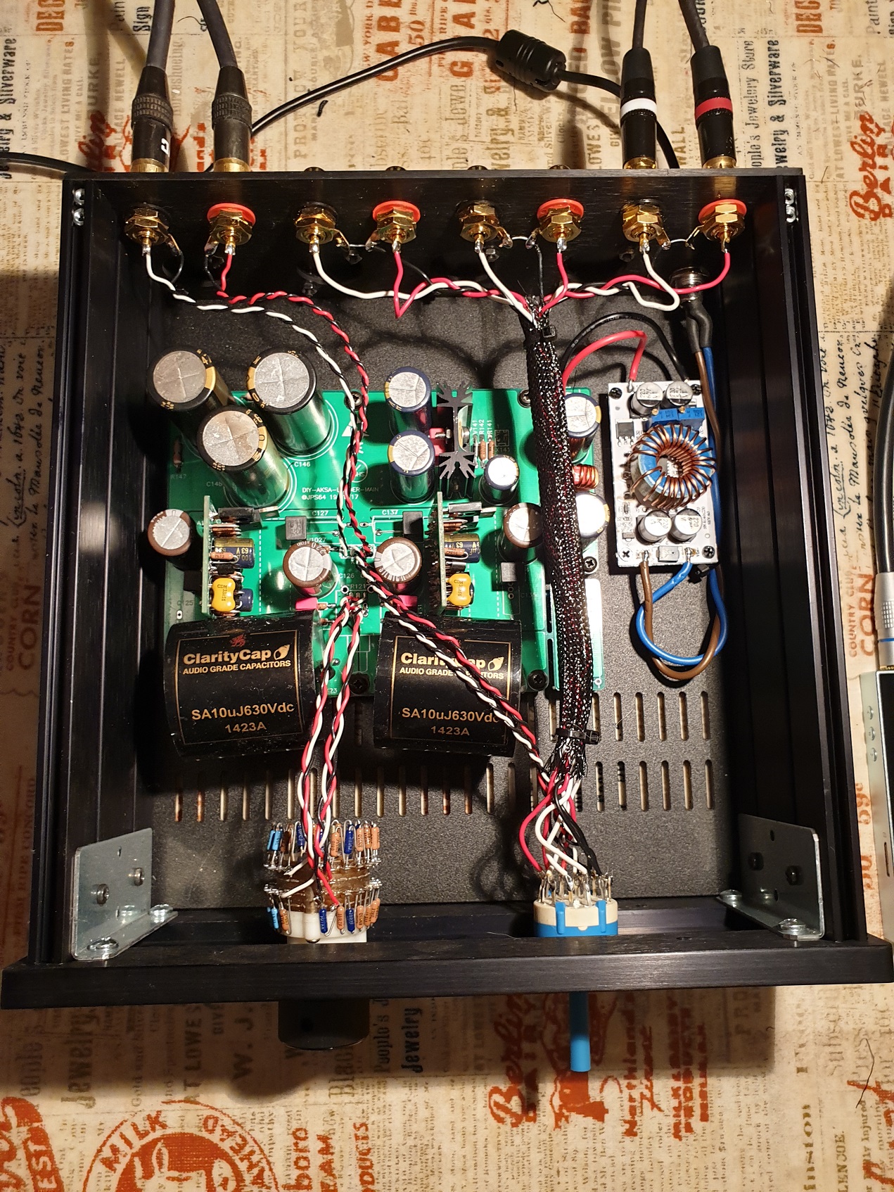

I've finally got the Aksa in to a chassis. It's not the tidiest of wiring but I've learnt from the mistakes made along the way. It's getting a bit of burn-in through some ancient music centre speakers that I keep for such occasions. I'm very much looking forward to tomorrow when it gets connected to the main system!
Looks good SuppersReady!
Have ordered the similar black chassis for my Lender. Matches with the ACA. Mine will have a power switch on the front like I have on the current ACA face, and the volume and input switch.
