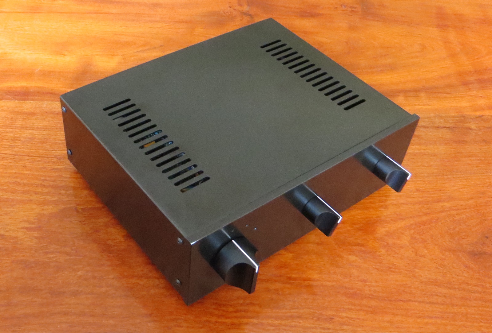

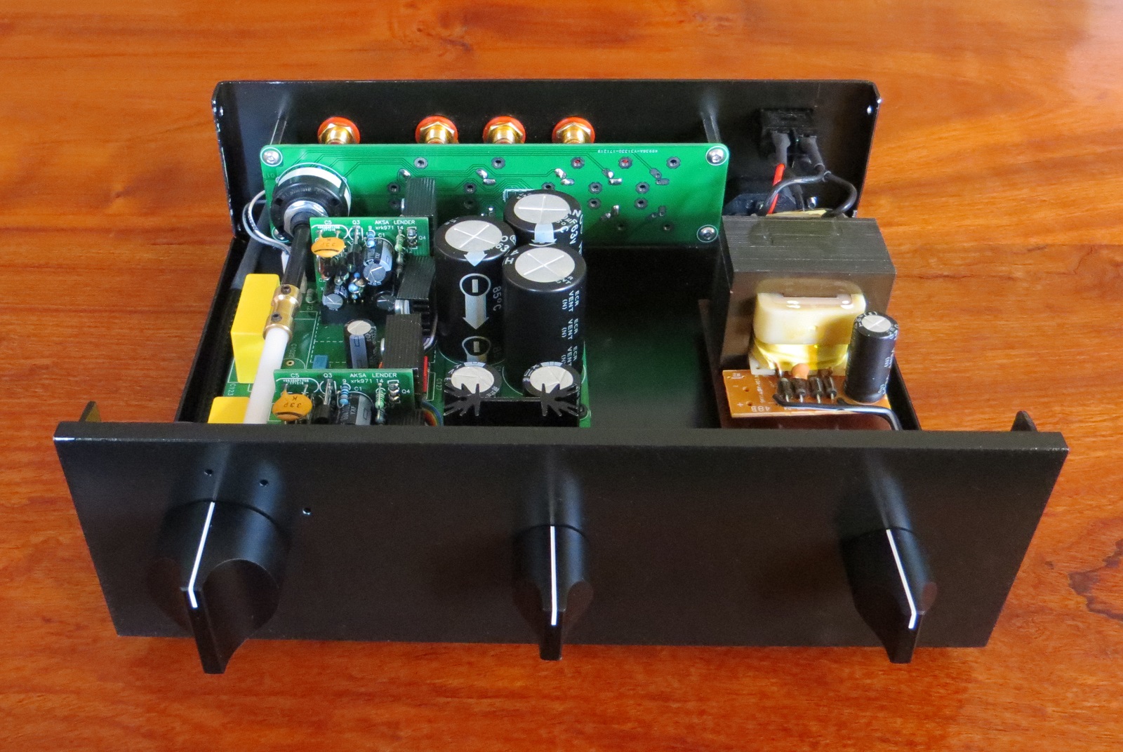

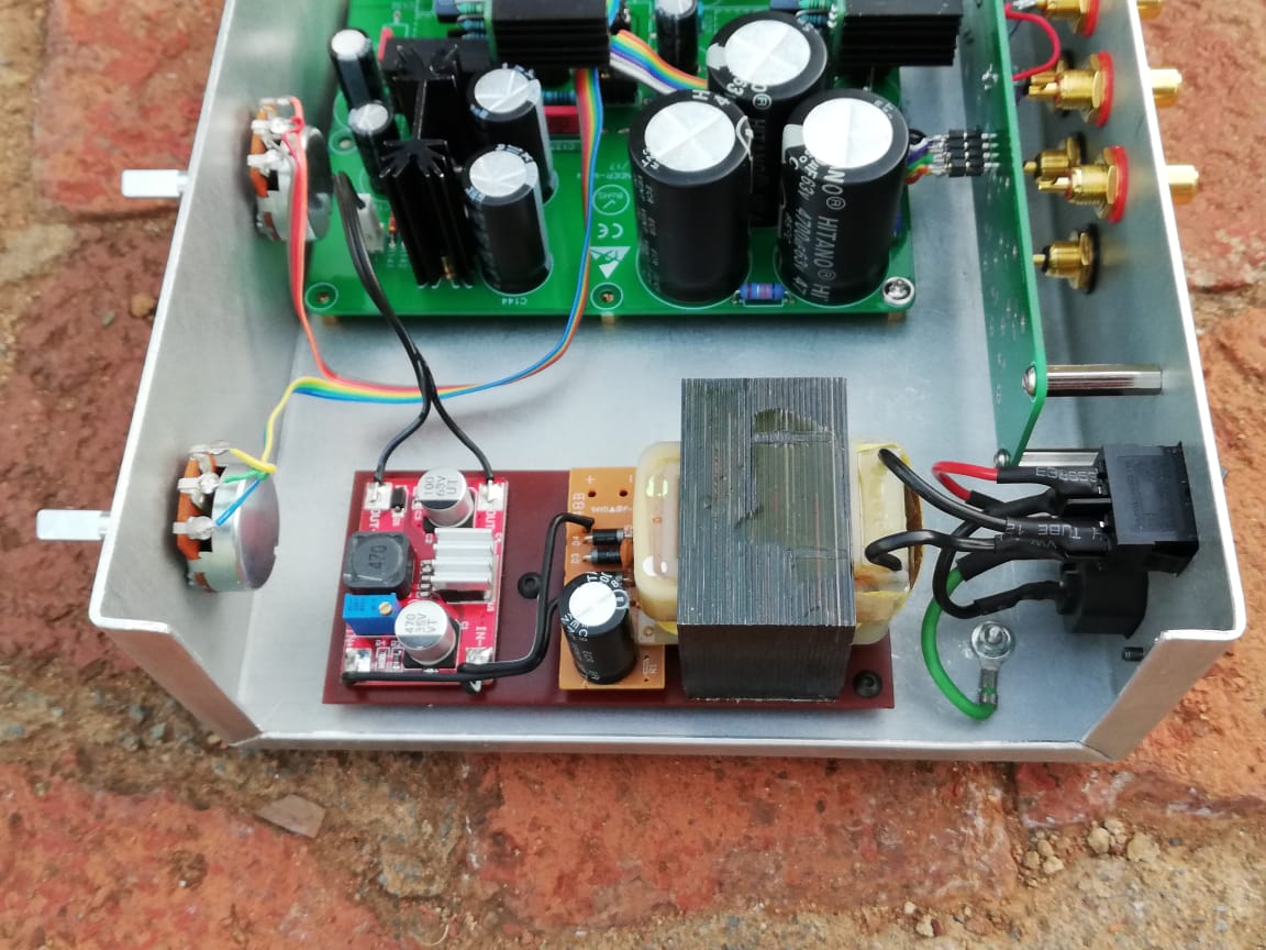

Finally assembled my AKSA Lender preamp after the chassis parts came back from the engineering shop. Had some cooling slots laser cut in the lid and all chassis parts eCoated. The latter is not as durable or aesthetically pleasing as anodizing, but it's a lot cheaper. Also swapped the Taiwanese carbon pots out for Bourns Cermet pots.
I'm relieved that the cooling slots made all the difference that I hoped for. Even without any openings in the bottom panel, the chassis is now cool - maybe 5 deg Celsius above ambient. It was like 50 deg C before the slots.

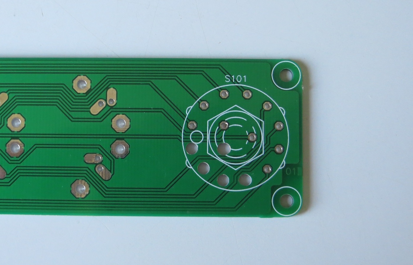

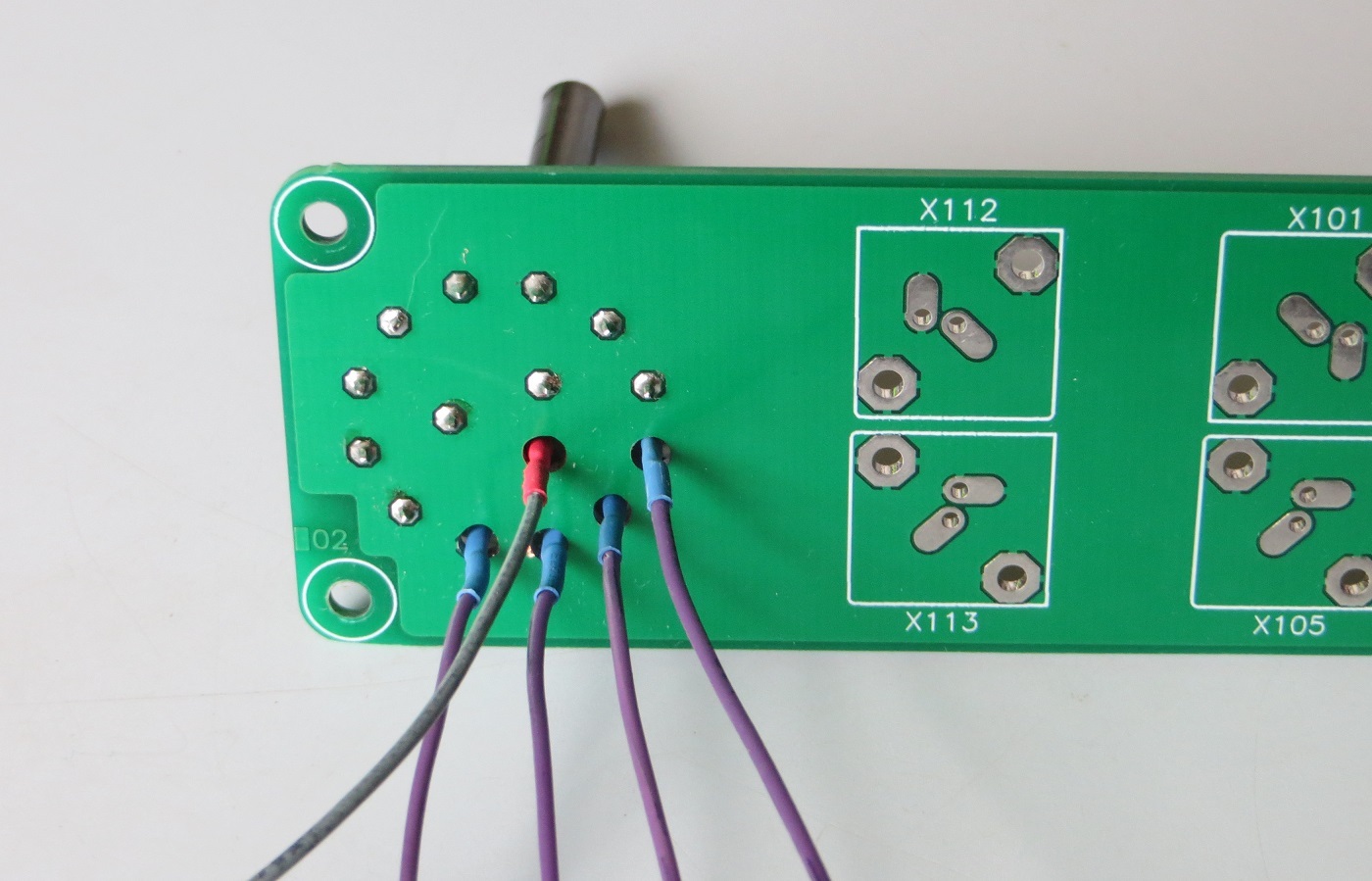

I decided to modify the input selector board (acquired a spare from a friend) and used the unused set of contacts to switch LED's on the front panel to indicate the input selected.
PS. The chassis before eCoating can be seen in post #863

Good implementation. I prefer 1mm steel black paint coated too. Cheaper and better RF/EMI attenuation. And the small EI transformer seems far enough away.
By the way, can you tell us more about Bourns Cermet pots?
The chassis I used is made from 2mm alu, so not as good as steel in the RF department. But I had the bottom half of the chassis already - and it had the ideal footprint for this preamp. There is no audible hum pickup from the transformer, but I haven't measured it.
It was Hugh's FAQ's that originally put me onto the Cermet pots (search the page for "cermet"). I meant to use this model pot from RS, but it was out of stock and then I got a slightly different version - with plastic shaft, but still Bourns.
Beautiful work, Skylar!
Can you explain what you did to the rear panel to get the LED outputs? You are using unused positions as LED contacts?
Yes, I implemented the unused pole of the Lorlin switch for the LED's. There are 3 poles and only two are used for the two channels. I drilled out the pin holes in the PCB and soldered wires to it before soldering the switch onto the PCB.
In the pic below, one can clearly see that the drilled holes don't have any traces going to them.
Maybe a new revision of the switch selector board can take those pins to a connector, in case others want to add LED's too?

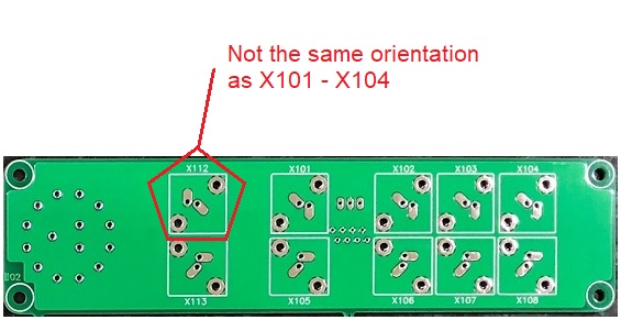

Request:
If there is ever going to be a revision of the boards, can X112 please be rotated 180 degrees?
It took me a day to figure out why one channel was low volume and playing on both speakers. I had soldered the wires leading to the RCA sockets the same as for the other sockets, not realizing X112 is different. :blush:
Regarding X112, that’s news to me as I never used this selector board. I think JPS64 used one on his but did not mention it. So the polarity of the pins were switched?
Yep. Positive out went to ground on my left channel. Took me hours to find the problem. It's of no consequence if one uses the 12HP059 RCA sockets in the BOM which directly mount onto the selector board. Since I could not source those RCA sockets, I used short wire leads between the board and panel mount sockets. Of course, positive went to ground because I didn't realize the orientation was different on the one output socket.
I'm not saying there is a mistake on the selector board. It's just a pitfall for the unwary builder who uses panel mount RCA sockets.

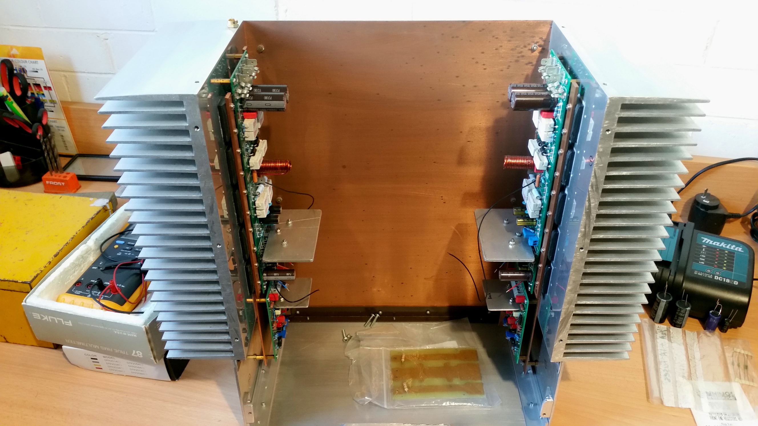

Attached, is my chassis solution for the Slewmaster amp using copper sheet and thick aluminium.However it’s taking forever to complete.
