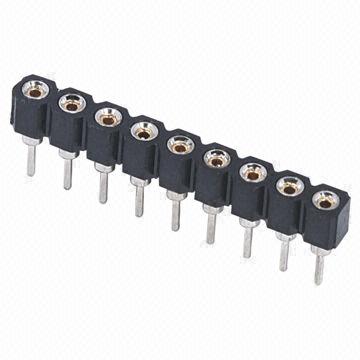

I would also advise to use socket connectors on the motherboard for R121 (the pot) for easier connecting to your panel mounted DACT volume switch.
Thanks!
Is there a best socket and plug connector for that R121?

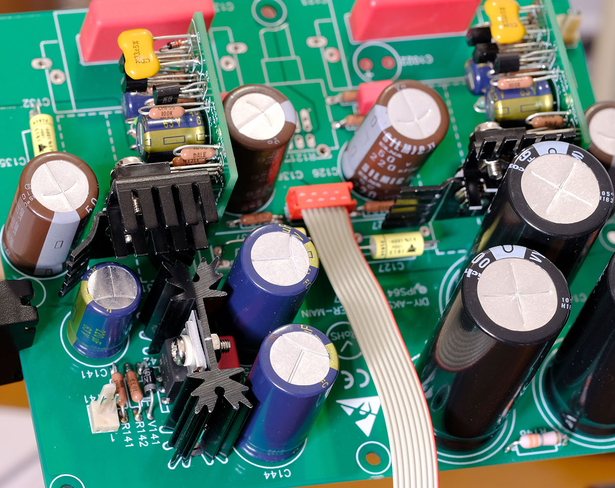

Added some heatsinks to the transistors.
Main board: R141 to 10k
THT: R10 33k, and R11 6k8.
Couldn't get the Vishay Metal film resistors, so found some other Metal film resistors, not as accurate as the Vishay's.
Still waiting for the DACT SMD attenuator.

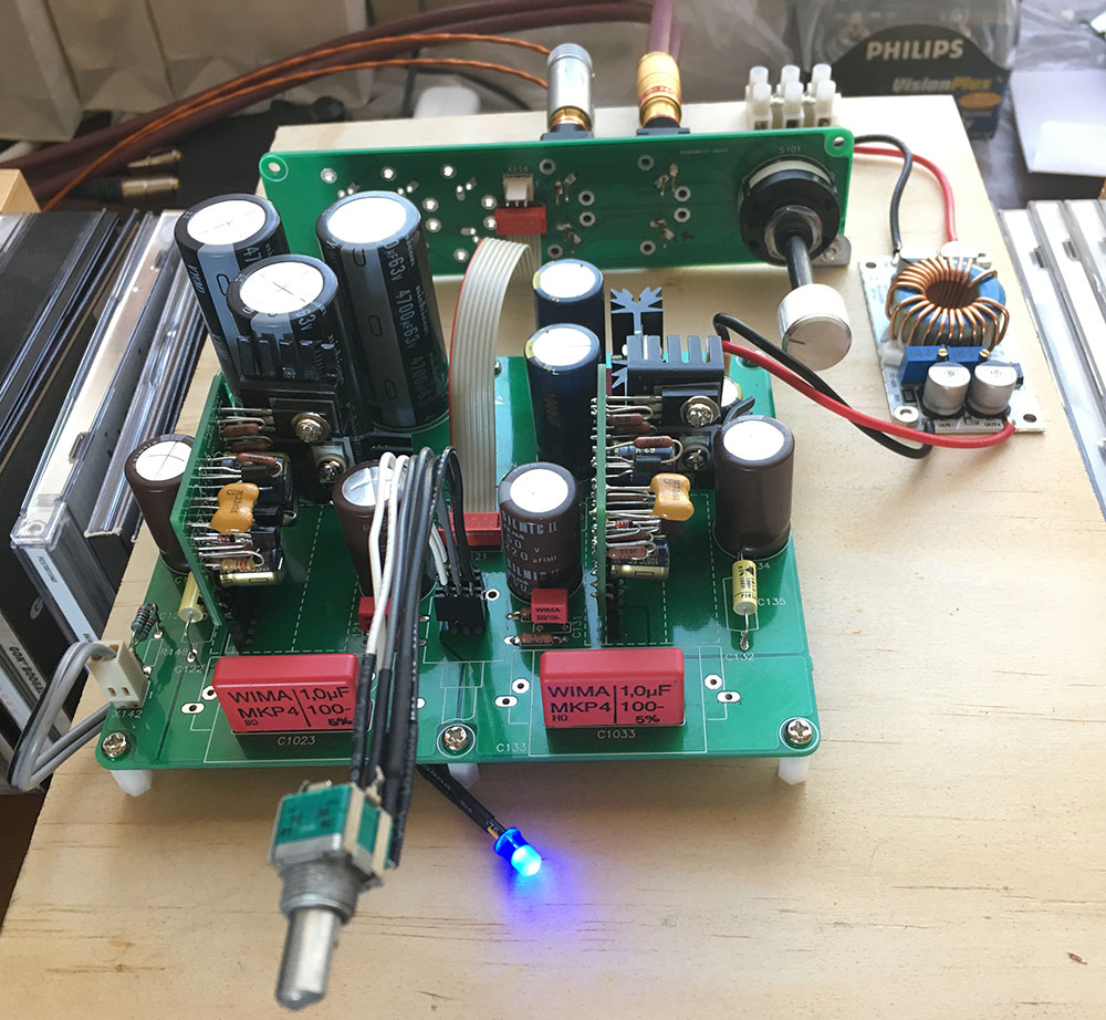

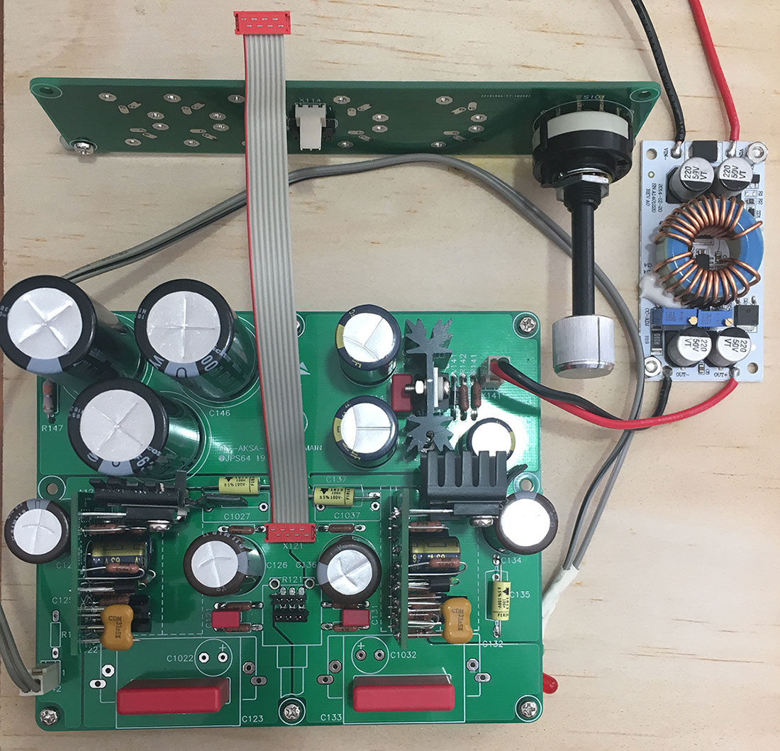

Done a bit more today.
Attached the AKSA to a timber board, attached the power board, found a previous LED cable, just need to know what resistor is needed for it. Put some PCB headers for the DACT attenuator (it's not here yet)
Just need to sort the power cable to the HP laptop power system, attach some RCA sockets and attach the DACT when it arrives and will see if it works!
For LED, 15k works well. Basically 45v and 15k gives 3mA which is not too blinding bright. 20k could work if you like a little but dimmer intensity.
It depends on the wavelength or color of the LED.
I've used 15k on the board plus an extra 56k in series (on the LED lead) to get a blue LED dim enough for night-time use. PSU is set to 48V.

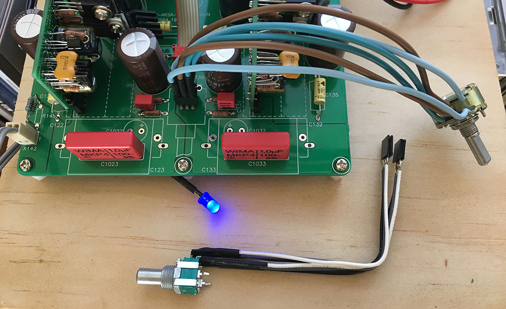

Have and set a Mouser potentiometer 10KOhms 688-RK09L12D0A1W, connected it today.
The pre-amp only works on the right side. Can feel the right side of the THT is warm on the heatsinks, and the the left side is cold.
How do I test where the left side is not connecting or some other mistake.
The sound on the right side sounds good, but if I turn the potentiometer up to the normal volume on my old Musical Fidelity Preamp 3A it crackles in the speaker.
ok, now it is working, and sounds way better compared to my old 1990 Musical Fidelity Preamp 3A

It looks like your Wima MKP4 caps are only 1uF.
In order not to loose low frequency information, I’d start by replacing those with a value closer to 10uF.
Looks like you’ve got a nice build there 🙂
ENJOY!!

maf_au,
Very nice build there. Your parts are pretty good quality with all Vishay resistors and looks like Panasonic electrolytics. With the 10uF Mundorf input you are pretty much approaching the best it’s going to get. If you want, try changing the feedback resistor for a carbon film - that might make it sound a bit smoother. Other than that, you have a great Preamp. A lot for the great sound comes from the design and topology and the layout by JPS64. Just changing parts on your other preamp will probably not bring you similar levels of sound quality improvement as just using the Aksa Lender even with inexpensive non premium parts.
