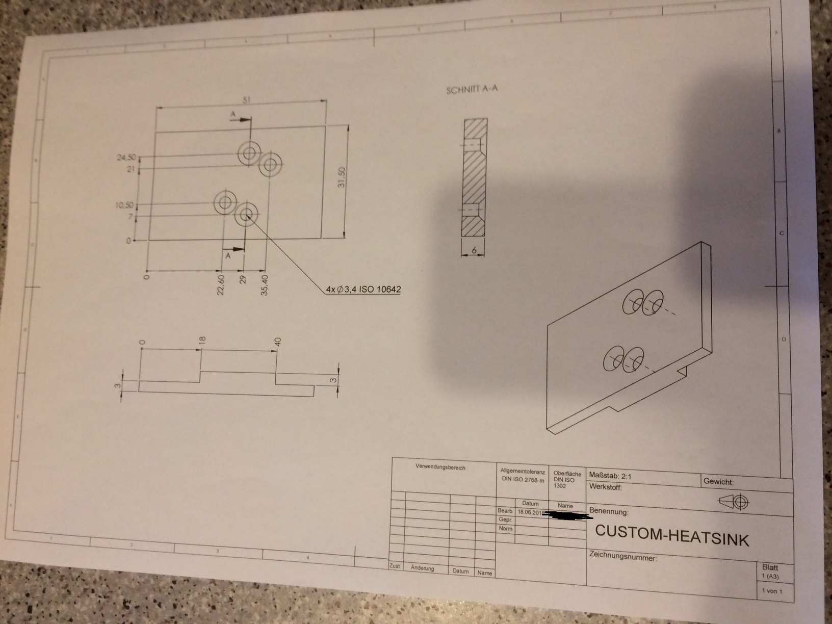

I´ll publish all the plan and if demand I´ll offer the custom heatsink in GB.
But today, I´m still waiting for the mechanical part.

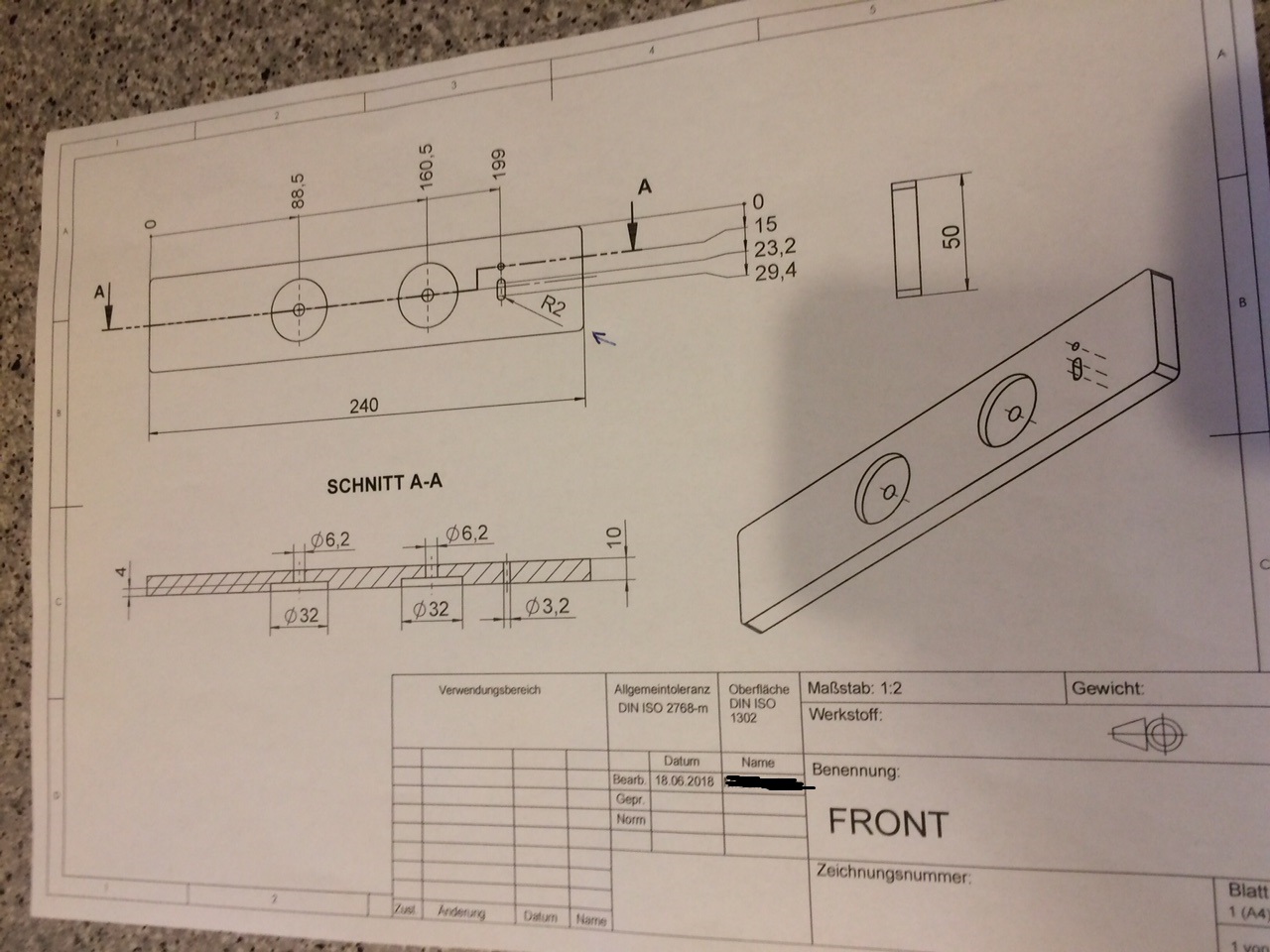

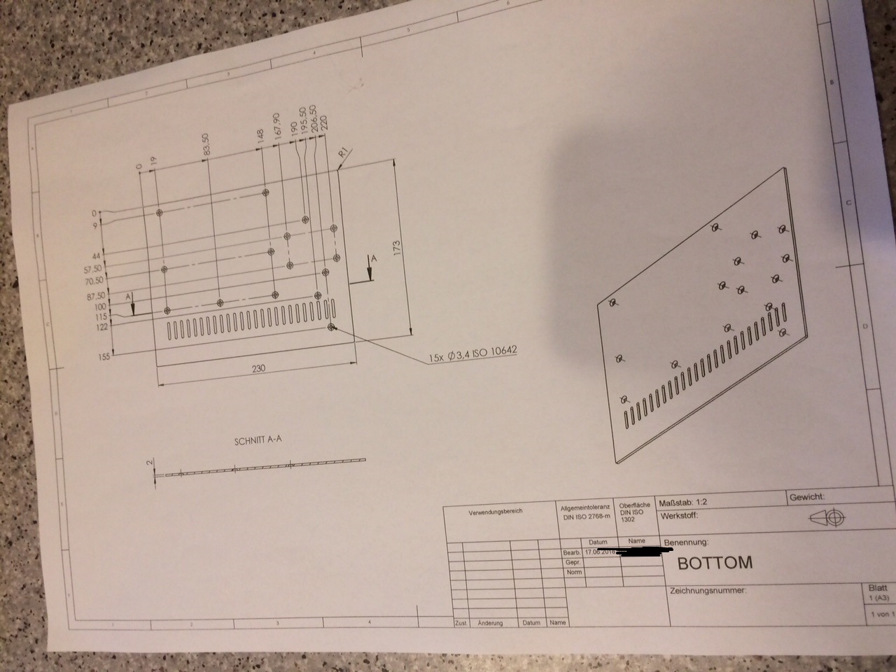

PS.: raw sheet of aluminium arrives tomorrow (enough for 3 heatsink pair); mechanical milling and drilling this weekend!
