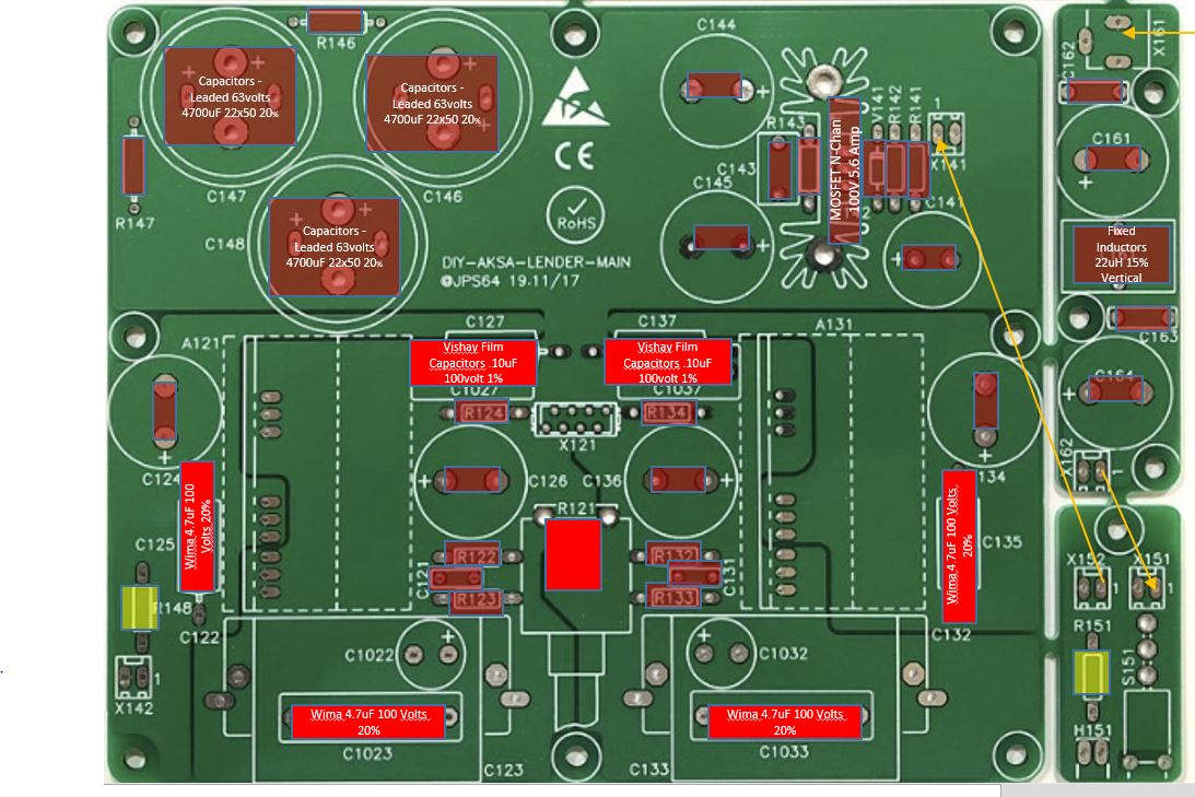

I have spent a couple more hours today refining and double checking the BOM for the Main board. Thank you for offering help, tow cents! I am still posting here because I believe this information is helpful for any beginner out there. If the forum guys think otherwise I'd be happy to take this to private messages instead.
From what I gathered from you guys' last two posts I put together this new BOM Mouser Electronics I'm trying to keep this one clean and public for the next beginner because really, this hasn't been fun. lol
Everything is pretty straight forward for me so far, except the capacitors at the output stage. Please see the picture below where I named everything that I am not 100% sure about or that has changed from the official BOM. Will this work fine?
Questions:
1- The yellow resistors are defined as depends on V+ in the original BOM. How do I calculate them? I planning to use a white boost converter like this, unless stirred a different direction: http://www.diyaudio.com/forums/analog-line-level/314563-aksas-lender-preamp-40vpp-output-32.html#post5260733
2- That's just thinking a head, I out the yellow lines as I understand there is where G and +V are connected, is this correct? What is the connector X 142 for?

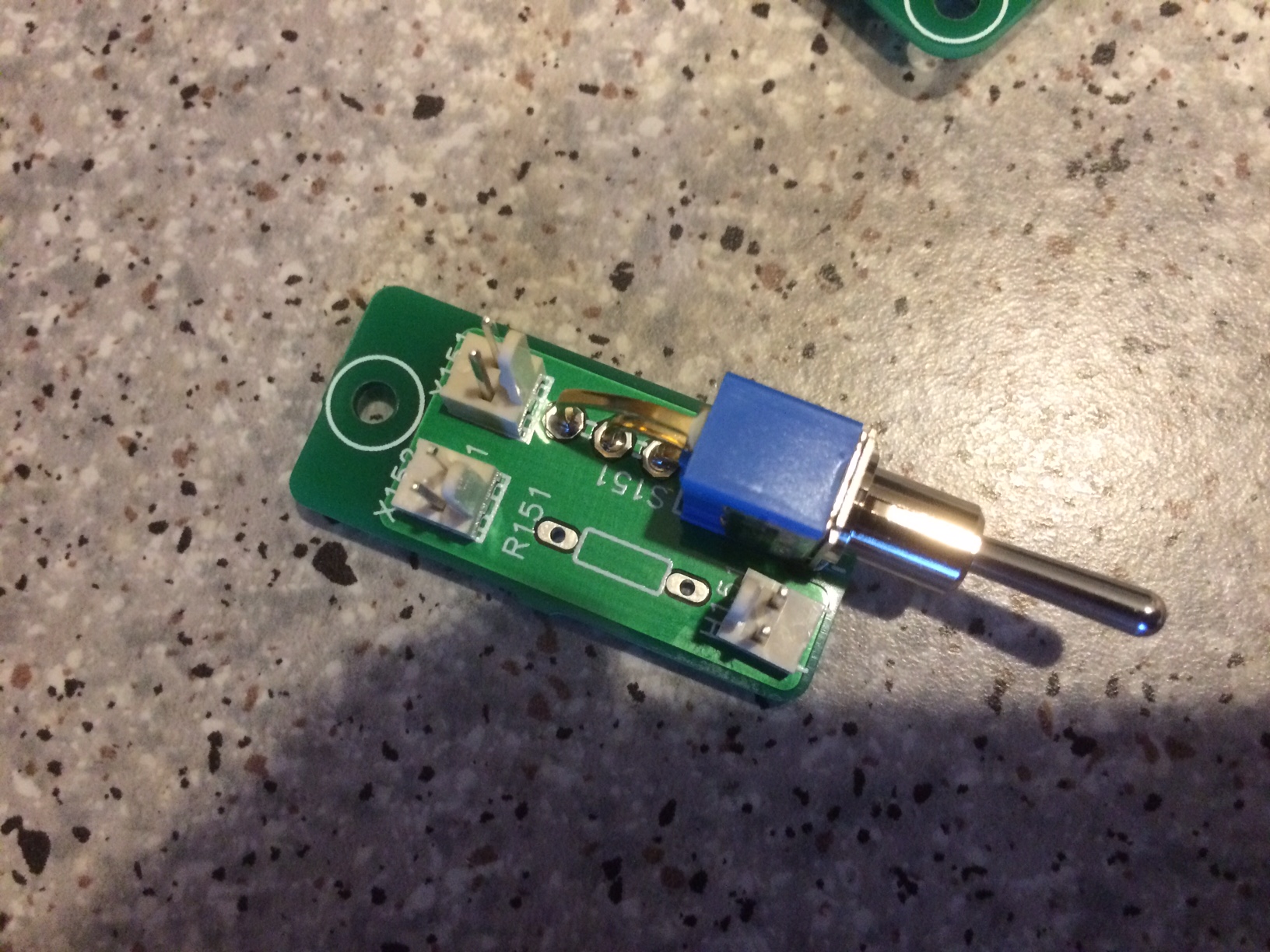

GASCo. Your posts HAVE been helpful. Like you I am new. My boards are on their way. I have already gotten the boost converter, HP SMPS and other components, such as caps etc... I was working through the option part of the BOM and schematic over the last day or two, so a timely post! Hopefully will help others decide to try this pre. Thanks also must go to the knowledgeable diyers taking the time to reply (and of course X, AKSA and JPS for making it happen in the first place)
You could use X142 with R148 for LED left side.
You could use R151 with H151 (not cheap!) on right side, or wired standard LED using jst connector instead.
JP
JP
I'm a relative noob as well but spent some time studying before I built my AKSA Lender Pre. To save a few more bucks I omitted the switch board and the CLC board (the two smaller boards on the right). The CLC board isn't really needed unless you have especially dirty power in your house. As X has said previously (paraphrasing here), an SMPS together with the built in regulated supply on the main board will already give you VERY clean power.
Also, I think your values for C125 and C135 need to be .1uF, not 4.7uF. Keep referencing the schematic when choosing your components. And triple check before you place your order. I don't know how many times I thought I had everything right only to realize after I was about to start soldering that I ordered the wrong cap or resistor.

Aw got it now. I was lost for the schematic I just downloaded and had I had it before I'd be able to had answered myself. As those resistors are just for the LED I know how to size them.
Thanks! I will update accordingly, and now that I found the schematic (dumb me) I will follow your tips.

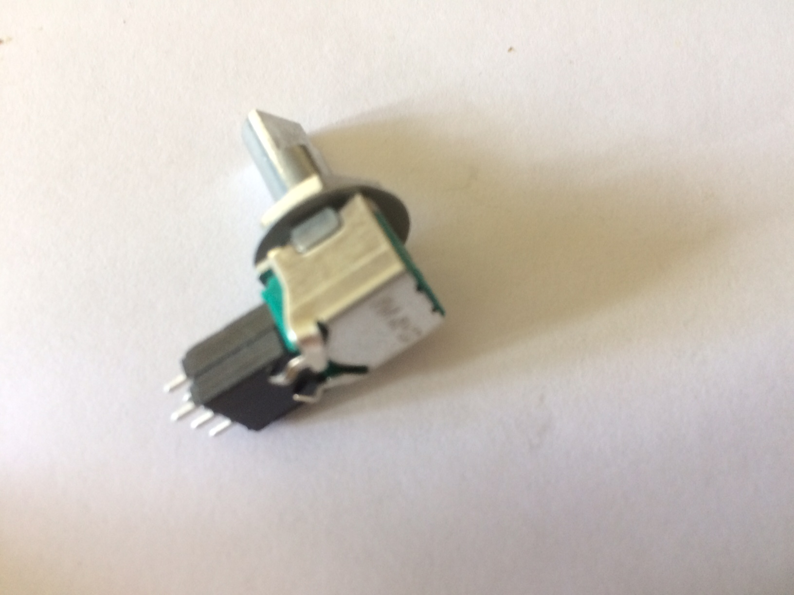

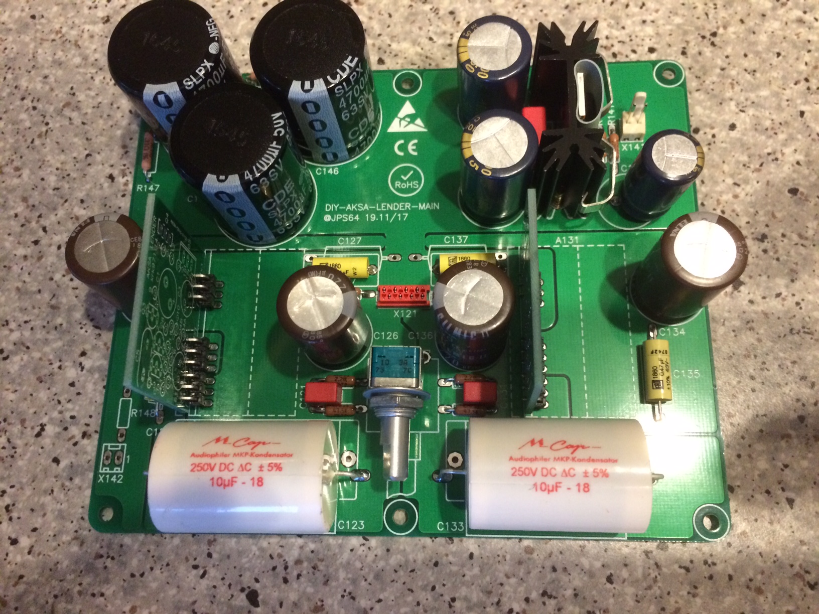

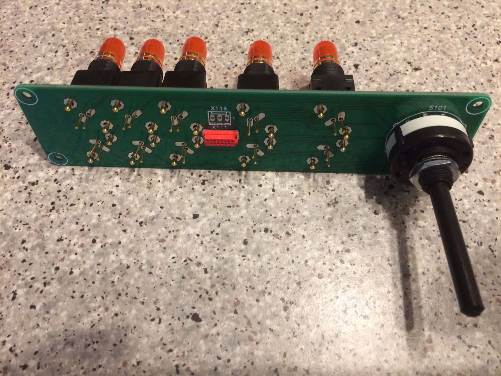

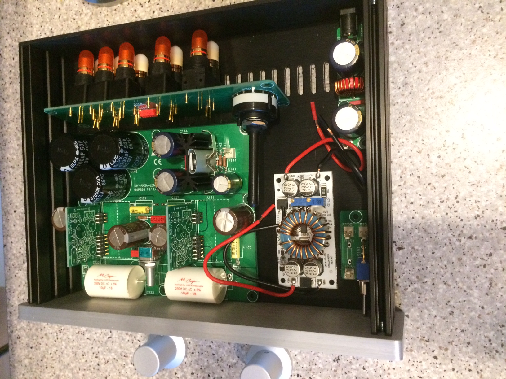

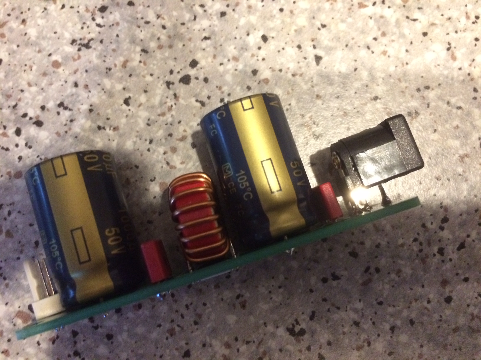

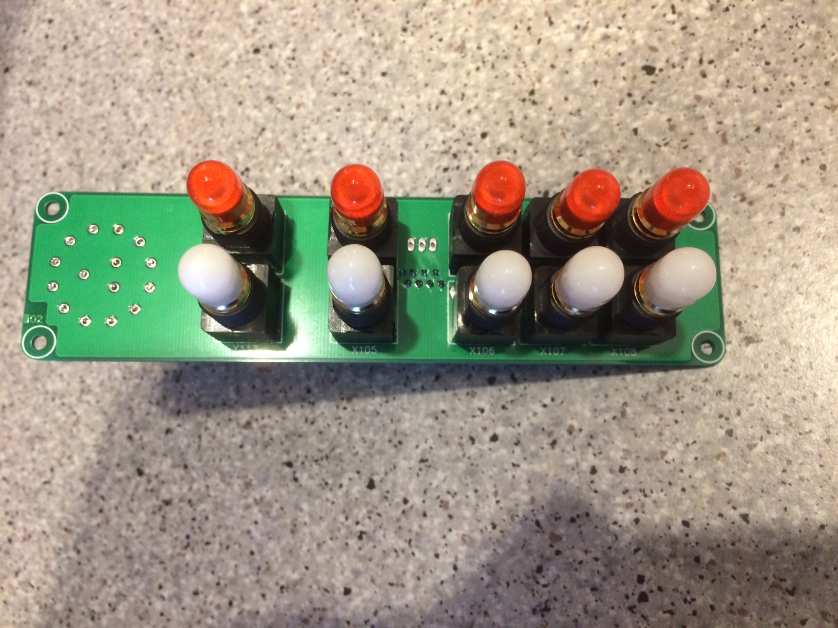

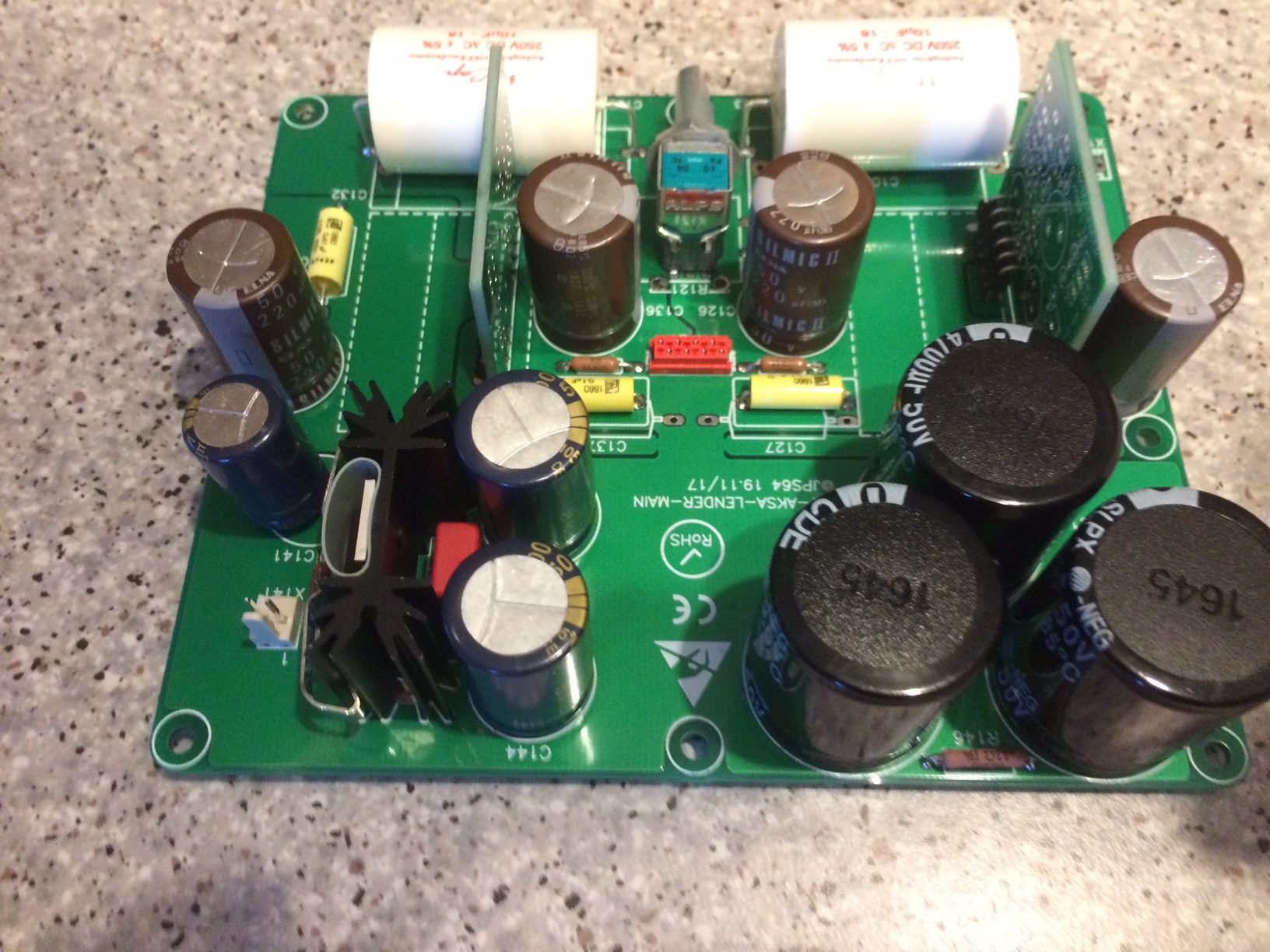

Still waiting for mechanical parts but here some fotos.
ALPS RK09 on socket to bringt it on same line as source switch.
RCA soldered with rear panel.
JP
JP
