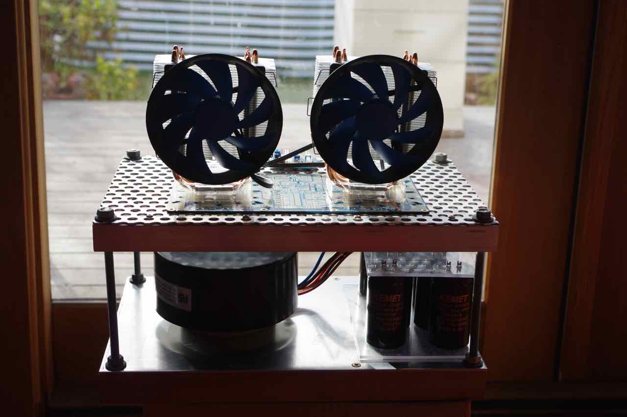

I wish the cpu coolers didn't have the ends of the heat pipes exposed. Maybe I could make a cap to clean up the look a bit...
I could make a Delrin or PTFE cap, remnant pieces of both are inexpensive on eBay.
So many ideas, hahah
Hi Gab, all of them don't have exposed end pipes, like be quiet! Dark Rock Pro 4 that looks nice..but it seems that it comes with a price tag.
Maybe better idea is to fabricate something yourself 🙂

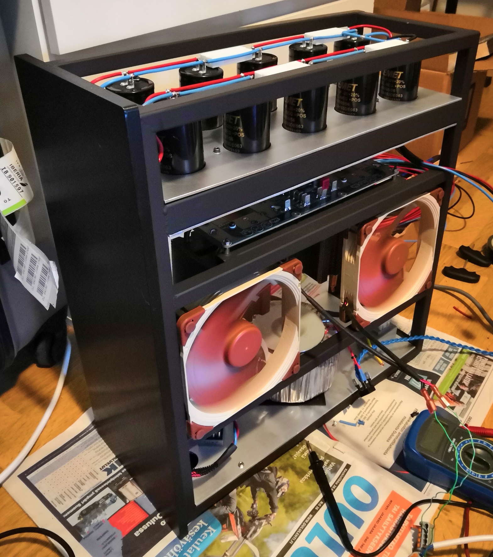

Just wanted to note that Juntuin got his Alpha BB monoblocks to make music! He says it is absolutely noise free on 97dB sensitive speakers. Beautiful custom welded steel frame (nice to have a pro-welder for a GF!).

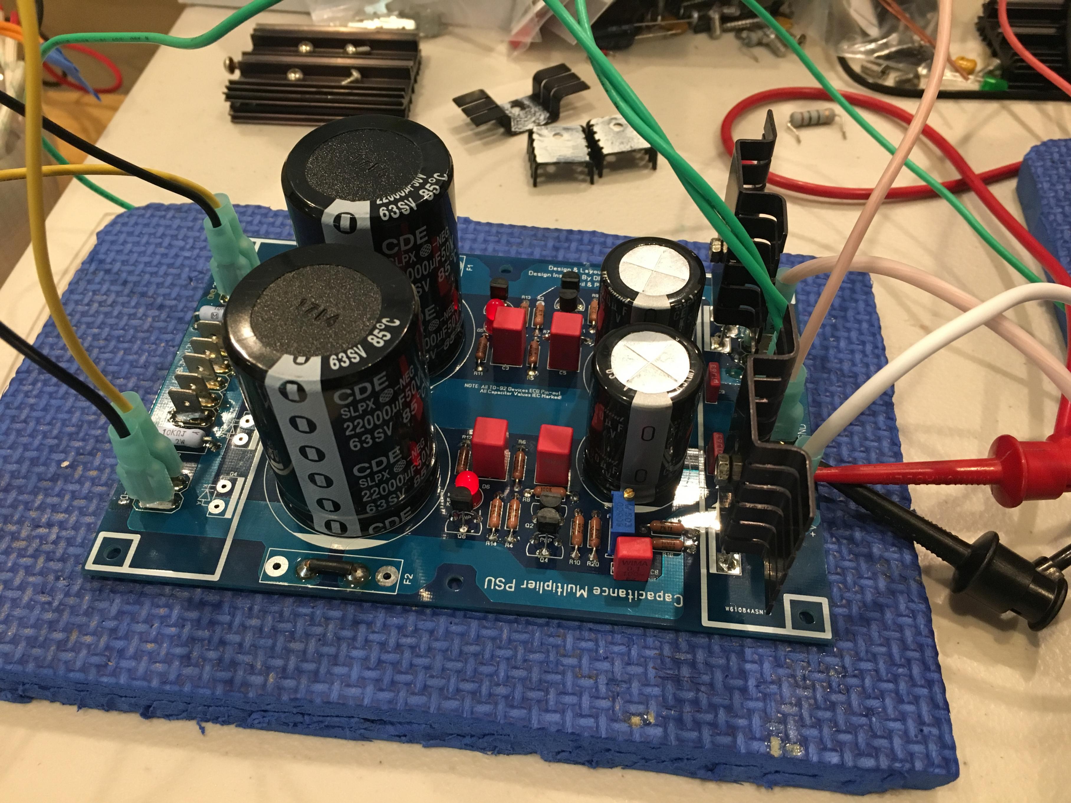

More news is that the Mr Evil cap Mx board by jkeuterman works really well as Vunce found out:
It only has a 1.5v drop so doesn't get too hot.

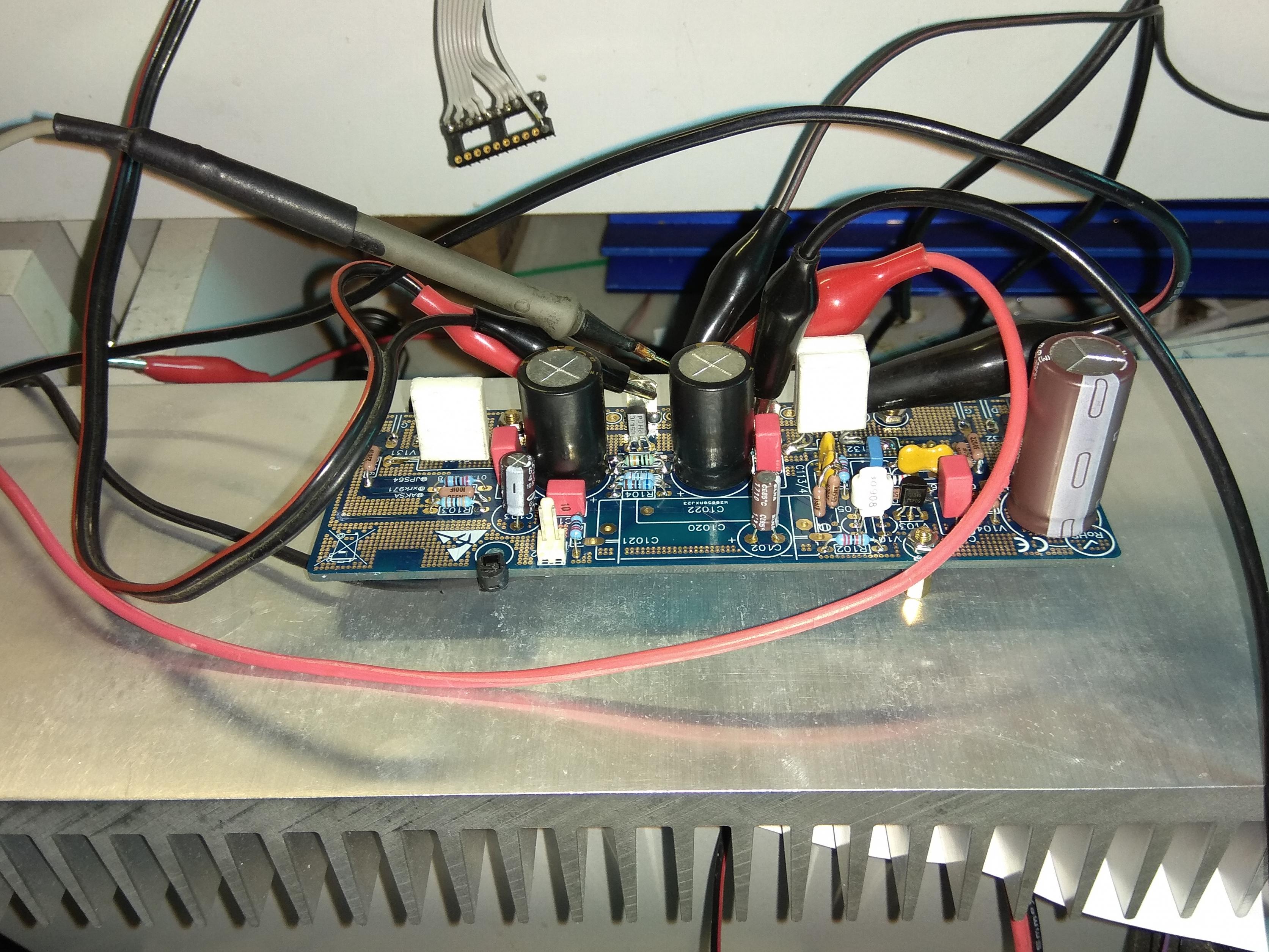

Here is jwarch's Alpha 20 up and running and sounding great:

I am building one channel of Alpha 20W and I powered up the amp after the build.
First up - dc offset is around -60mV. I have only R105 pot. I am assuming adjusting this would adjust the offset? The offset dropped to around -50mV as the heatsink started gaining temperature but one of the output transistor was not attached to heatsink properly and and was getting very hot. Hence I stopped the test. I have fixed the output transistor and hope it is making proper contact with heatsink now. Before testing again, I wanted to check with you if I am right in assuming the pot adjusts DC offset.
Secondly, at start up, the DC offset shoots to high value before settling close to zero DC offset which was reported by other builders as well. I am guessing without the delay circuit, it is not possible to avoid this. If you can come up with some circuit which would work with amplifier DC supply itself (rather than another board with different supply), it would be good solution. I am not sure you are planning something for this.

First, congrats on a successful build. The Alpha 20 is an easy amp to get working. Secondly, 50mV is not bad but it sort of depends on the whole chain of components all balancing out. I would suggest removing R105 and setting it to 1050ohms and replacing it (unless you did that already). Or replace it with a 1k+47R fixed resistors in series. If you do leave it in and adjust it, do not adjust it too far from 2mA current through R5. The LTP (actually long necked pair in this case) current should be about 2mA total. If one of your MOSFETs was not firmly attached, the Vgs will be off. Try again and if you are within 25mV that’s normal. It should be stable relatively with temp.
We have discussed the turn on thump. If you wish to avoid it, use a delay relay on output ($5 on eBay or Ali) or use a cap Mx with say a 3 second slow ramp up voltage.
Good luck!

Thanks for the response. I gave it a try again after fitting transistors properly. The DC offset is still at -50mV and fluctuates anywhere from -60mV to -45mV.
I connected to speakers and heard it is playing fine. After 15 minutes of playing, the heatsinks are moderately warm. I feel the heat is more compared to earlier amplifier playing there (Hiraga 30W) but need to check it for longer duration. May be I need to add a fan to the place where this amplifier will reside since there is no air circulation at all. It may get very hot there.
Next step is to get the delay circuit, get the fans for cooling and then let it burn before judging the sound. Initial impression seems like warm sound but it's too early to judge.
