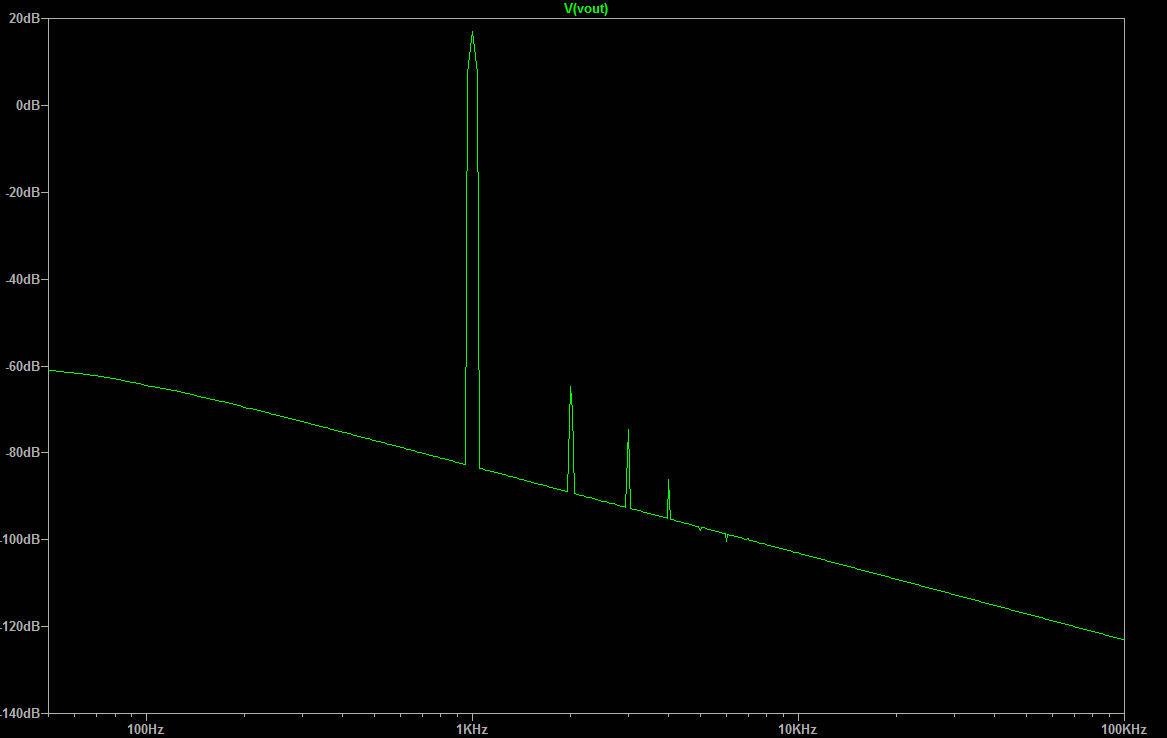

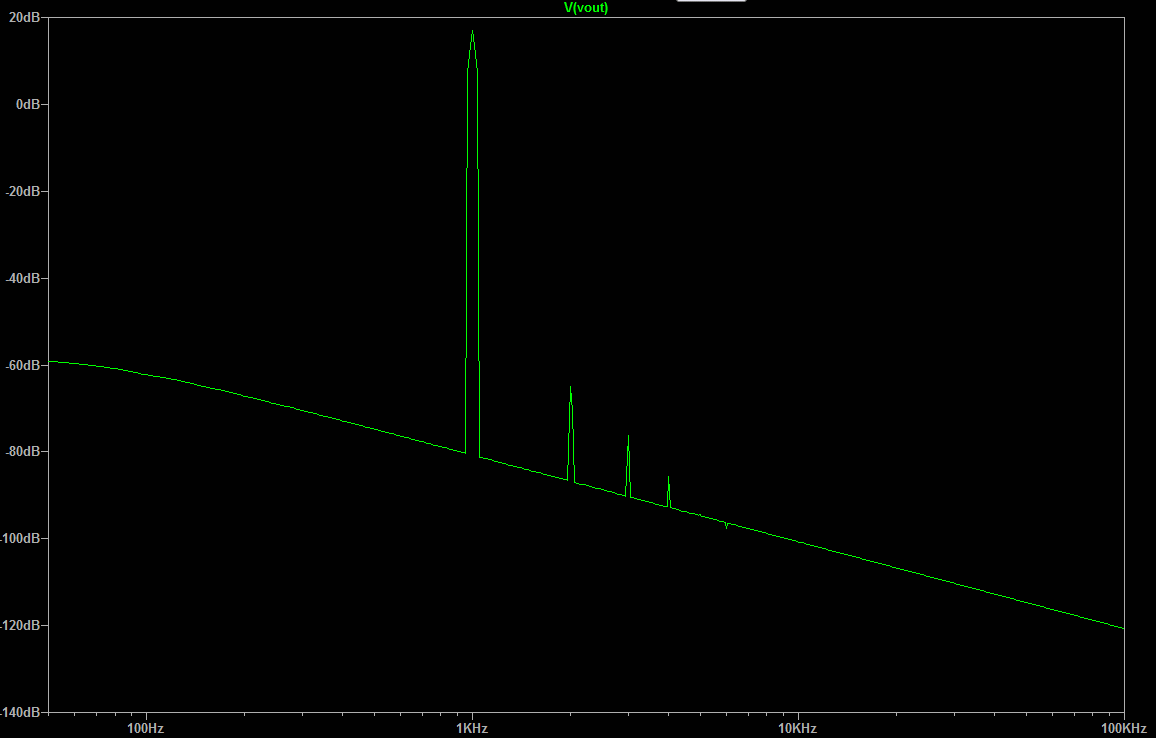

I have amended the figures to reflect 12.5W into 4R load (1.7Vpk input and 20Vpk output) and give more insight to the profile of the harmonics.
As mentioned, with loading this amplifier tends to make more H3, but even at 12.5W H3 is -88dB lower than H2 -80dB and a very good H5 output of -111dB. I believe the 8R version will sound better but this low loading for ribbon speakers should sound very good too.
The difference in FFT between the 8R and 4R version is minimal, less then 2db H3, very well done Hugh !
Here are both FFTs:

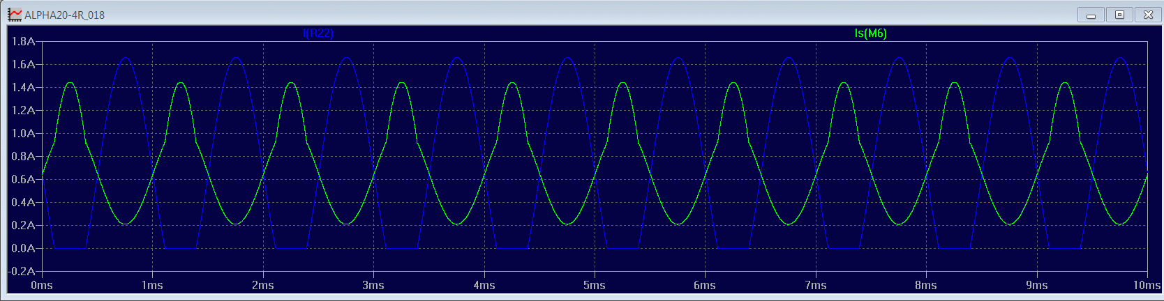

Hello,
I've now been simulating the different options of biasing the output stage and trying to minimize it a little without augmenting distortion.
So that I can use it with my 4U (hifi2000) heatsinks.
I already changed the ccs fb resistor to 750r (see previous post),
now I changed the sensor resistor of the ccs from 0.12 to 0.18 and the source resistor to 0.33 (1/3).
Strangely enough this gave me lower distortion than 0.12 with 0.81/3
with 20vpk I have now:
H2 at -86.7db
H3 at -94.3db
I'm not complaining :)
Hugh, I've changed your simulation with these values:
  • ALPHA20-4R_018.asc

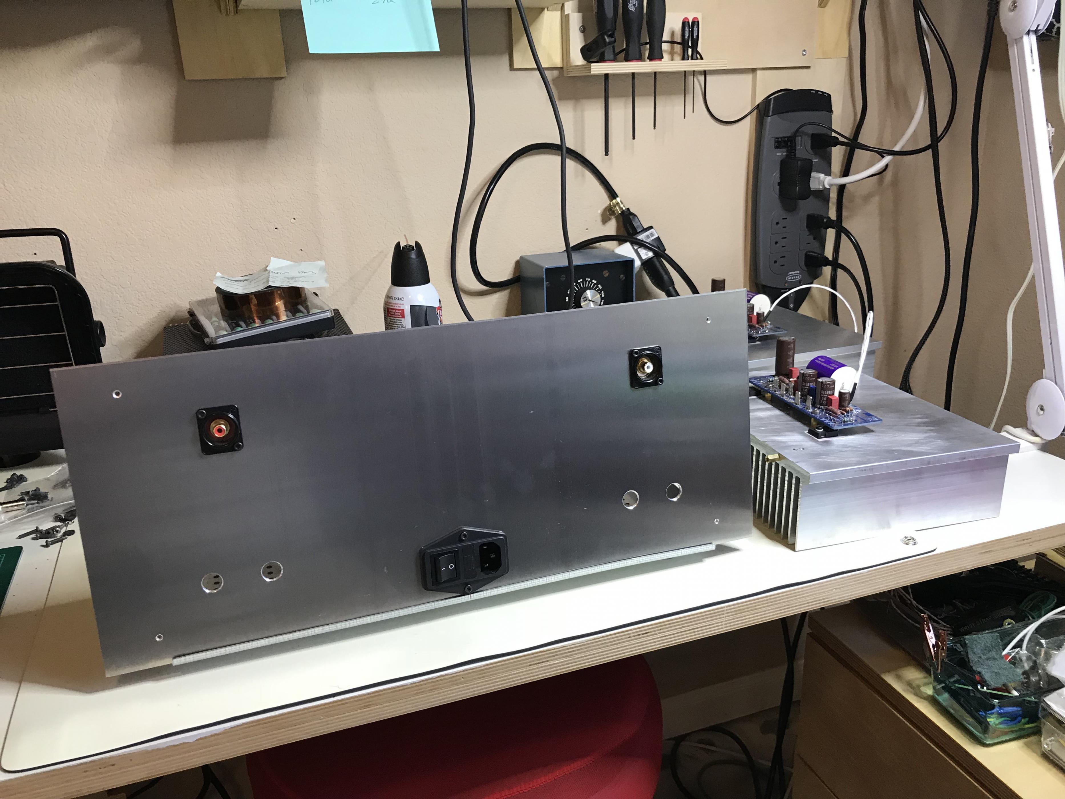

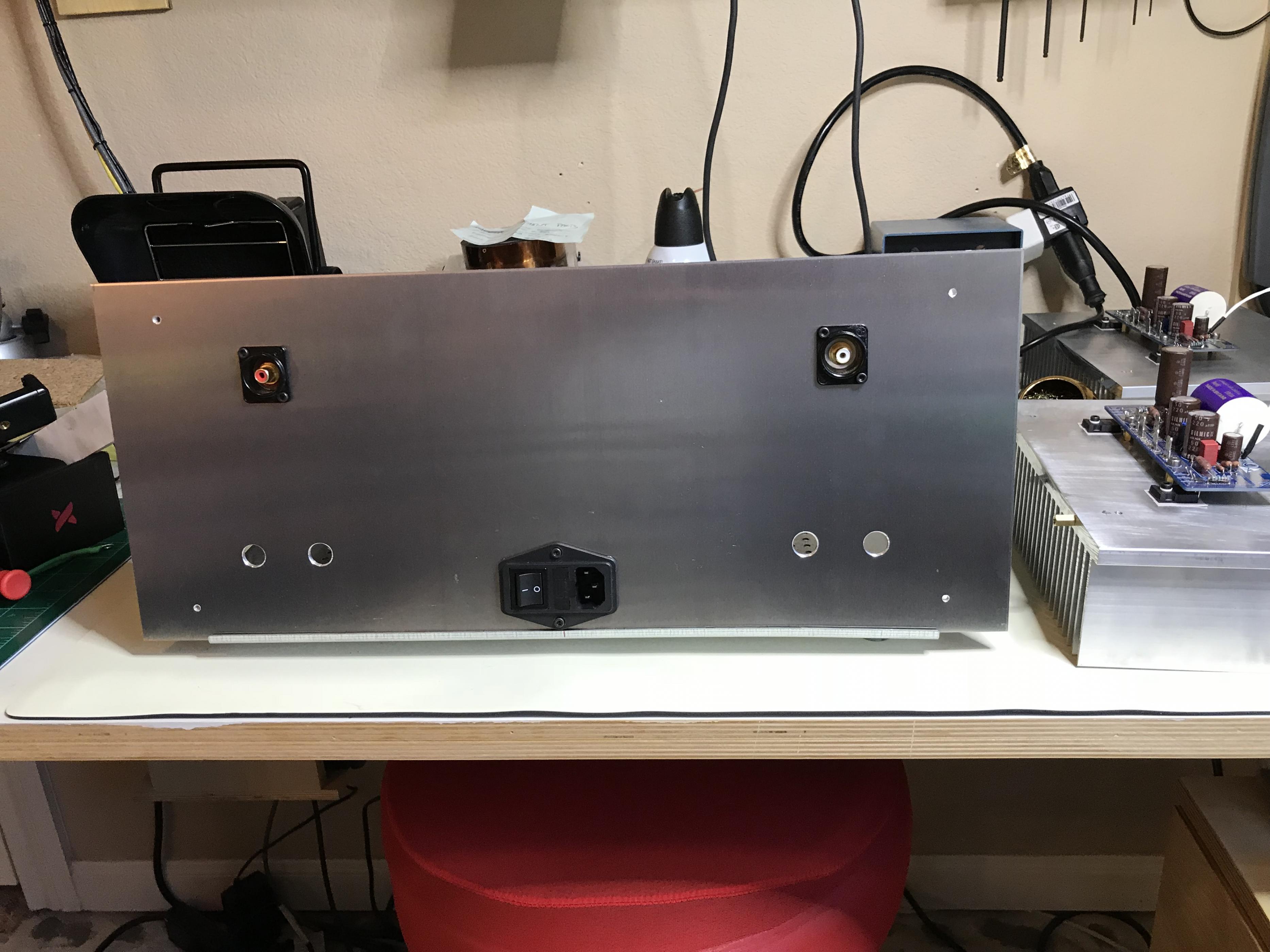

Got most of the rear panel done on the permanent case for my 20w Alpha. Working on heatsink mounting/support as they're pretty heavy.
I will likely sand then put a satin clear coat on the rear panel to keep finger prints, etc. at bay.

I would urge you to leave the original settings; 0.12R for the AC CCS sense, 0.81R triples (giving a combined 0.27R current sense for a single IXYS 480W device) and 865R AC CCS sense resistor.
Attached is a simulation of what happens with your settings (0.18R, 1R triplet, 750R) at 35Vpp output into 4R. There is high distortion, too and THD is over 1% at high power because one of the outputs turns off. You can see the current curves of the two outputs, they are not equal in range, and the bottom device turns off completely. It will be OK at 32Vpp output, but we need to correct each device current flow so they have identical range from low to high current with neither device turning off, like my second attachment.
As you increase the current source from 0.81 to 1R and beyond you reduce the limit of current from the upper device near clip. You need the highest figure you can attain to maximum power output, and higher resistors here also bring down the clip level.
By increasing the CCS sense current from 0.12R you increase the output impedance, reducing the damping factor with 4R speakers. This is critical for 4R. You are also throwing signal away with a higher value; 0.12R is about as low as you can do it.
Finally, the CCS base driver resistor, 865R, is CRITICAL on this amp. It sets the dynamic current variation of the output devices so that they go up and down AND down and up IDENTICALLY. The current dynamic of each output device should be equal; as one goes from 80mA up to 1.6A the other device must come down from 1.6A to 80mA - a perfect 'see-saw' match. Only this delivers maximum power to the load at the highest efficiency and with neither output device turning off at any stage. This is very important and is the hallmark of Nelson's brilliant design. I cannot stress how clever this circuit block is to audio amplifiers; it doubles the efficiency of a single ended amplifier whilst delivering inexpensive push pull topology, yet delivering a wonderful sound quality by ensuring now output device ever turns off.

Yep, the rear plate is ~3mm aluminum. Not sure what I'll use for the front, might get a ~6mm sheet of black Delrin for the front panel...
Allow me a little advice. Aluminum walls that are at least 4mm or a 1mm steel sheet (black painted) or a mixture of the two.
To protect 100% of external RF/EMI interference. Verified by myself. I have "tons" of RF/EMI in the air.
