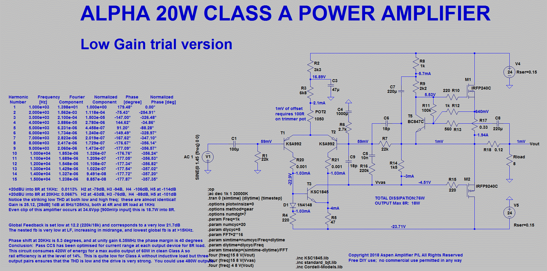

Lower gain version ?
Hello,
The Alpha20 has plenty of gain, too much for my system with 2v sources and 93db speakers,
and to throw that gain away in an attenuator is not that good.

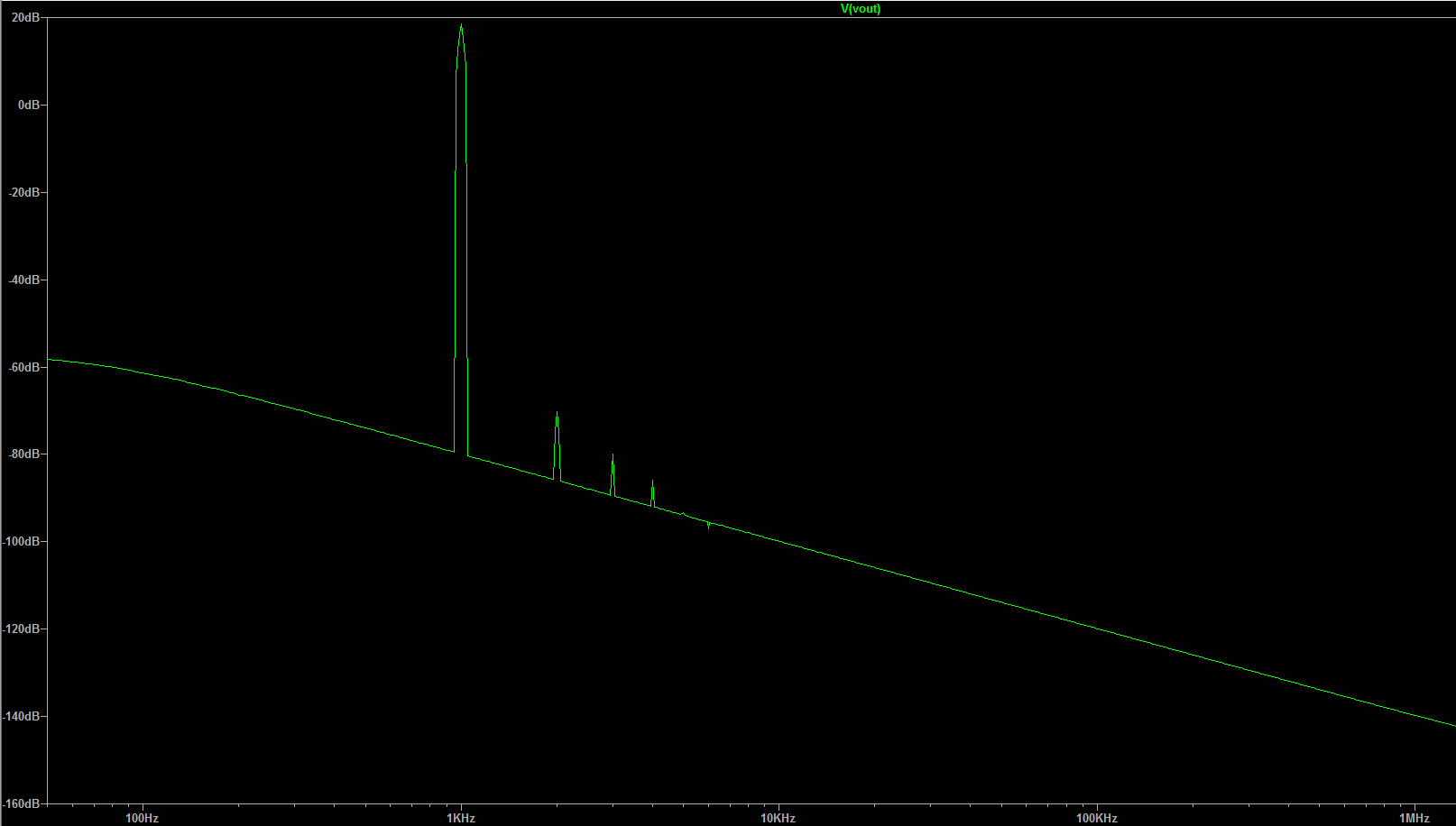

Thanks to Hugh for posting the ltpsice simulation files, I tried to simulate an Alpha20 version with less gain.
In the ltspice simulation files I named the resistors like in the first schematic of the first post.
To lower the gain I added more feedback.
R7 is the feedback resistor but this one can't be changed much, because otherwise the Vout DC offset is messed up.
Lucky there's also the R6 resistor that shunts some feedback to ground.
I've changed the R6 820R to 2k7, this lowers the gain a lot:
with 820r: 0.68 Vin gives 17 Vout
with 2k7: 2.05 Vin gives 17 Vout
But in the FFT H2 and H3 were on the same level with 2k7,
but with changing the R13 ccs fb resistor to 560 I got the same nice declining H2 H3 as the original Alpha20.
So R6 2k7 and R13 560r gives lower gain with the same declining H2 H3 in FFT.
I also tried 3k9 for R6, with 3k9 there was no need to change ccs fb R13,
the FFT looked great with R13 680r
Hugh, X,
Is this lower gain version OK or did I miss something ?
In the attachments you'll find:
ALPHA20-8R_KSA992.asc the original Alpha20
ALPHA20-8R_LG1_KSA992.asc the lower gain trial with 2k7
ALPHA20-8R_LG3_KSA992.asc the lower gain trial with 3k9 (matches the FirstWatt F5 gain)
In the ltspce files the dynamic current labels are resistor bound, the Vin is set for 12Vout
Danny
