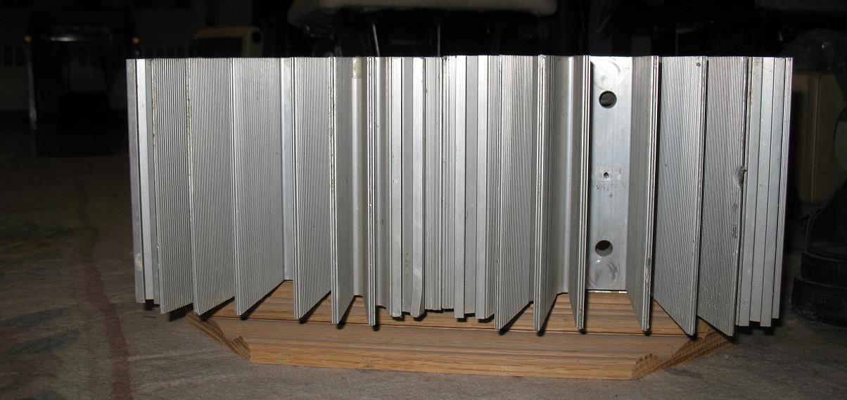

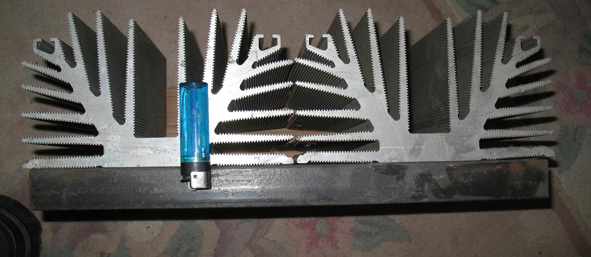

Hi, heatsink, well I tried various suggestions e.g. Checked heat was being distributed evenly by copper spreader, slightly cooler on the outer sinks but not by much. Tried removing sections and just using two with each mosfet connected to one each. Sinks became too hot to touch after a very short time. Using a Fan solved the problem, so I guess these sinks are just not suitable for use without a fan. I will look at other options. Using CPU coolers with fans seems to be a good solution, just wanted passive cooling really.

Heatsink not enough to be big & heavy, surface area and weight combination play a big factor to be a good cooler device.
Your heatsinks fins are not enough to compare to the whole heatsinks weights, the other problem when the two heatsink next to each other they create a thin tunnel between the fins with limited air movement between the fins.
If you put two piece 8X8Cm fans under the sinks with very low speed (no noize at all) that would do the job. In that case, you have to add some feet to elevate the heatsinks (to create some rooms under the heatsinks for the fans) Something like my picture.
