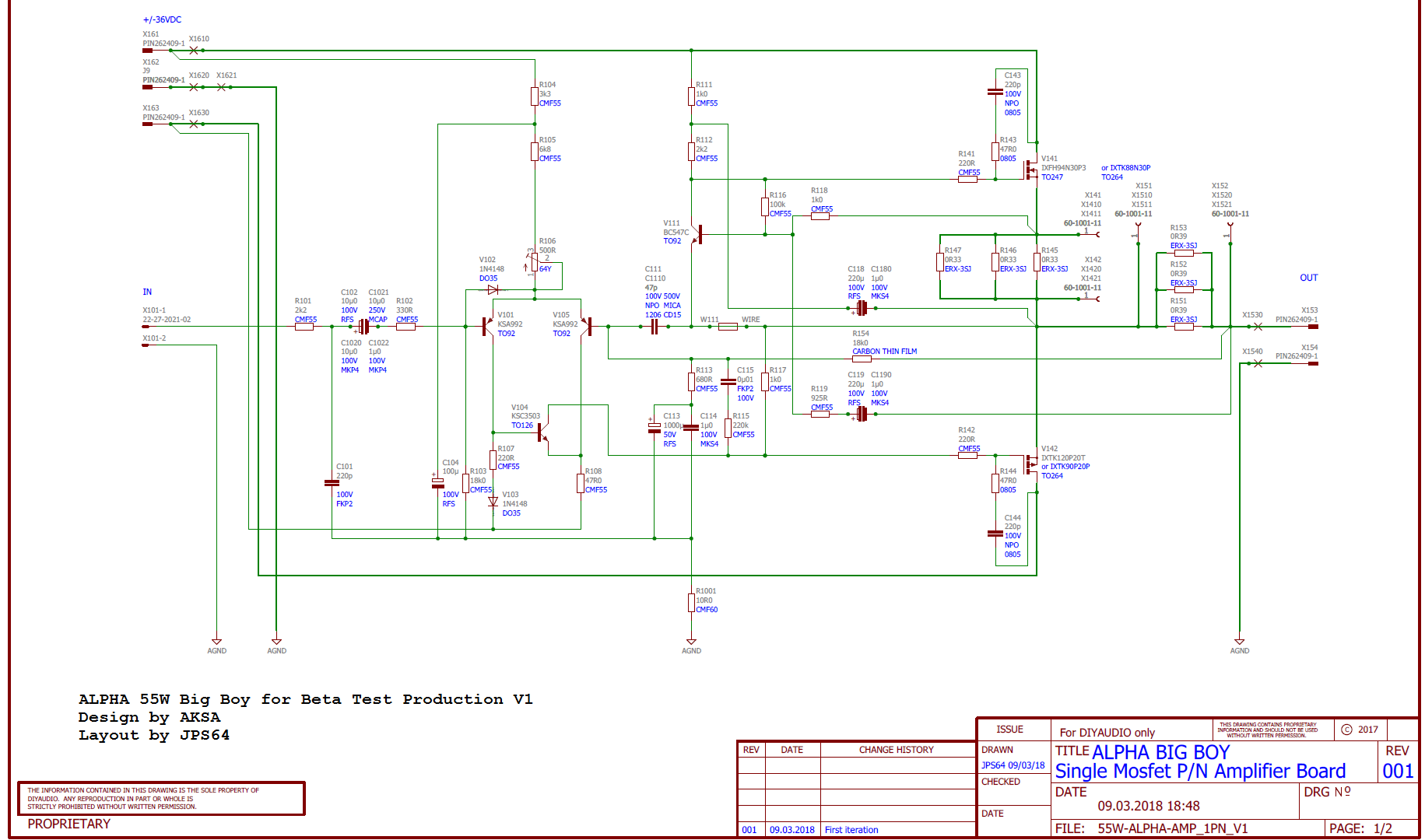

Hi Hugh, X,
A question about a small capacitor.
In the original Alpha20 schematic there's the C4 18p capacitor,
with the 22k fb resistor it makes a lowpass fb (<400khz) to Vvas (I think).
But in the BB and the 4R version that capacitor is omitted.
Is it of no importance ?

Hi Danny_66,
Perhaps you have not seen the definitive BB schematic (version Beta v1) that was just produced, since I have not yet posted it until now. It has a larger 47pF NP0 or silver mica C111/C1110 capacitor on the feedback upstream of the the Aleph sense resistor(s) R151-153 and only an 18k carbon film downstream of the sense resistor. This was the circuit that Hugh gave us to produce and I am sure it was after careful analysis of the stability margins.
Quite a simple amp though isn't it?

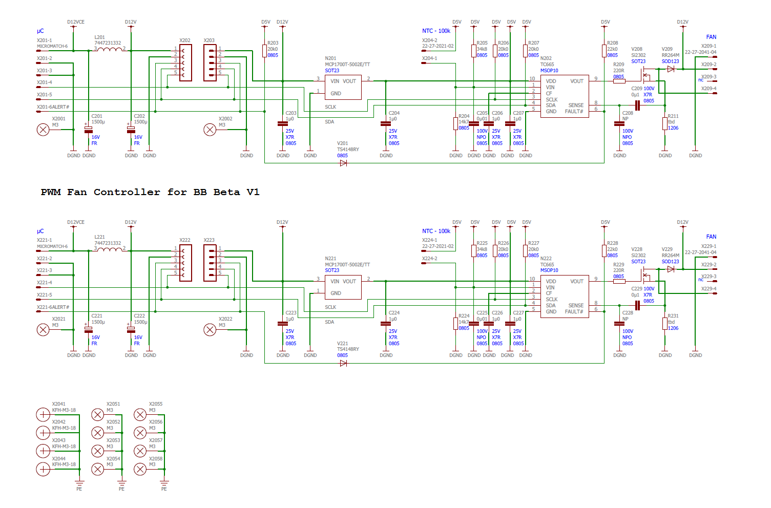

There is also the associated PWM controller, which I would not worry too much about as we can also get standalone COTS PWM fan contollers with temp sensors for $6ea.

Yep, still quite simple, almost the same as the Alpha20 except for the ground lift.
I see that the C4/C105 18p resistor is also omitted here.
Yes, ali/ebay is your friend for cheap PWM fan controllers.
I would definitely use a complete separate power supply with a little transformer for powering the fans and the PWM controller.
So both circuits/grounds are completely separated.
Danny
