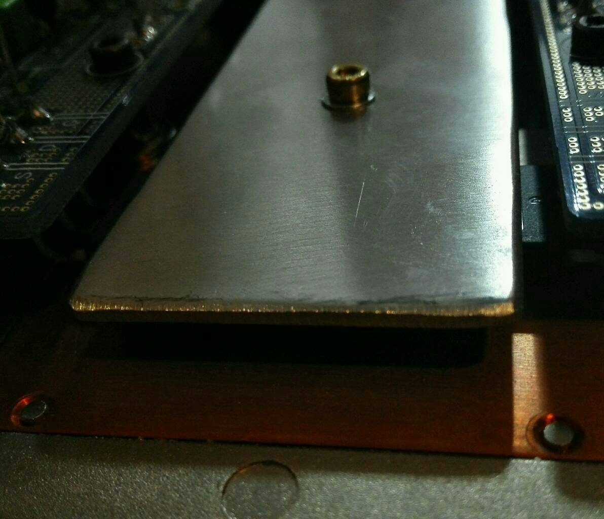

In Monotube2's case, they are 20mm thick and no fins! But sheer mass of 25kg of welded plate aluminum (looks like T-6092?) should be fine for a BB even.
666950d1520457326-aksa-lender-mos-hybrid-aleph-alpha-amplifier-dscf0417-medium-jpg

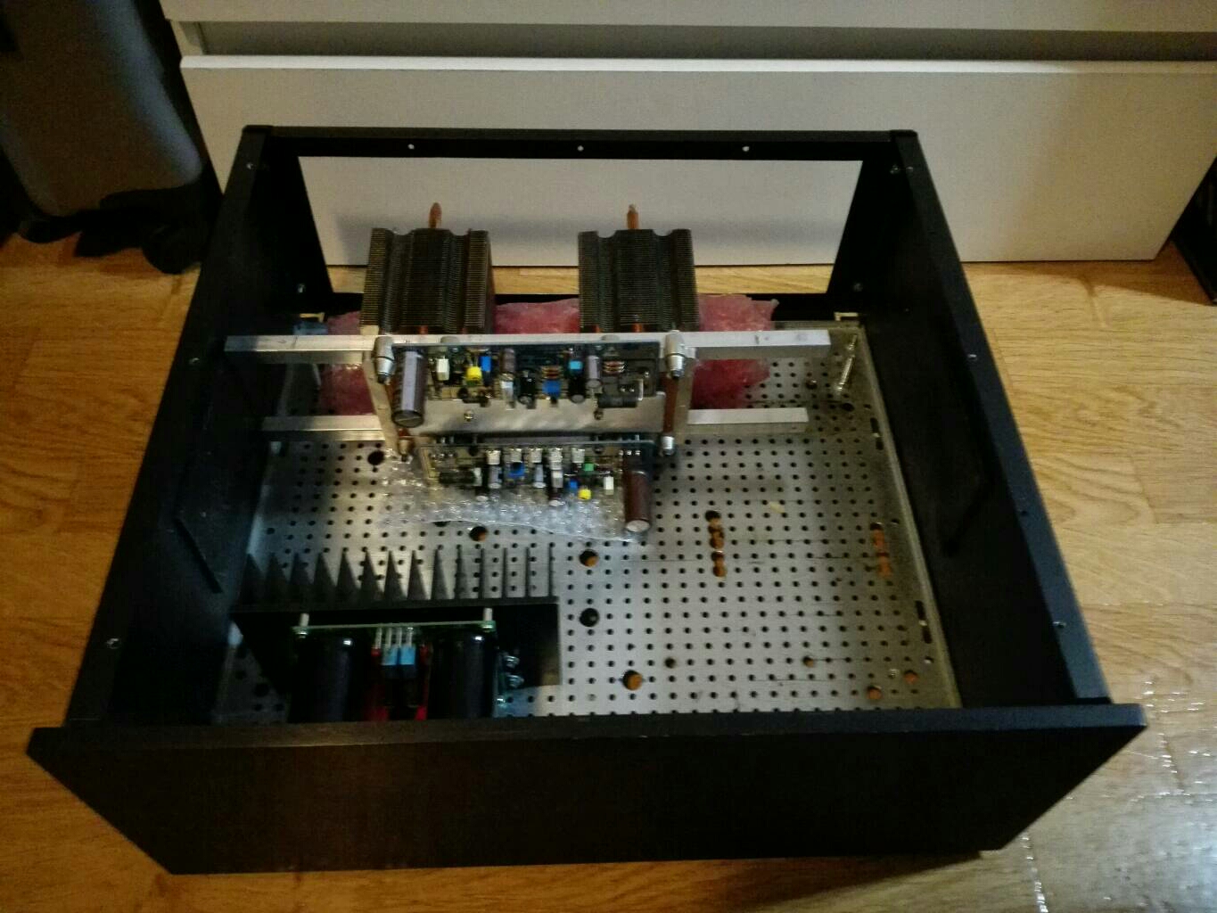

Hi, I wont forget fans 🙂 i'll power them first with external aux supply. Usually I check wires like 10 times, don't trust myself enough.
Theres just thick aluminium plate bolted on top of mosfets, needs some reinforcement, it was 5mins quick and dirty experiment. Maybe a little longer and bolts to other ends also. Bolted L-angle would be stiffer and I might chance to that later.

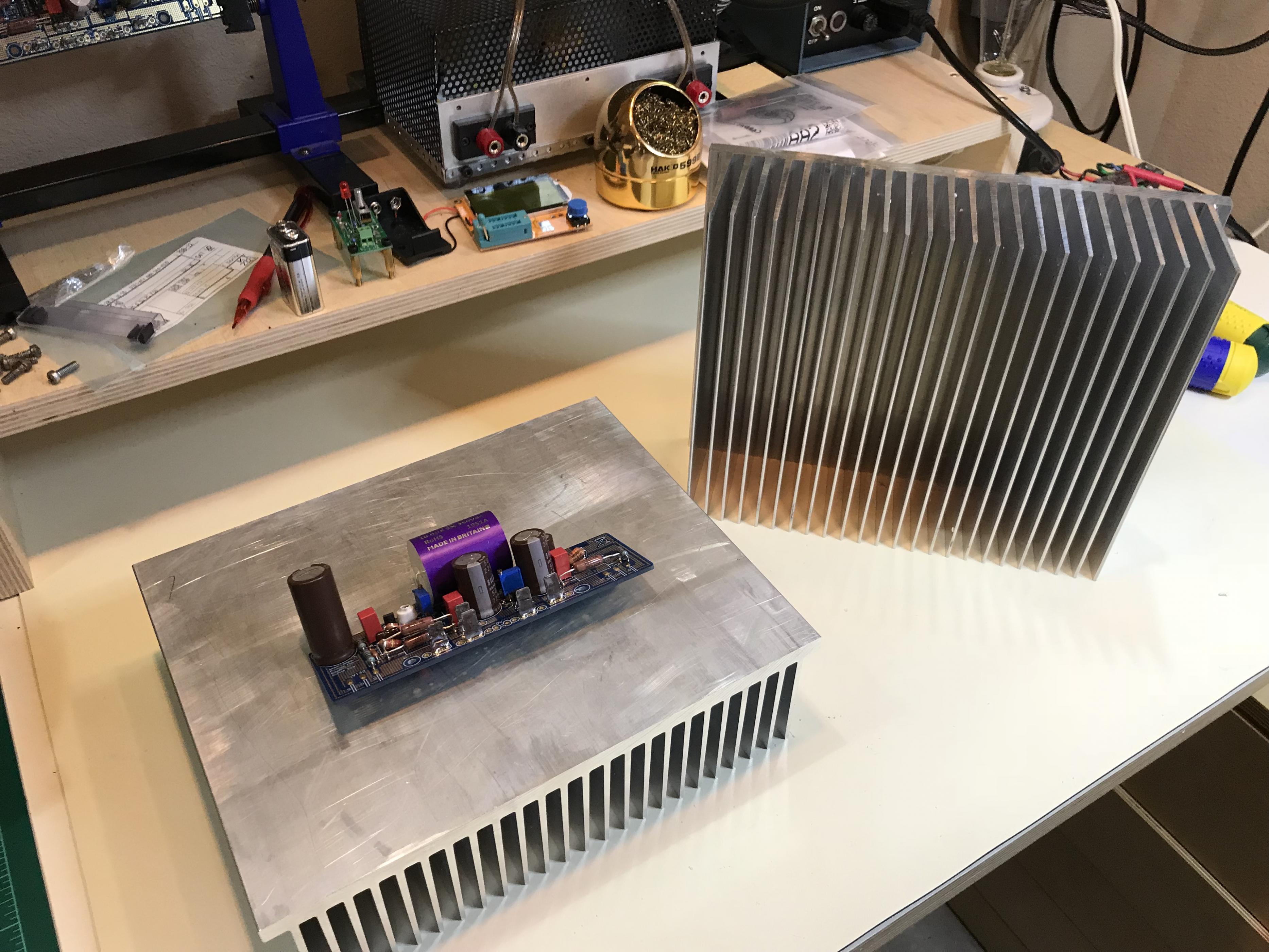

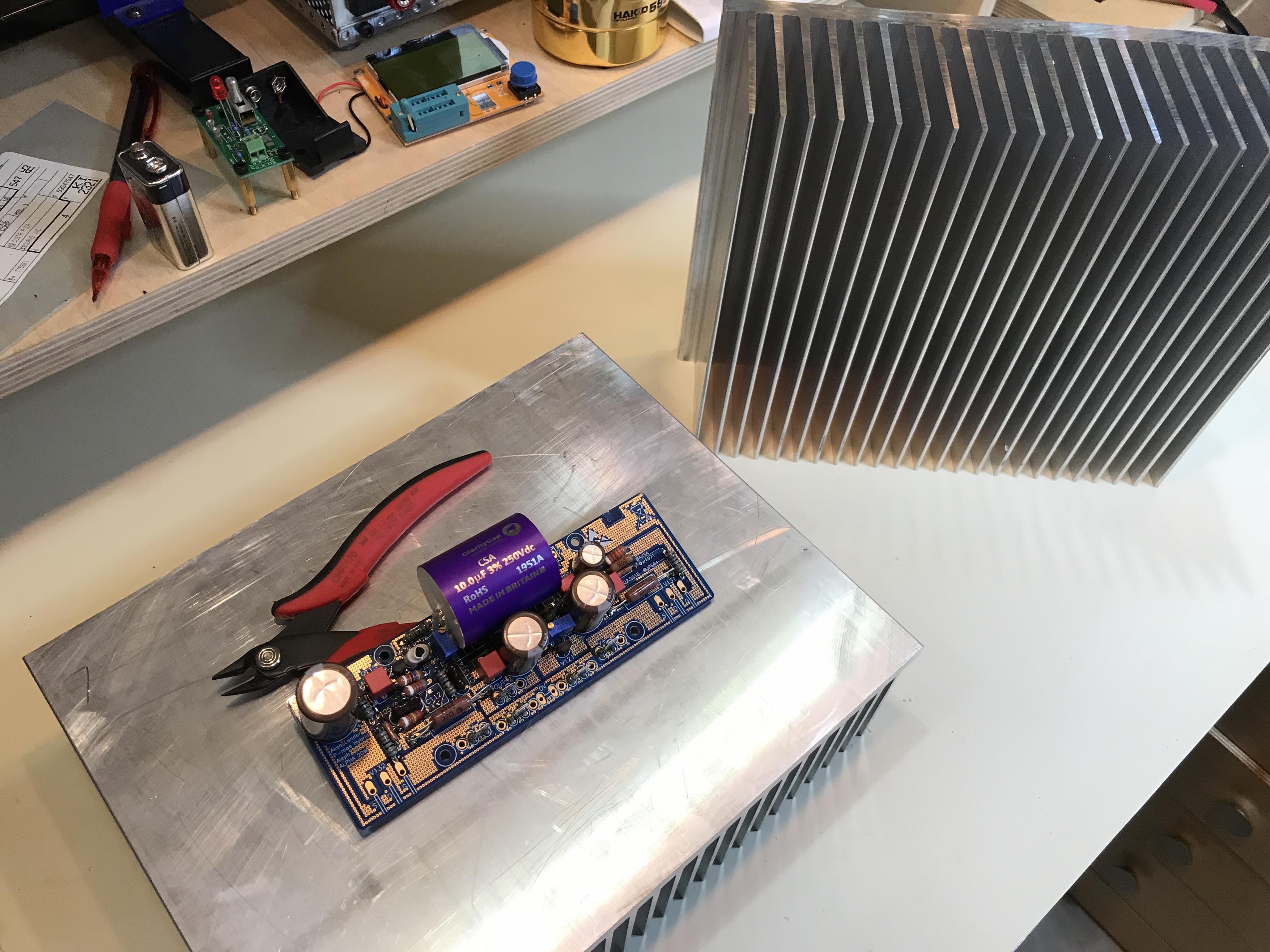

My new heatsinks arrived today, they should be ample for 20w Alpha. I'll attach a few quick pics for scale.
Each heatsink is 8" of this profile:
http://www.heatsinkusa.com/10-080-wide-extruded-aluminum-heatsink/
I'm pretty swamped for awhile, but I'm hoping to sneak in some time to get these prepped. I've matched my mosfet's and just need to mount to heatsinks, then wire up the proto-chassis for first sound.
