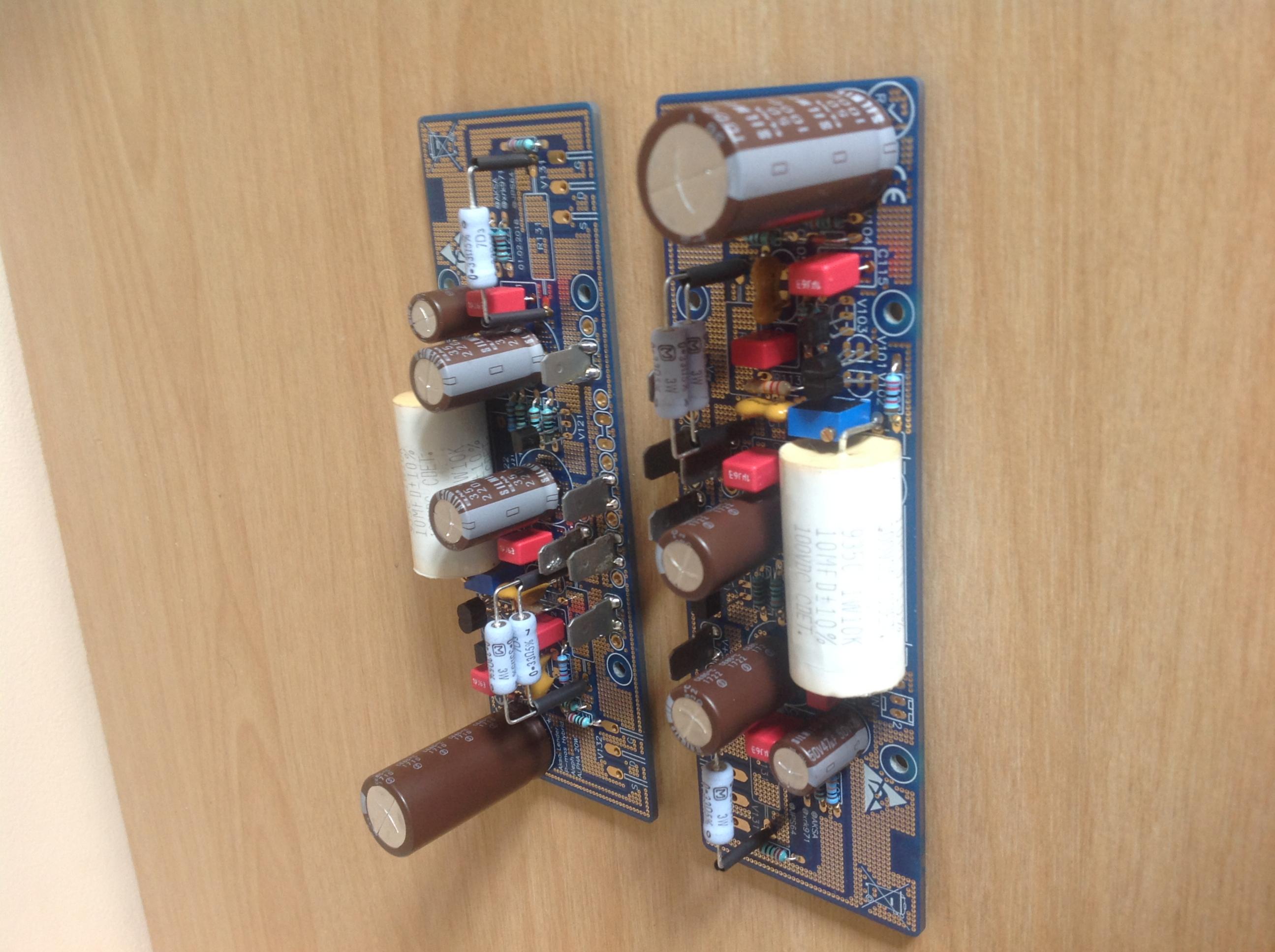

Boards stuffed with exception of output devices, transistors matched. Next step is to temporarily mount on passive heatsink ( may take a while, lots of holes to drill and tap) and check operation and dissipation etc.

Looking good! You might want to consider changing R131 and R132 to 0.47R and 0.22R, respectively. 1.93 amps bias current vs 1.35 amps. Less heat, sounds great still.

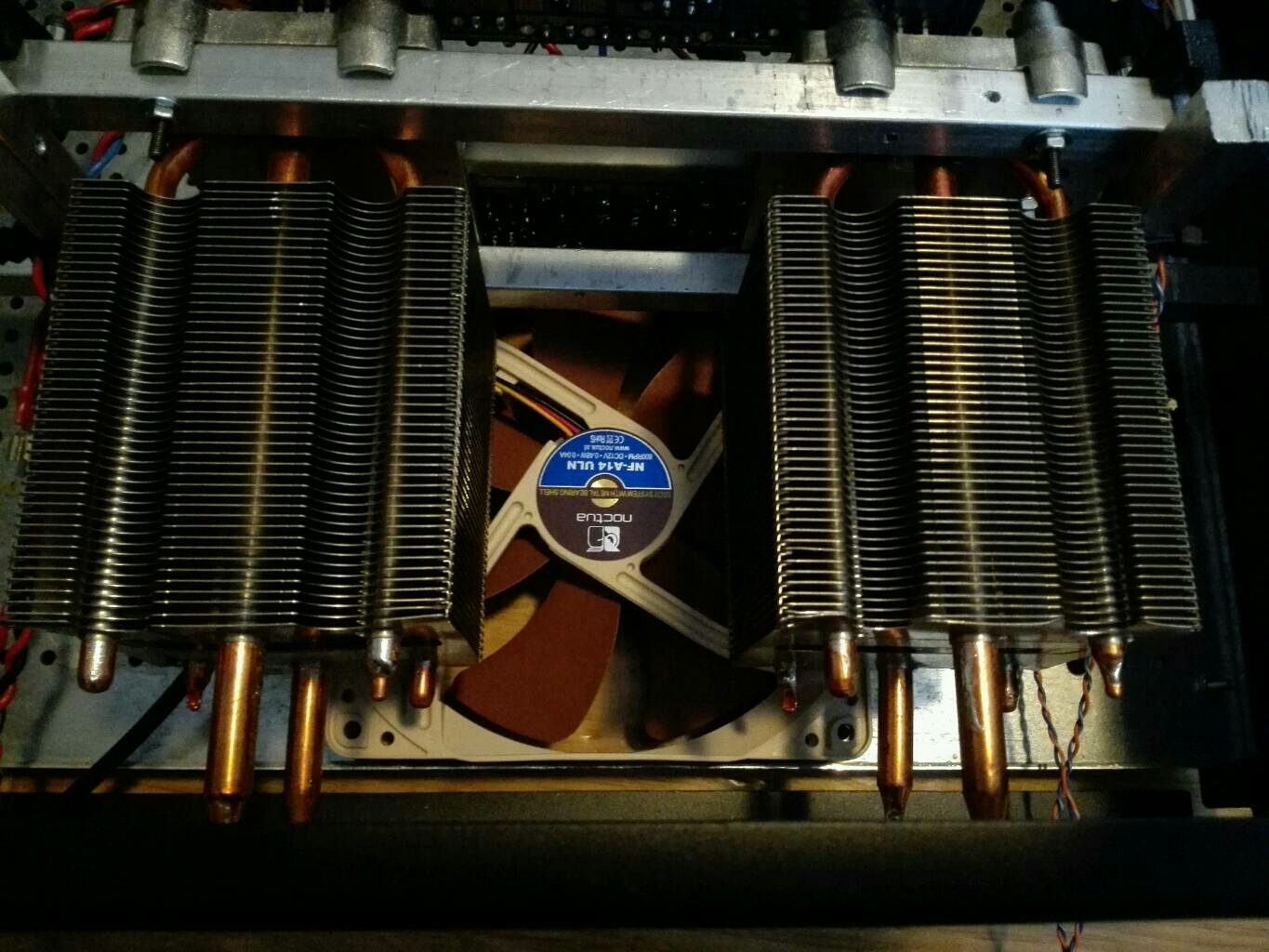

Hope this 140mm Noctua can provide enough cooling by itself. Running full 12v since I'ts really really quiet! Trafo is arriving next week, otherwise I'm ready to go, wiring etc is done.
You will know once you get it running I guess. My guess is that it will be enough. If you could put some sheet metal to direct the flow through the fins more that would help.
