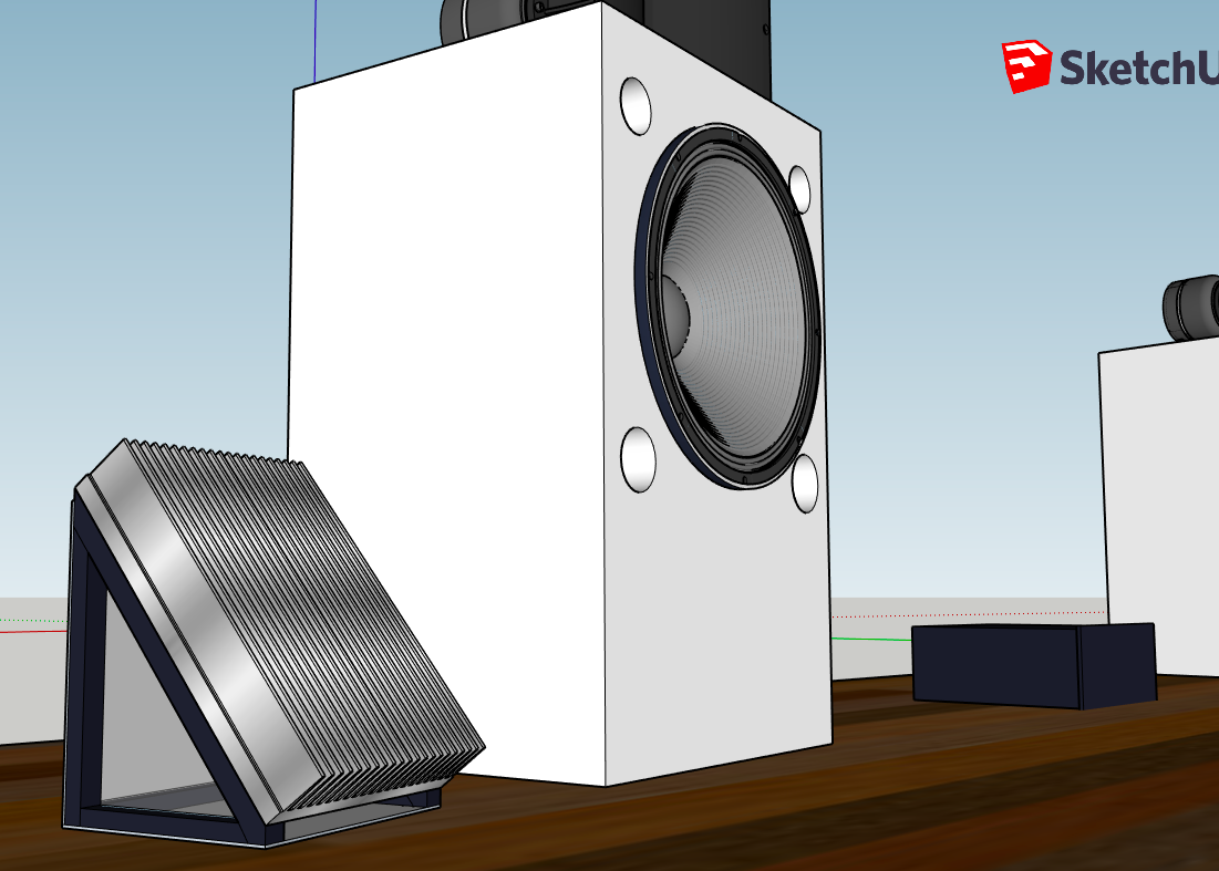

I was thinking some casework again. Something "small" and simple, maybe like this? If I place only toroid and bridge rectifiers in remote location, how do I have to wire groundings? Idea is that I could use same trafos for many amplifier projects, there would probably be 3 toroids in the same case. CRC supply, cap mx and stuff would still be in the amplifiers case. Dead idea?
Great idea. As a DIYA amp enthusiast, we build many amps for fun. The joy is the building and comparing so nothing is static, "this is the case and this is the amp forever."
That's why all my trafos are terminated with round loop crimp connectors. I have a screw terminal panel in the case and the CRC's are all terminated with spades as is the amp. So switching trafos, CRC's, amps (especially if they are UMS compliant) is not too much trouble.
The idea of a separate case for the trafos and CRC with a thick PSU cable is just not so practical. It could be done but you would need vertical rack to effectively do it to keep cables short. Then you may have to deal with some ground loops.

I've tried this once actually, with class-a mono's. Power cables was quite long too.
What I learned from there is you can add couple of caps in trafos case, but your actual CRC supply should position in amplifiers case. Grounding was a problem then (suprise 😀 ). I was just wondering would it be easier with one trafo stereo build to handle ground loops?
