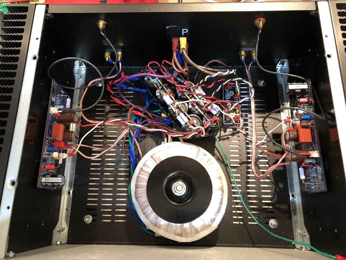

Stereo amplifier assembled:
attachment.php
Right channel closeup, notice the nickel coins used for the MOSFET washers (perfect size and thickness to allow use of 10mm M3 hex cap screws to fasten MOSFETs to UMS heatsinks without threads bottoming out. Hex cap screws and Bondhus ball drivers are key to allow easy installation with angled screw driver.

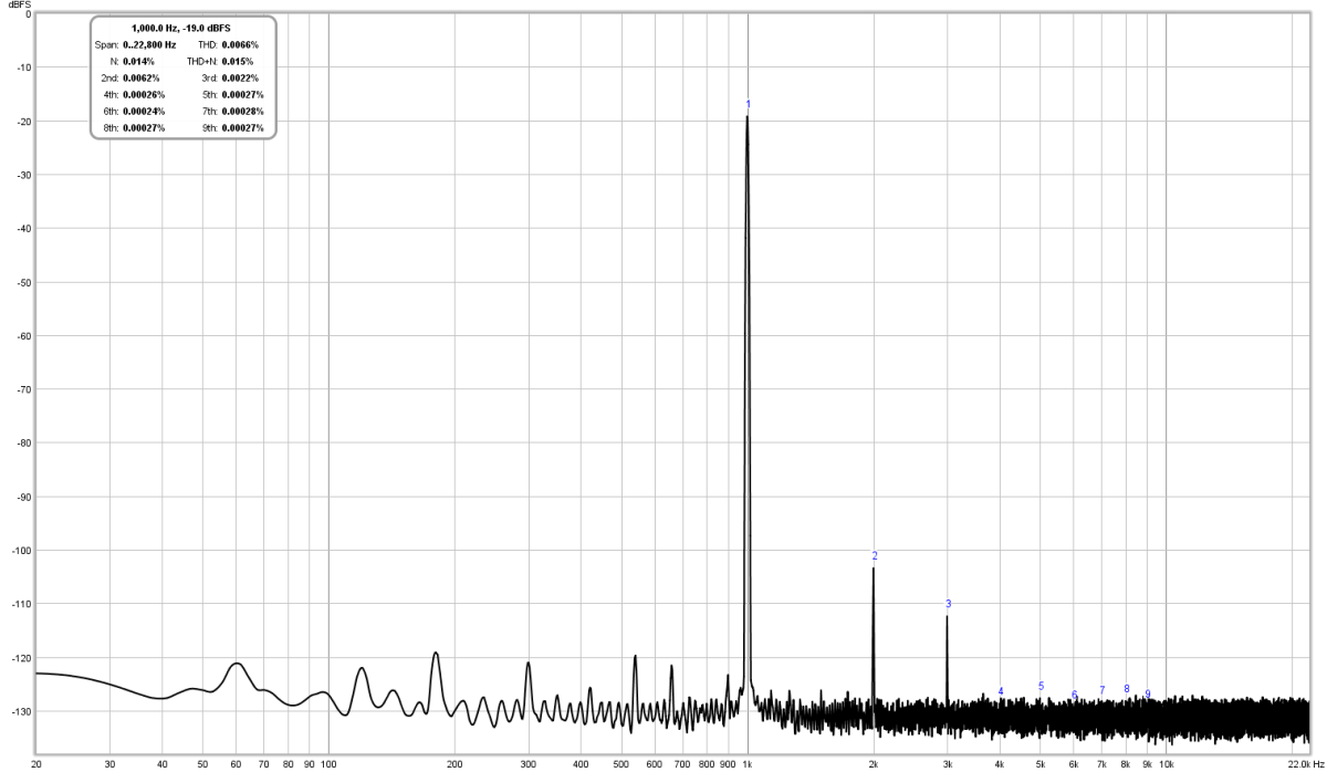

I got the stereo pair (right channel) installed and tested it and it measures just about the same as the left channel, even a bit lower THD at 0.0066%. The PSU under load of both channels shows a little ripple at mains frequencies and harmonics, but still very low. Here is the FFT for 2.79vrms into 8ohms:
attachment.php

Regardless, the results are very good:
661737d1518324741-aksa-lender-mos-hybrid-aleph-alpha-amplifier-alpha-20-2-87vrms-8ohms-fft-png

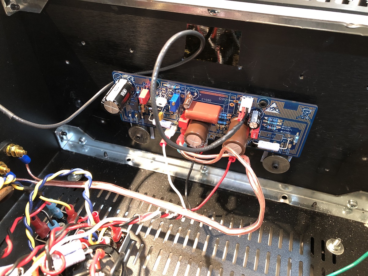

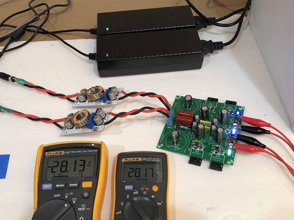

I just built the Prasi-Juma cap multiplier (dual rail, two-channels) and connected it to two 10amp 55v DC-DC step up boosters fed by two 24v 5amp SMPS. The cap multiplier provides the soft ramp up that will be needed to feed the output of the cap Mx to a large CRC filter so that the SMPS and DC boost units do not shutdown upon turn on inrush current. Here is cap Mx (note that it is built with small input cap value of 220uF just for mild filtering to avoid cap in rush shutdown, and output is also small 1000uF for some filtering as principal filter will be the CRC fitted at the output:
attachment.php
Here is the setup adjusted for +/-28v output. This is nice in that I now have a voltage regulated ultra low ripple PSU that can sustain continuous high current with an arbitrarily adjustable output voltage anywhere from +/-20v to +/-50v. The current will be limited by the SMPS (equivalent to 150w each or 300w total for dual rails). This might be really useful for the 52W ALPHA BB because I need +/-35v rails there. I have not connected the CRC yet - planning on using 10mF 63v CDE caps and 0.22R 3W Panasonic resistors. That's going to be 80mF total caps but for Class A steady current draw, should be fine.
attachment.php
If this works, and I don't see any reason why it won't, the linear trafo and masisve CRC filters that were de rigeur for Class A amps is dead.
Cost wise, this setup is probably quite a bit less than the linear route for equivalent sag-free and ripple-free voltage source for high steady bias Class A amps.

Hi Vunce,
I think this is indeed going to work very well for ALPHA20. With assumed max 2amp current at +/-24v at the amp, that’s 28v at the cap multiplier which has typically 4v drop due to Vgs of IRFP240/9240 (some may be 3.3v or so, worst case is 4.5v). So 2amps x 4v = 8w per MOSFET and x 4 = 32W total dissipation. You will need at least something as big as 50in square x 1in aluminum with fins. A large 3mm thick aluminum bottom panel on a cabinet may suffice, if running at say 1.5amps for 24w.

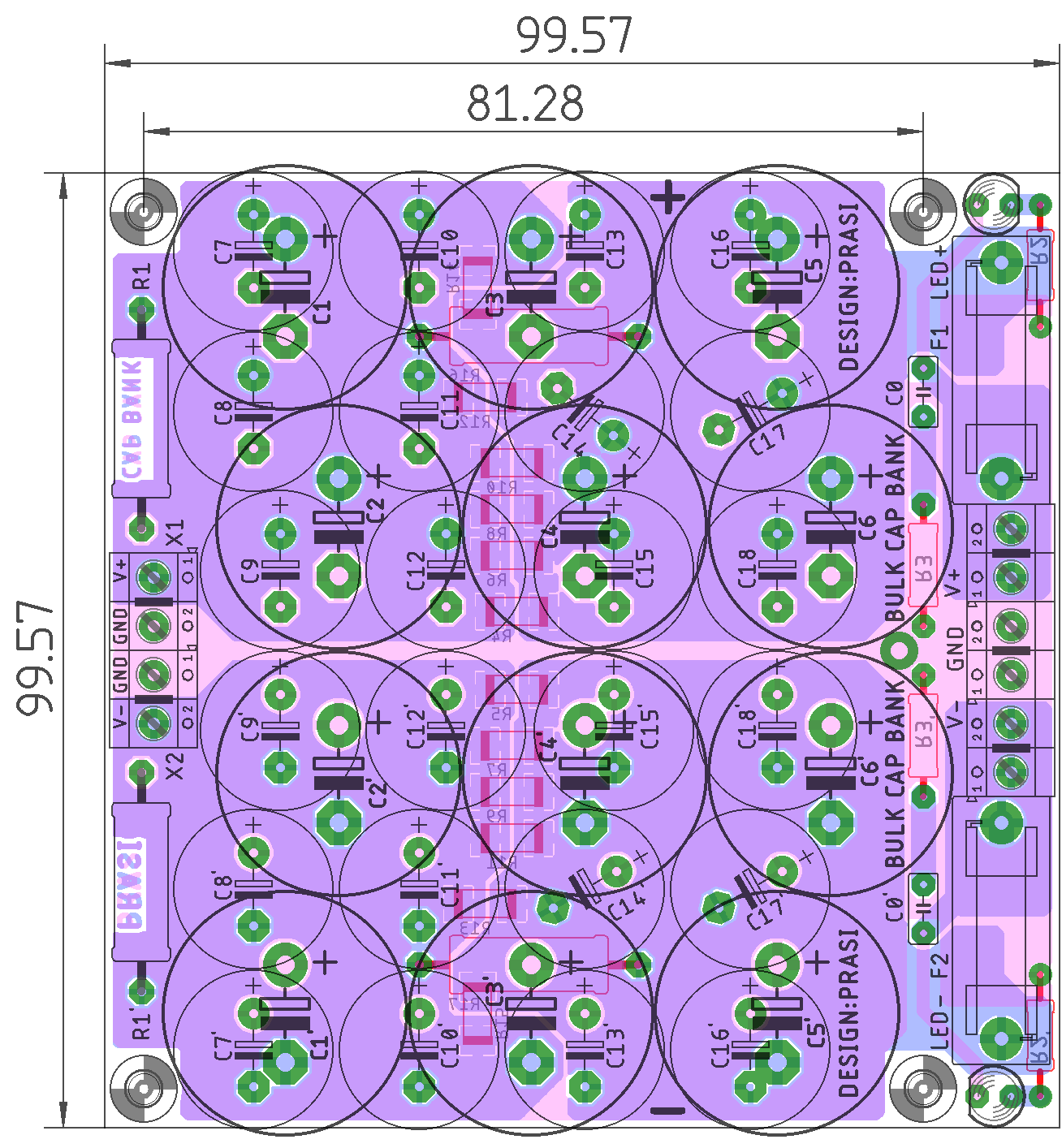

Prasi is designing a new CRC using low cost bulk 2200uF 50v caps (buy them by the bagfull on Ali) - should be able to get a nice compact low ESR CRC for cheaps.
attachment.php
I have asked him to put the common GND connected at the output where the spades are, otherwise not connected. This puts the common GND at clean side of the CRC before connecting the amp.
attachment.php

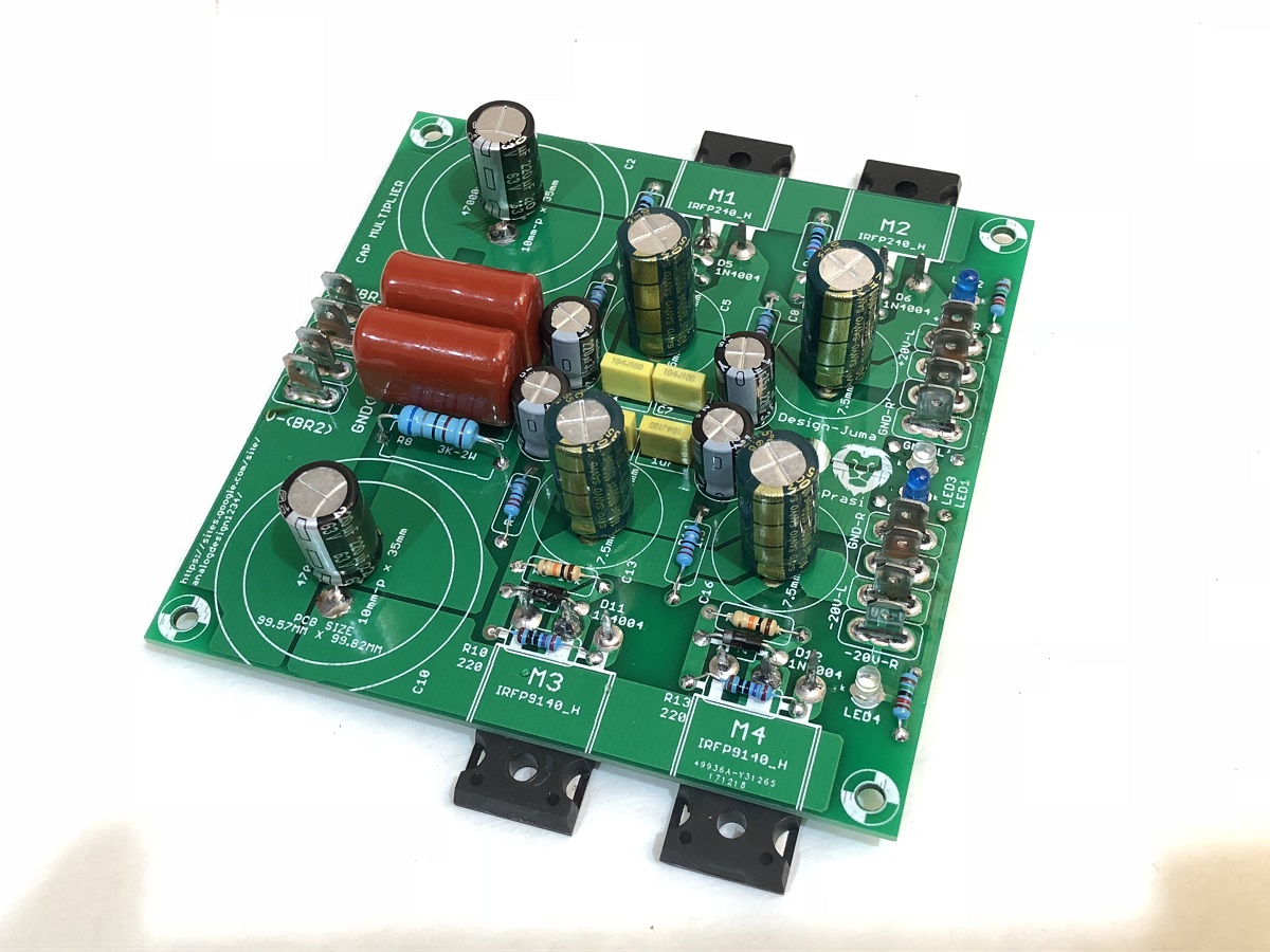

Juma's Easy-Peasy Capacitance Multiplier
Another compact 100mm x 100mm board to go witht he cap Mx board.
