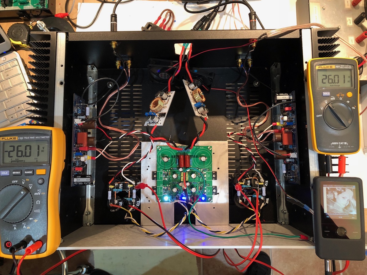

ALPHA 20 with SMPS / DC-DC / Cap Mx / CRC
I pulled the linear 400VA trafo and F6 PSU out of my case and installed the SMPS and DC-step-up PSU with cap multiplier. Well it is a lot smaller, lighter, and easy to install. I have it running at +/-26.0vdc rails and bias is still 1.3amps as governed by thr 0.47R on the source resistor/sense resistor fot the Aleph CCS. I am using a small heatsink from a Class AB LM3886 amp as the heatsinks for the cap Mx (about 10w dissipation per side). These are about the right sized heatsinks. The DC step up boards get warm and are aluminum so expect to be mounted to a heatsink.
It works ands plays music and sounds great when playing music, however, when no music playing I hear some noise and hum. I am chasing a small ground loop (about 1mVrms at the output). I like to see it below 0.2mVrms.
The cap Mx board has separate star grounds for the left and right channel. I bonded the separate two grounds per CRC together at the cap Mx output. I am not sure if that is the problem. The star point on the cap Mx
Here is a photo of the setup with +/-26v rais:
Closeup of the cap Mx:
I have the star ground connected to a CL60 NTC between the cap Mx and the chassis ground.
When I figure out the ground loop problem, this could be a very nice adjustable voltage Class A PSU.
I am wondering if the cap Mx should be split as in dual monoblocks? I am using the same SMPS and isolated cap Mx on the MoFo and it has no groundoops and is dead quiet. The ground loops drive me crazy.

OK JP's suggestIon is good.
Is the input side cap value too low on cap MX to cause this?
Also is the signal input connected when this hum is observed?

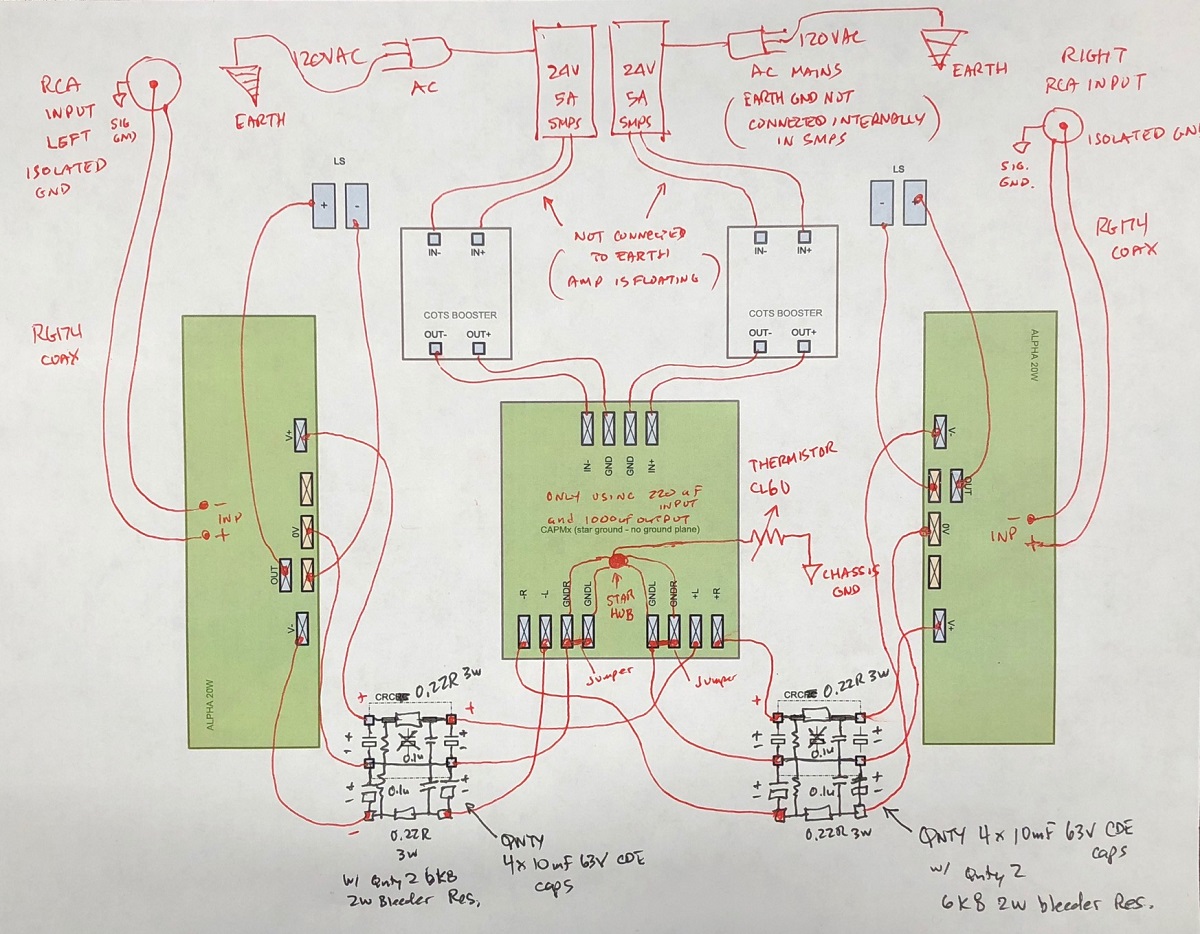

Hi JP,Hi X,
can you wire the attached sketch for better understanding?
JP
Thanks for offering the diagram - this is really helpful. What I see is that the amp is floating relative to earth gnd, but that's ok - the MoFo was the same way. When I connect the chassis gnd (even though floating relative to earth gnd) to the star hub, the noise is substantially less but Fluke 101 mV scale shows 1.1mV. I can hear slight hum and some HF white noise. Almost like there is some noise being generated in the Cap Mx. I ran out of 1uF film caps so using 0.1uF and 2R2 for Cap Mx snubber vs recommended 1uF and 1R5. Maybe that might be source of noise?
The CRC uses a 12 gauge solid copper wire bus for the ground in "U" shape. Should CRC been kept separate gnd for each rail? But then when it reaches amp it is one (0v) GND wire.
Attached is my marked up diagram. For my CRC I have 6k8 2W bleeder resistors from each rrail to 0v and 0.1uF 100V film caps bypass at the output.
Thanks again.
X
Btw, I moved it off the bench and into the listening room and it works to power the speakers very well (apart from noise if one presses ear to the speaker cone). Neat to see such a compact lightweight PSU compared to 12lb 400VA trafo.
Hi xrk,
How is signal gnd connected on amp pcb. Is there a 10ohm lifter?
Try to follow Bonsai recommendation for grounding.
Spk grnd to crc gnd or cap MX ground, to see if that's the case.
If everything fails put just the proper cap MX w/o crc and also check all individual blocks to see the problem source. Eg transformer and just cap MX as per bom supplying 2 channels and all gnds connected on cap MX output . It's the way Juma desIgned if I am not mistaken.
Regards
Prasi

Thanks, Prasi. Ok I will try without CRC and put all grounds from Star hub. Does that include putting the signal GND from RCA to star hub and skipping negative frommRCA to PCB. No 10ohm ground lift on PCB. Only CL60 thermistor to isolate chassis and 0v.

Hi X,
Try disconnecting the RCA ground from the chassis - if it is presently connected - as the signal ground should be attached to fb shunt cap then through a 10R ground lifter to power ground ON THE MODULE PCB.
This should do it......

Hi Hugh,
The RCA jack is an insulated one and not connected to the chassis. We don’t have ground lift resistors on-board.

Hi x,
you could try either way, but proper way is connect signal gnd to amp PCB gnd via lifter at the local decoupling star gnd as given by Bonsai in the link (page 29) and as suggested by AKSA..
Is the hum still present when signal is unconnected/shorted. then problem is somewhere else.
was this problem not present when you tested earlier with regular psu +trafo set up?
