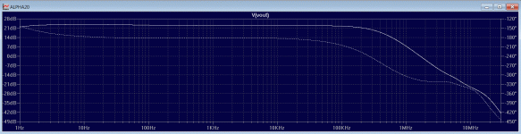

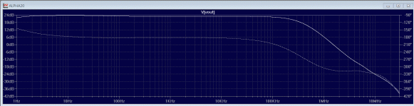

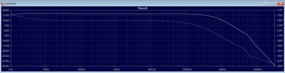

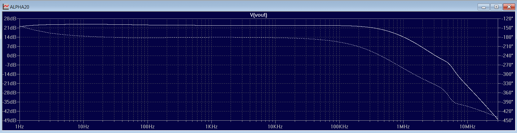

Vout phase shifts on the ALPHA 20
Hi Danny,
I have done a bit of LTSpice analysis with a single pair of IRF 240/9240 outputs. This is a little simplistic, but it gives us the idea. Certainly a larger mosfet pair will slow things down and increase phase shift, but they are mosfets and they are in source follower where there is very little phase shift. Ergo, it won't make a lot of difference although it would be better to use them in the future when I have figured out how to incorporate into my Spice model directory. It should be easy with Notepad, but I'm not exactly sure at this point. Any help here?
The first graph is the original 18p + 18p compensation, one from collector of VAS (C1845) to ground, and the other from source of pmos back to fb node.
The second is the original 18p source pmos to fb node, with the other 18p dropped.
The third is my amended circuit with 22p across the 22k fb resistor, and the fourth is the amended circuit with Danny's suggested 5p across the 22k fb resistor.
They make interesting reading. We look for the phase shift from input to output when gain has fallen to 0dB. From this point on, nfb is transformed by phase shift into positive fb, but the amp cannot oscillate because it has no gain at this frequency. This defines Bode Stability. Only the compensation components, the topology and the active devices set this figure.
We find what frequency this 0dB gain lies at, and then how much phase shift is at the point, and try to ensure this phase shift is well under 360 degrees.
You should look at each graph at 0dB gain. The topology, compensation caps and devices this frequency. If the phase shift at this point is less than 360 degrees (input started at 180, so 360 represents a further 180 shift so that negative fb now is positive fb with the real danger of making an oscillator) and if the margin is less than 180 degrees of phase shift this becomes the phase margin and should be better than 30 degrees. A phase margin of 30 degrees would represent 150 degrees of phase shift at that 0dB gain point between input and output of the amplifier.
See if you can figure out what you should choose!
