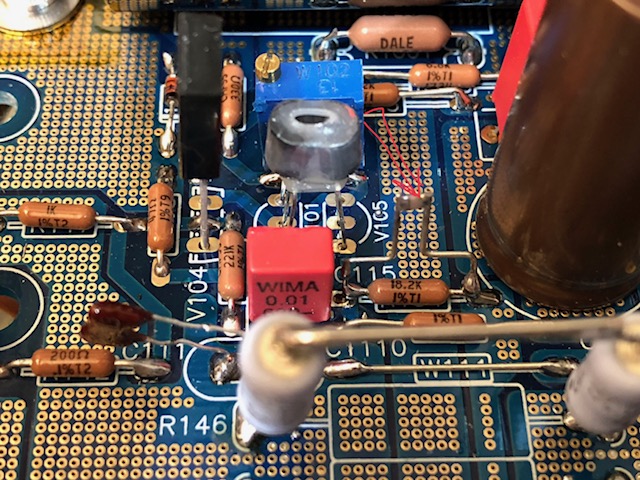

Yes, on B.B., Hugh suggested that I disconnect C111 and add 22pF NP0 (or silver mica) in parallel with R154 (feedback resistor). I did so and the top end sounds like it has more clarity, perhaps less distortion, it’s subtle but perceptible. I think it’s an improvement to an already great sounding amp.
On Alpha 20 I guess it will be simply remove C105 and leave C113 at 18pF or increase to 22pF NP0 or silver mica - Hugh will confirm. It’s an easier operation on the Alpha 20 as the C113 is already there.
Hi X,
R134? You mean R154?
JP
Yes, sorry about that. Will edit now.
Here is the little through hole 22pF cap I made by soldering two legs into an 0805 SMT 22pF NP0. Then I straddled it across R154.
