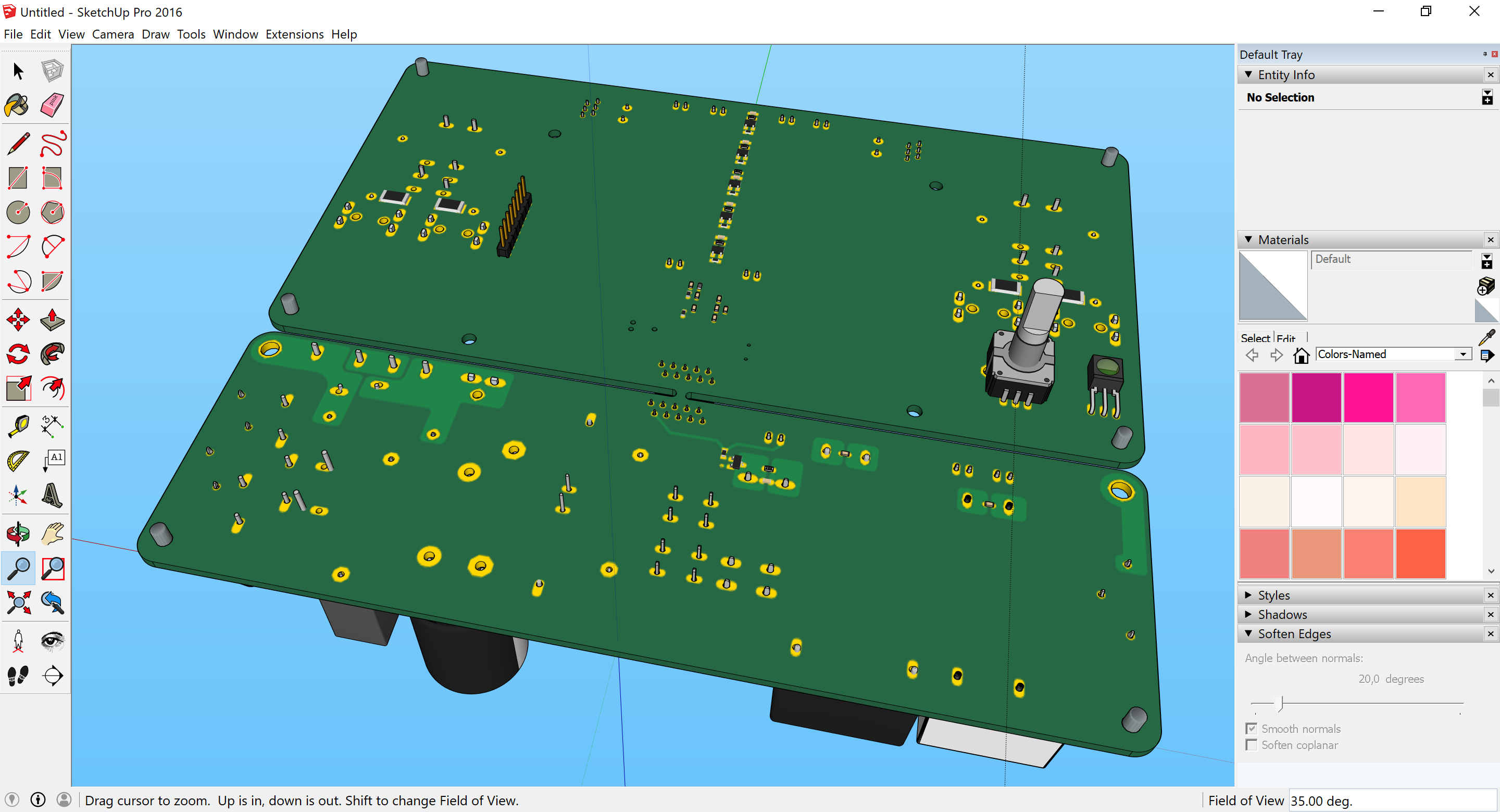

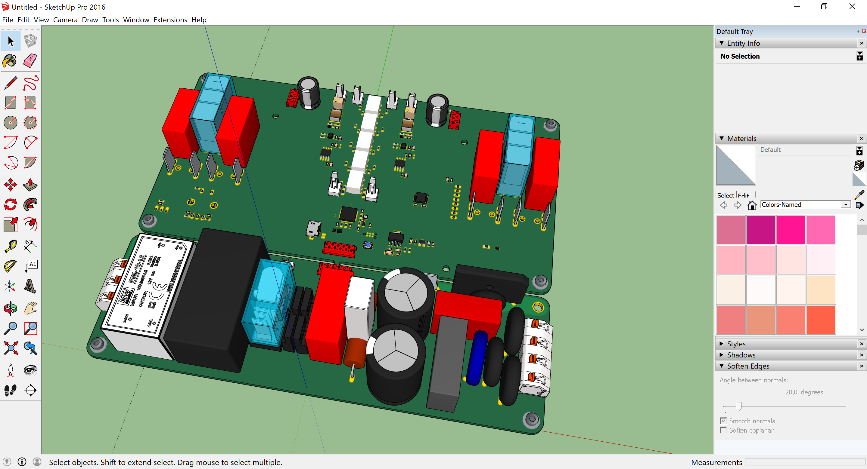

Very busy professionally, I´ve find some time to progress with the universal microcontroller based VU-METER.
I´ll use following E-Ink display:
400x300, 4.2inch E-Ink display module, three-color, SPI interface
MMI is to be defined but thinking about alarms, dB VU-METER , FFT and more.
The attached three schematics include two parts:
- the +5V analog AC/DC converter, the +12V digital (PWM) AC/DC converter, the DC blocking and the inrush current limiter: works with 115VAC or 230VAC
and
- the stereo VU-METER electronic sensig loudspeaker level: potentiometer settings 0dB before clipping; the ground is the analog ground therefore isolated from digital ground
- relay attenuator controlled by microcontroller using PEC11 encoder as volume control
- IR remote control
- ALPHA BB stereo PWM I2C interface with temperature control and +12V digital power referenced to digital ground
- DC power relays switches (R/L) controlled by microcontroller
- microcontroller with USB interface and bootloader
First step: finishing layout and ordering first prototype for software programming.
I´ll put the schematics and all datas online for check before ordering.
Comments are welcome!!!
Yes, I´m using SMD components.
PCB is 4 layers (using also for AC part creepage rules of innerlayers).
Find first 3D view attached (missing E-Ink display).
JP

Jean-Paul,
This is brilliant. I don't even fully yet understand what you have supplied here, but certainly it offers a huge array of control and metering functions that even a highly sophisticated amp in the $50k range uses!
Thank you very much, this is very, very kind of you - not to mention the high level engineering in all these functions.
Hugh
Hugh

Very nice JP! I like the 0.1% 15ppm resistors used for the stepped relay volume control. We can expect the best channel matching here. Can you explain how it works because I see the 6 relays and each has 2 positions. I would have assumed one position is simple NC but it switches to a different value - are you getting 12bit resolution with this method vs 6bits(64 steps)?
We might want to put the rotary encoder and IR on a cable to make placement flexible. Although I see what you have allows the whole thing to be mounted on front panel and have a window for ePaper display. Will rotary encoder also have push momentary action for menu selection? Or maybe add a few push buttons for menu and leave knob purely for volume all the time.
Thank you. This is going to be make a very nice addition to any high-end ultimate end game amp.
