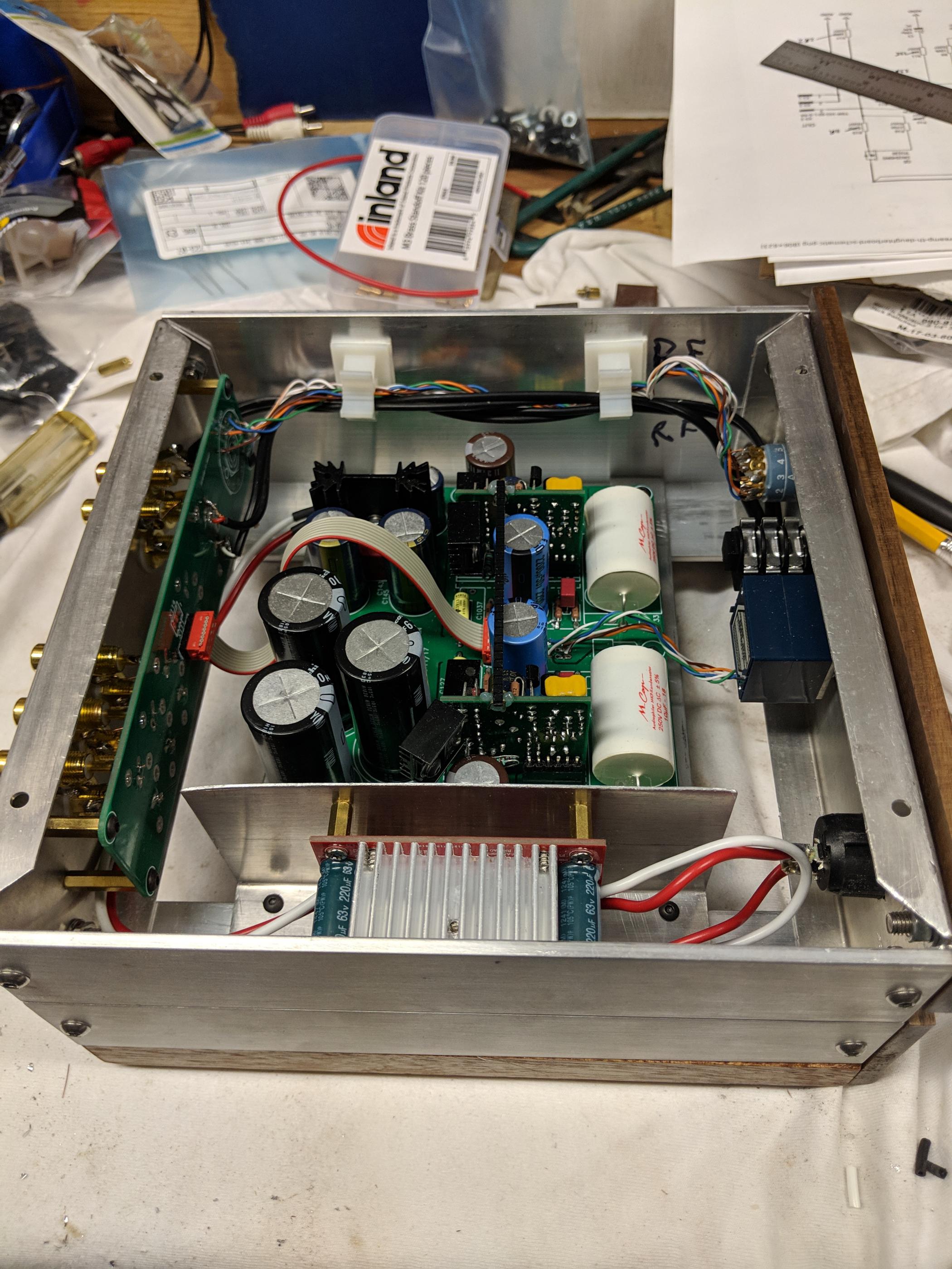

Getting close to hooking power up. I have one of the eBay red DC step up boards as can be seen in the last set of pics and a 12v 2a class 2 supply. The board has 2 adjustments, volts and I think current? I'll set the output to 24v, do I need to do anything with the other adjustment?
It adjusts the max allowed current and if too low, bias current on HPA wont be enough. One way to test is you need at least 300mA at 24v to give some margin. Connect a 10W 80ohm (or close) load resistor to DC step up. Adjust until it can maintain 24v. That’s 7w burning off so be careful it’s hot. Or adjust using HPA as load - increase until you get full bias current on HPA (wherever that may be). Circa 80mA to 120mA.
Testing using the amp as the load is that the current going to Q4 that I need to probe? So now the basic question. Do I connect the probe to the leg going to ground and the leg connected to R15?It adjusts the max allowed current and if too low, bias current on HPA wont be enough. One way to test is you need at least 300mA at 24v to give some margin. Connect a 10W 80ohm (or close) load resistor to DC step up. Adjust until it can maintain 24v. That’s 7w burning off so be careful it’s hot. Or adjust using HPA as load - increase until you get full bias current on HPA (wherever that may be). Circa 80mA to 120mA.
Measure voltage across R14 or R15. Then use Ohm’s law to get current.
Measuring across R14 I come up with 100mA and it is insensitive to adjustment so perhaps the DC stepup board doesn't adjust below minimum required?
The adjustment on the DC-DC step up is probably very coarse and may have quite a high minimum. As long as you are able to get your 100mA per channel that’s fine. Also, the current adjustment on the DC-DC probably varies current by adjusting voltage. But you are measuring current across a CCS, which is designed to maintain a constant current despite changes in voltage.
Well bench tests went OK using a phone as the source and earbuds for testing. Thinking I was good to go I hooked it into my system and after about 15 seconds of playing I started to get massive distortion through the speakers, tried headphones with the same result. The distortion is independent of volume or source selection and happens even when I unplug all sources. For some reason I thought of the heatsinks on the DC step up as something to check. They are very close to the side of the chassis. If they are touching or very close could this cause distortion? What other things should I check?

You have a very nice build there - great craftsmanship and care to placement. What concerns me is that it took 15 seconds for the distortion to show up. Sort of indicates something burned out or went bad. When you say distortion, do you mean garbled sound or or scratchy sound, or weak sound?
You say that it worked fine on earbuds, why did you connect a headphone amp to speakers - and how many ohms impedance are the speakers? This amp should not be used to drive anything less than 30ohms.
Things to check
1. What is your Vcc after the cap mx and CRC - voltage at the Vcc input pin on the daughtercard
2. What is the bias current across the source resistor (R15) of the CCS DN2540? It needs to be circa 100mA.
3. What is voltage (relative to GND) of the bottom of R15? It should be about 1/2 of Vcc.

1. 19.66v at the pin closest to the x1 label on the DB
2. 102mA
3. 11.17v
4. playing on bench with ear buds now seems ok
5. 4a and 4b both about 1.07 mA

Check your DC-DC step up output voltage. Is it stable? The fact that things happen repeatedly after 15 seconds may be related to the voltage supply. 15 seconds is how long the cap Mx takes to come up to full voltage. You may have a bad electrolytic capacitor that fails at max voltage of 48v. Measure voltage at the daughterboard as you turn on and wait for the scratchy sound to appear.
So I hooked up another Modi I have and my Meze headphones with it still on the bench and let it play for 30 min and it sounded perfect. Voltage remained stable. I have one test track that is just silence and I would get some noise when turning the volume pot but silence after even when set at full volume. I am just not able to duplicate the issue I had earlier when it was plugged in to the ACA in place of the Vali. I guess I will try it again and see if I can isolate some part of the hookup that causes distortion.

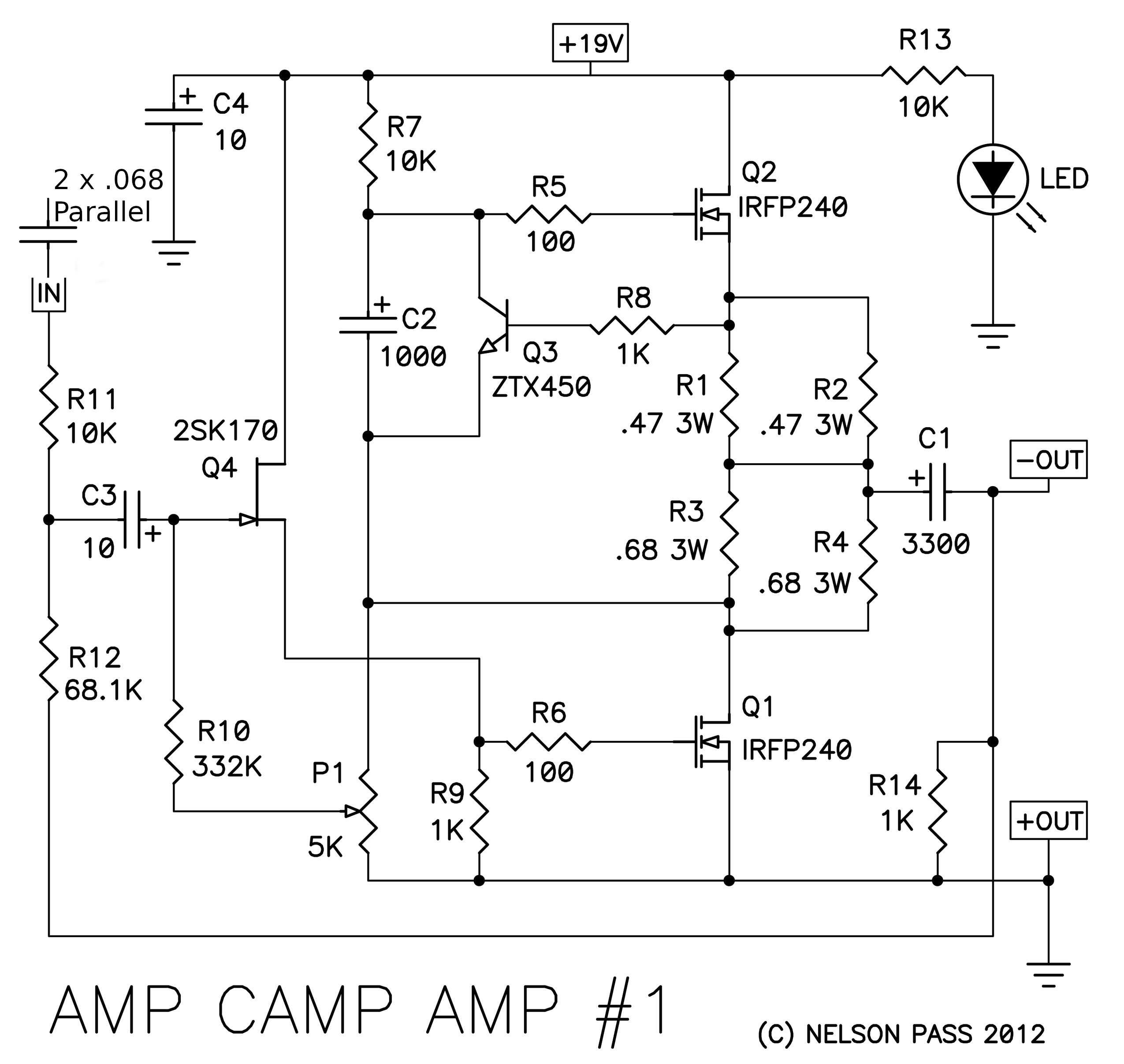

The CDE 381LX332M035H012 3300uF 35v cap looks like the output coupling cap C1, not input coupling cap. That's C3, usually a 10uF. Typical choice would be an Elna Silmic II 10uF 35v (a tiny one).
Can you show how you connected the 0.068uF Wima film cap? What do you mean by a first order filter - in conjunction with which resistor? If you put it after the 10k input and tied one end to gnd, that would be a 234Hz low pass to ground, and the music would sound like it is playing through a subwoofer. Maybe you can sketch what you did to the schematic above.
Sorry yes input cap is
https://www.digikey.com/product-detail/en/elna-america/RFS-25V100ME3-5/604-1050-ND/970211
Updated the schematic to show 2 caps in parallel before input to create a value of .136 UF per channel. Goal was a high pass line level filter before the ACA, caps are connected between the RCA input jack and ACA pcb.
So you are using the ACA as an active amp in a multiway speaker then with a 117Hz high pass first order XO? I don't see anything that can be causing distortion other than maybe there is overheating going on with your TO220 parts on the amp daughterboards and they are getting too hot after a certain time. 100mA with about 10v drop each is 1W per TO220 - should be ok for the local heatsink fins you have.
