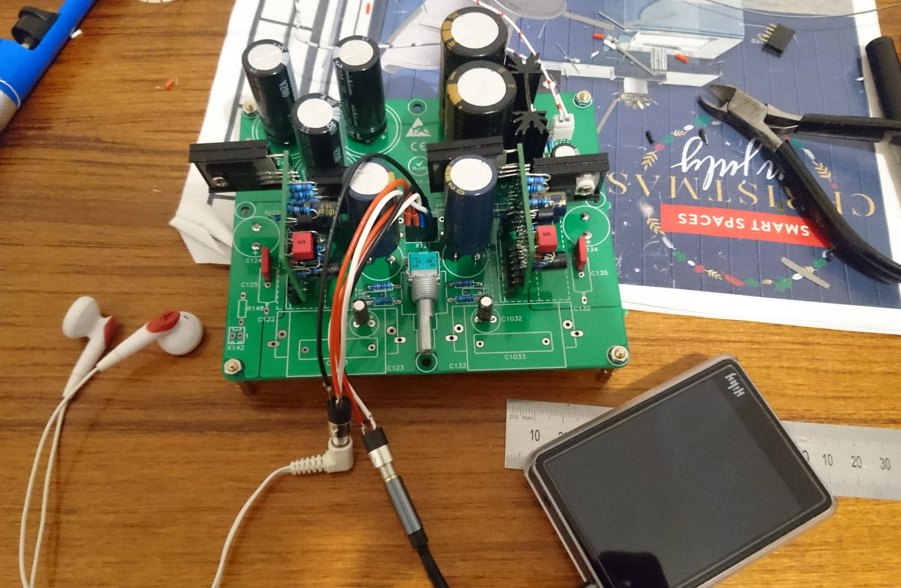

I fudged it - installed the pins the wrong way and tore up the tracks while desoldering it. Now desoldering the other components instead to put them onto a new pcb
Sorry to hear that. You can repair lifted traces with a jumper from exposed trace remaining. But if you have extra boards, that’s the best way. Make sure you follow stuffing guide as position of the stand-up resistors is tricky. Also check values with DMM prior to installing each part. That cost Twocents several weeks of debugging.
The boards you sent with the dca boards came in handy. A bit of wire couldn't save the board I stuffed up on...pads came off with the header pins as well. Close to being able to fire it up, just have to make up some connectors for the Jacks. Haven't really gotten the hang of crimping for the jst connectors (for power) either

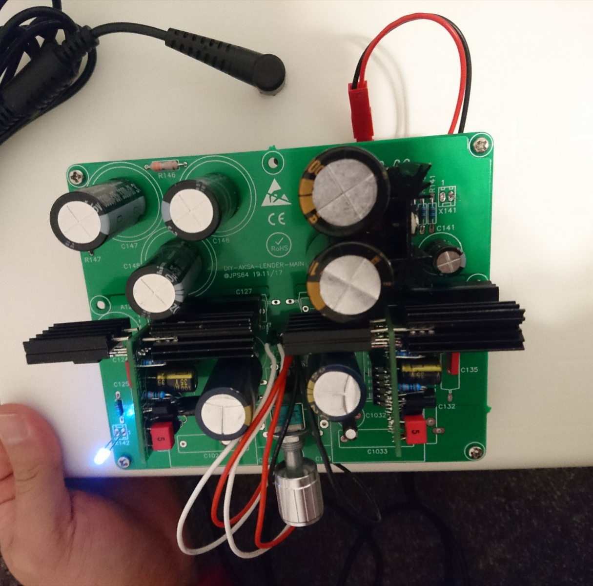

Got it working now. Phew!
Initially had one of the filter caps sound the wrong way, power supply voltage kept dropping and current draw increasing, and I heard a sizzling. Pulled the plug before it burst, and seems like everything is fine after swapping that cap out. Also had to put larger heatsinks (than what's on them in the picture)on the mosfets - they got too toasty with the small ones.
Will probably change the input, output and pot connectors to dupont ones, think it'll look cleaner and be more stable. I'll get started on mounting it while waiting for the dupont connectors to arrive from China.

Good news that it’s working. You are lucky that cap did not blow like a firecracker. I have had that a few times but mostly because of over voltage and not reverse voltage.
Thanks!

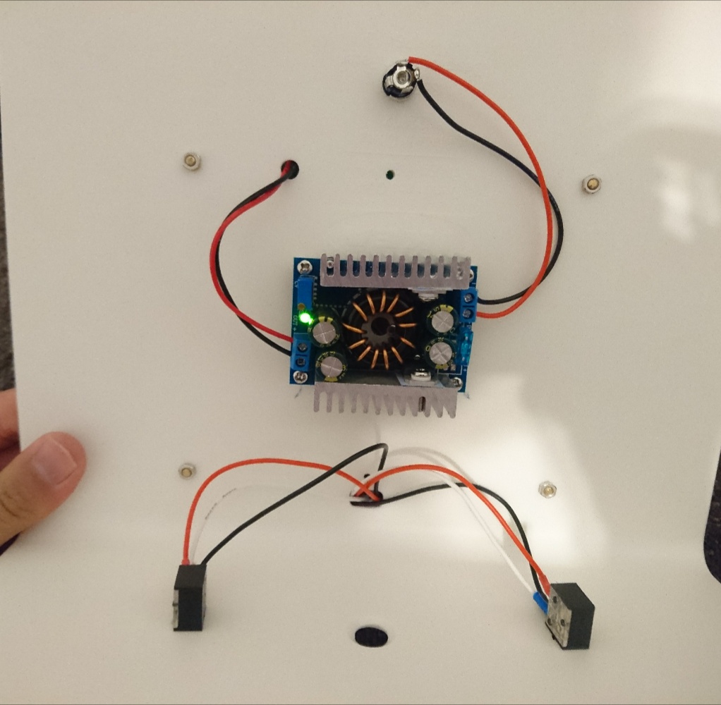

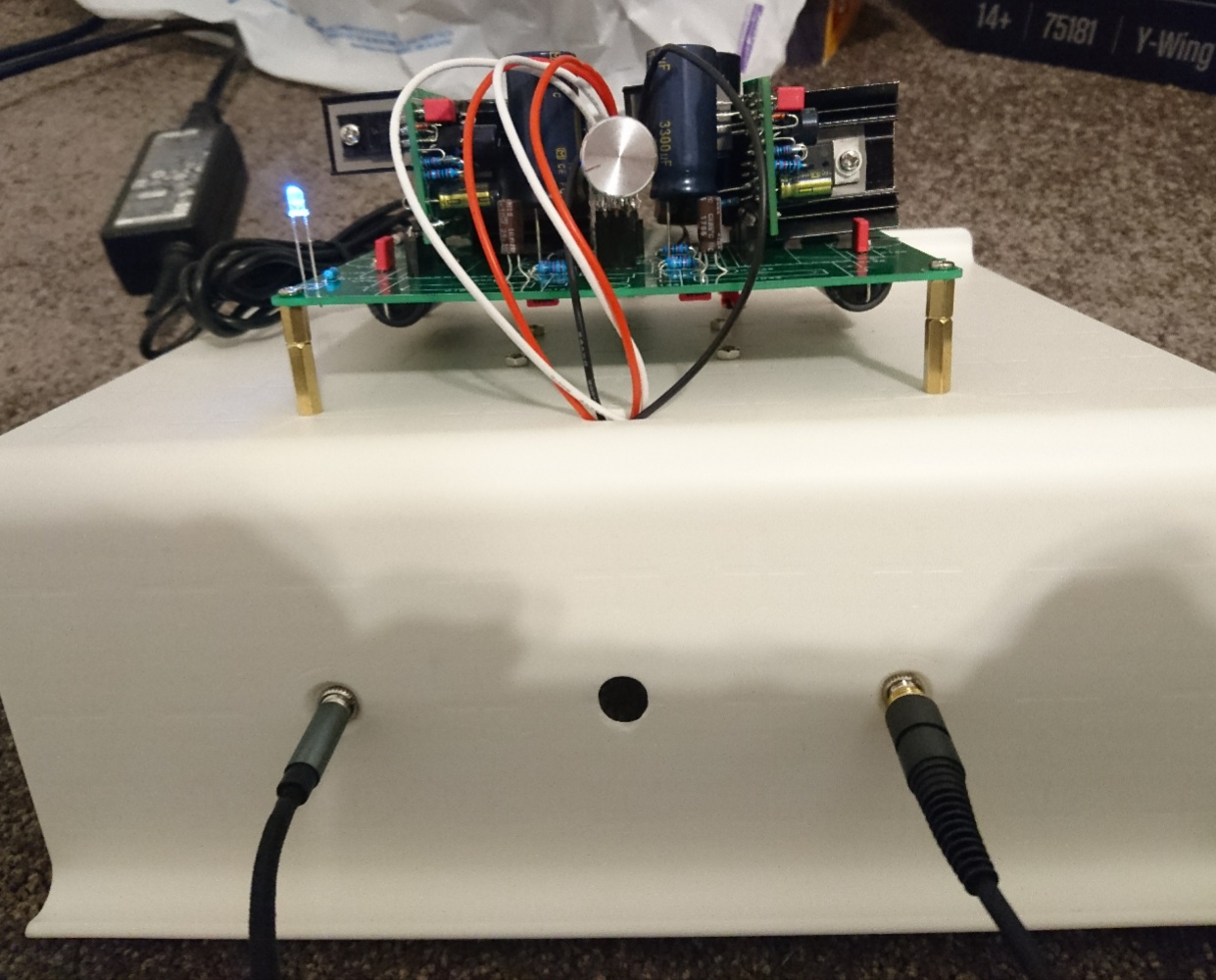

Mounted this one up, waiting on the dupont connectors for the pot, eventually it'll be occupying that hole between the headphone jacks. For now it has some pcb pins on its legs to extend them. Jst for power is temporary, will be a terminal block when I get some with the right pitch.
The mosfets on the daughterboards gets pretty toasty so ended up with the larger heatsinks on them.
3300u FC on outputs, but that may change.
This step up has a weird 3 stage whine on first power up so probably gonna swap it out later.
