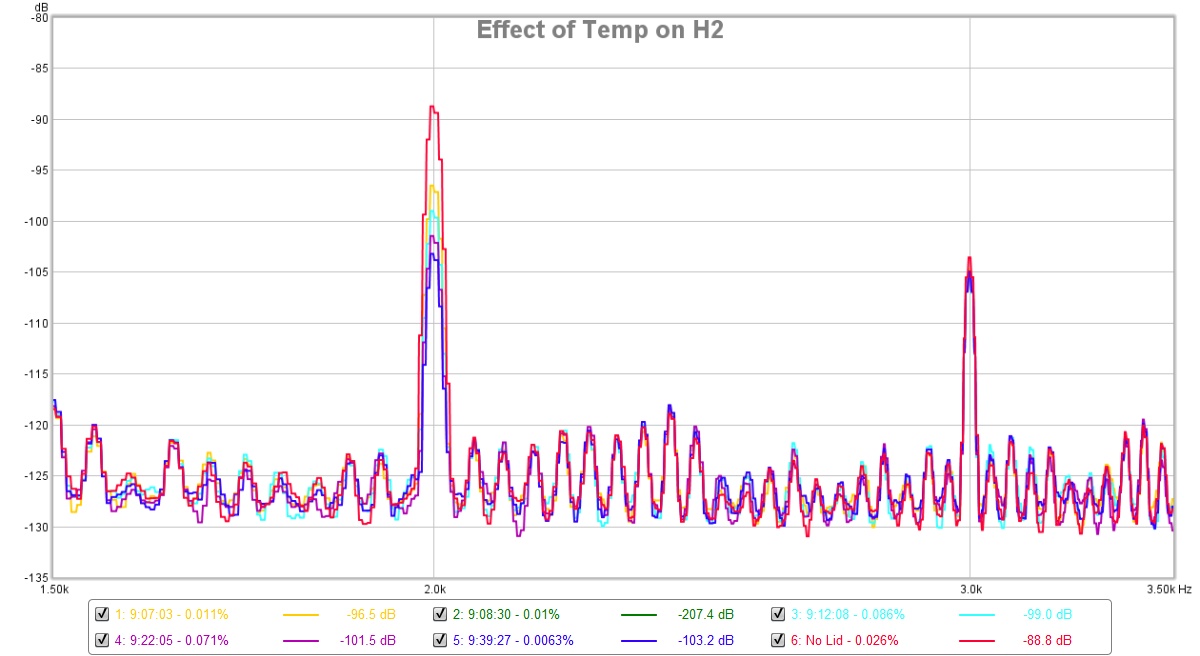

It's a temperature effect on probably the output 2SA1837 or maybe even the LTP? But I took several measurements over about 30 min after the lid wad replaced. The temp of the output BJT was 97C with cover on and 67C with cover off. It looks like only the second harmonic distortion is reduced at higher temperatures. Or it could be that temperatures inside the cover are more homogenized and the LTPs are closer together in temp. As they are not thermally bonded, they may have differences when the lid is off. It's definitely a thermal effect though. THD went from 0.026% with lid off to 0.0063% with it on. The relative balance of H2 and H3 will make it sound sweeter with the lid off and more analytical with lid on. Adjustment of the LTP degeneration resistor values and also the R9 (make 68k or even 50k) can raise relative level of H2 vs H3.

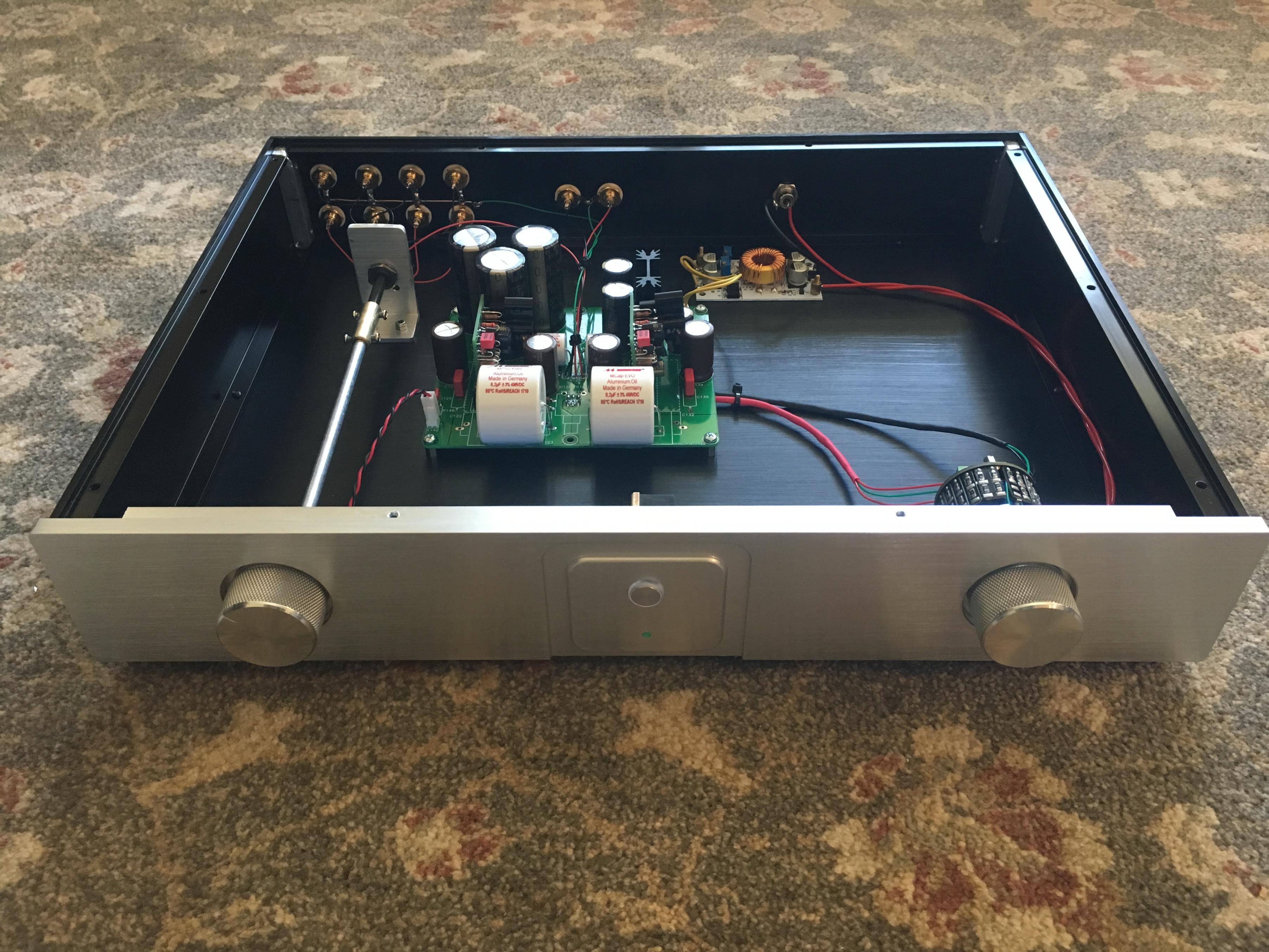

Brilliant work, Vunce!
You could easily put the preamp into a box three times smaller!
Nice use of a SMPS and elegant wiring on the selector and sources.
Some very serious caps in there.......
I never expected this preamp would be so good, but the drive on the voltage amp is very fast and I think it helps with the very low THD. XRK has championed this circuit and added his own versatility to it.
Thanks to XRK, J-P, and Vunce for making it reality.

Ok, you have uncovered one instability/dependancy, good work.It's a temperature effect.....

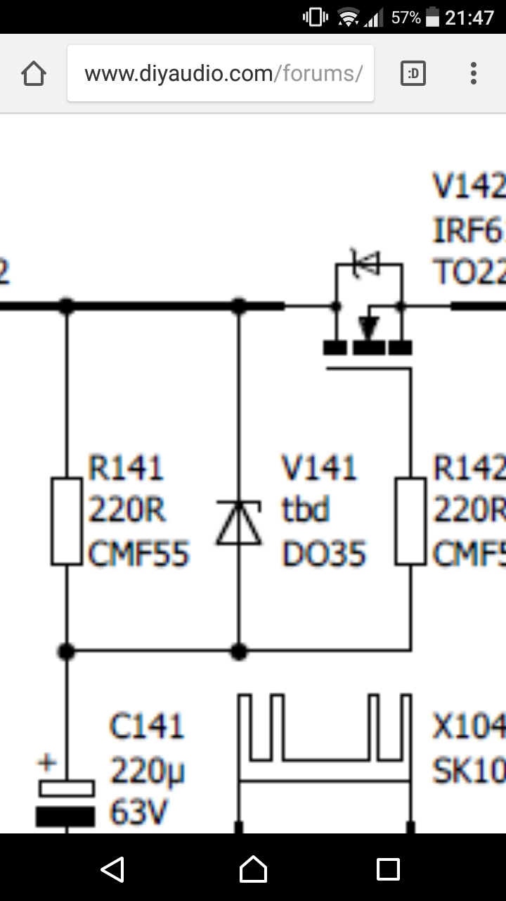

looking at the schematic I had a question - the cap mx portion has a zener in this design but not the DCA - why the difference?

There’s no zener on this design. Just a 1n400x like on DCA. Show me where there is a zener.

Thanks for catching that. It should not be a 20v avalanche diode, but a general purpose silicon 1n400x diode. Purpose is to protect MOSFET gate.
