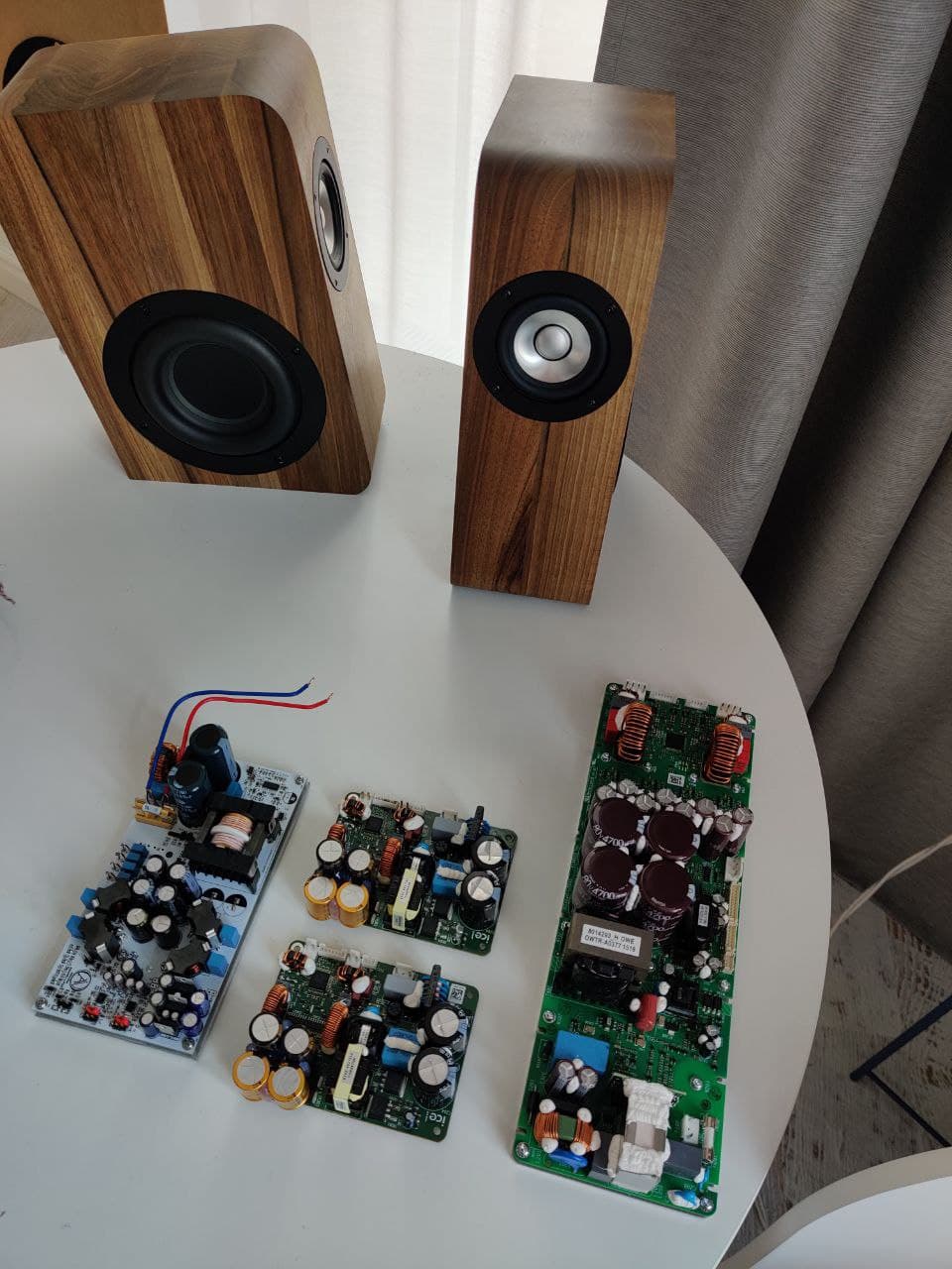

Hello everyone,
I got my amplifier from Vitaly. It was very interesting to compare it with what I had in stock - Icepower 1200as2 and 50ASX2 in bridging and some tweaks.
The main difference between Vitaly's amp is how much freer it is and less schematically it delivers music. For me personally, it is essential to make a choice in this context of comparison.
Thank you Vitaly and good luck in your new projects!

Hi, after how many hours did you start hearing the Vitaky amplifier well,
is it version 3?
The amplifier stayed with me for only 24 hours. Initially it was planned for a small project, which I did not do for myself.
I am sure that after a sufficient hour of burning, its sound signature will only improve itself. But even this short time was enough to form a positive impression in comparison.
