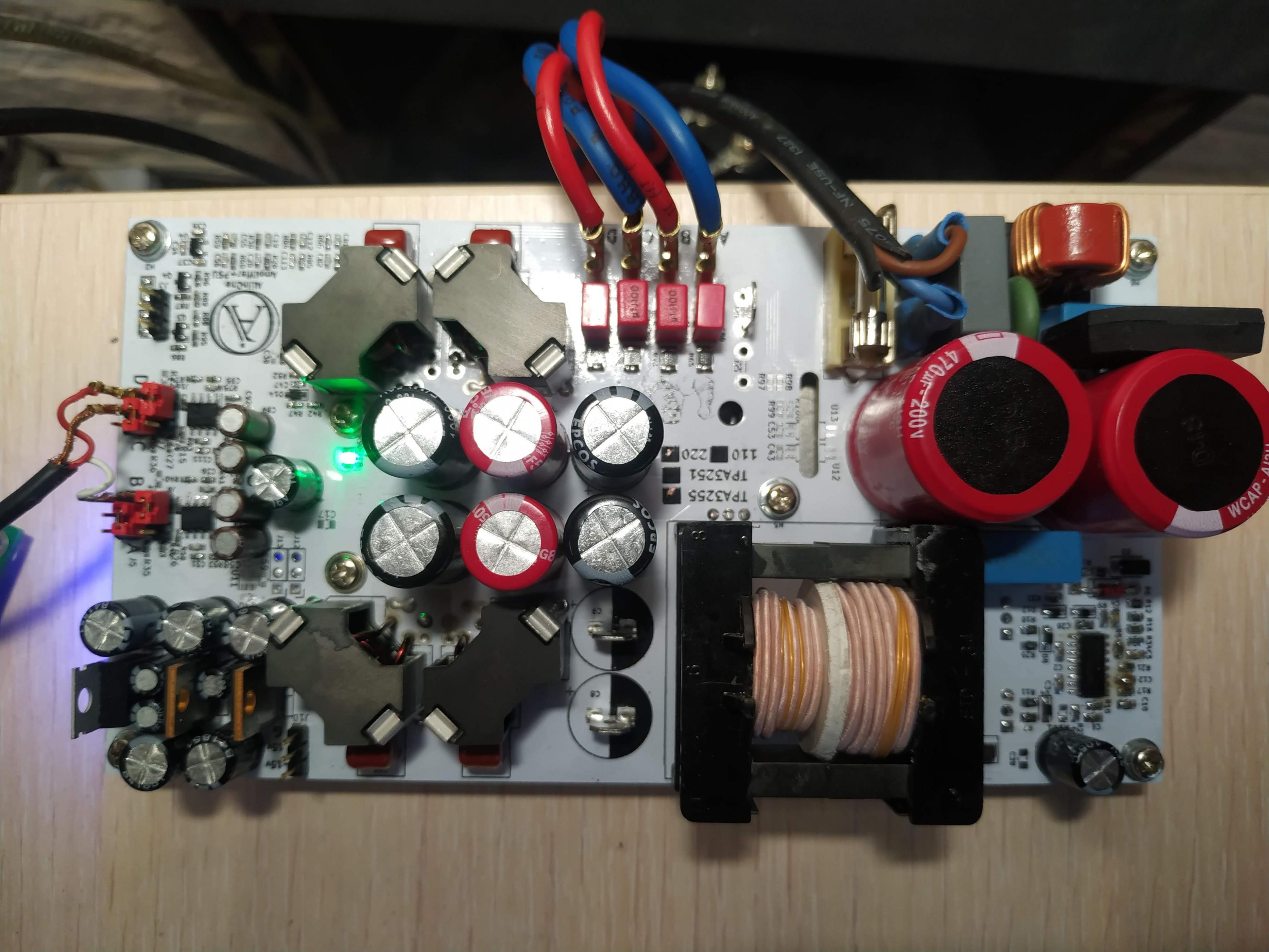

Hi, can it be set up in a 3 channel configuration? I need amps for 3-way active speakers, one amplifier board per speaker cabinet is the plan.
No problem, this amp have a 2.1 mode

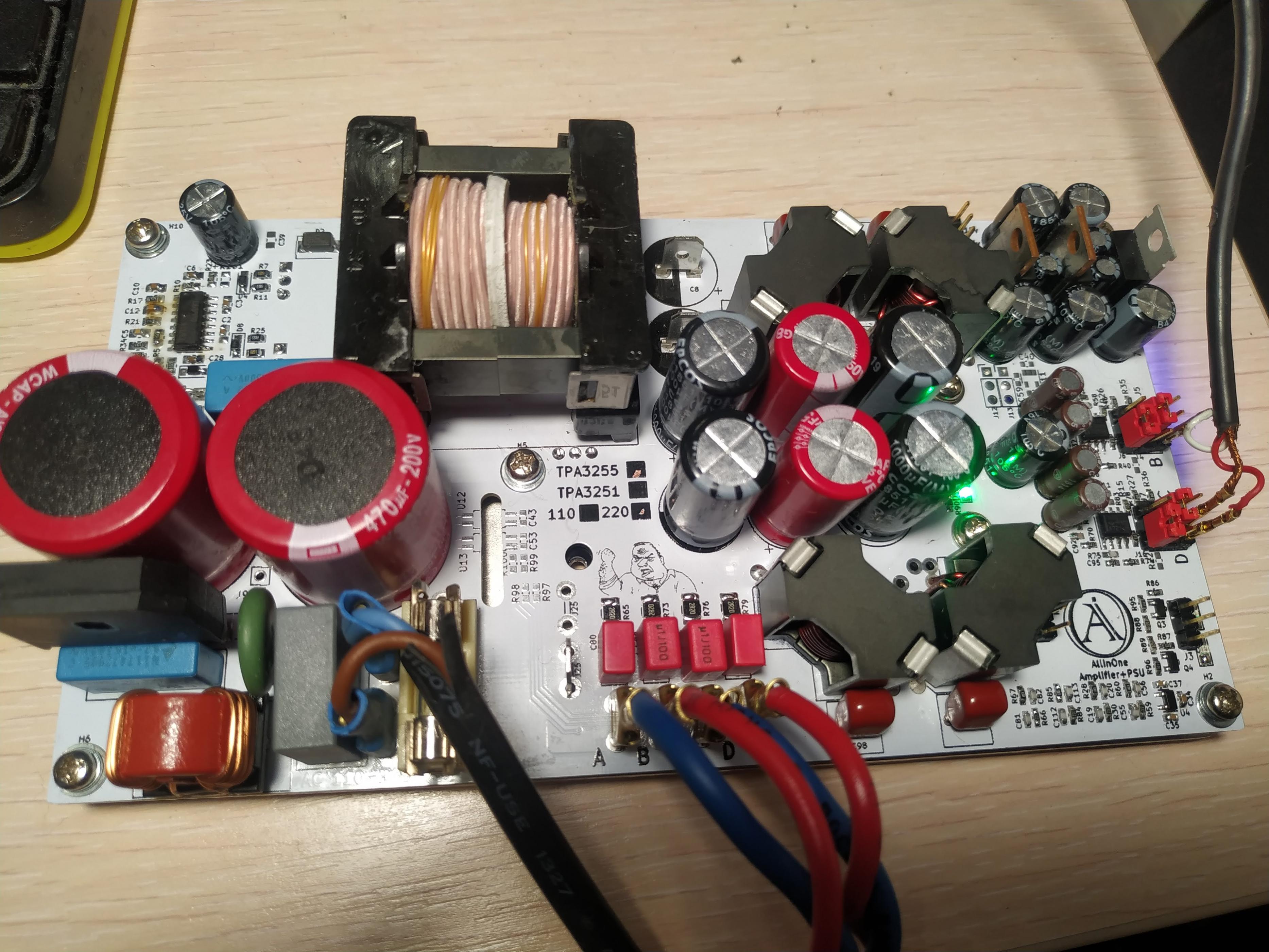

What inductors are you using and how much PFFB is in the implementation? Also, the unshielded transformer doesn't have any EMI effects on the amp portion of the circuit?
I tried to search for another thread with this but I couldn't find where you made your own threads before?
Inductor selfmade, based on TDK RM8 core.
The transformer emits only a gap, it is closed by a winding
Working frequency 110-145kHz

See page 5:
Approximately 6 to 7 dB of PFFB has been applied to each amplifier.

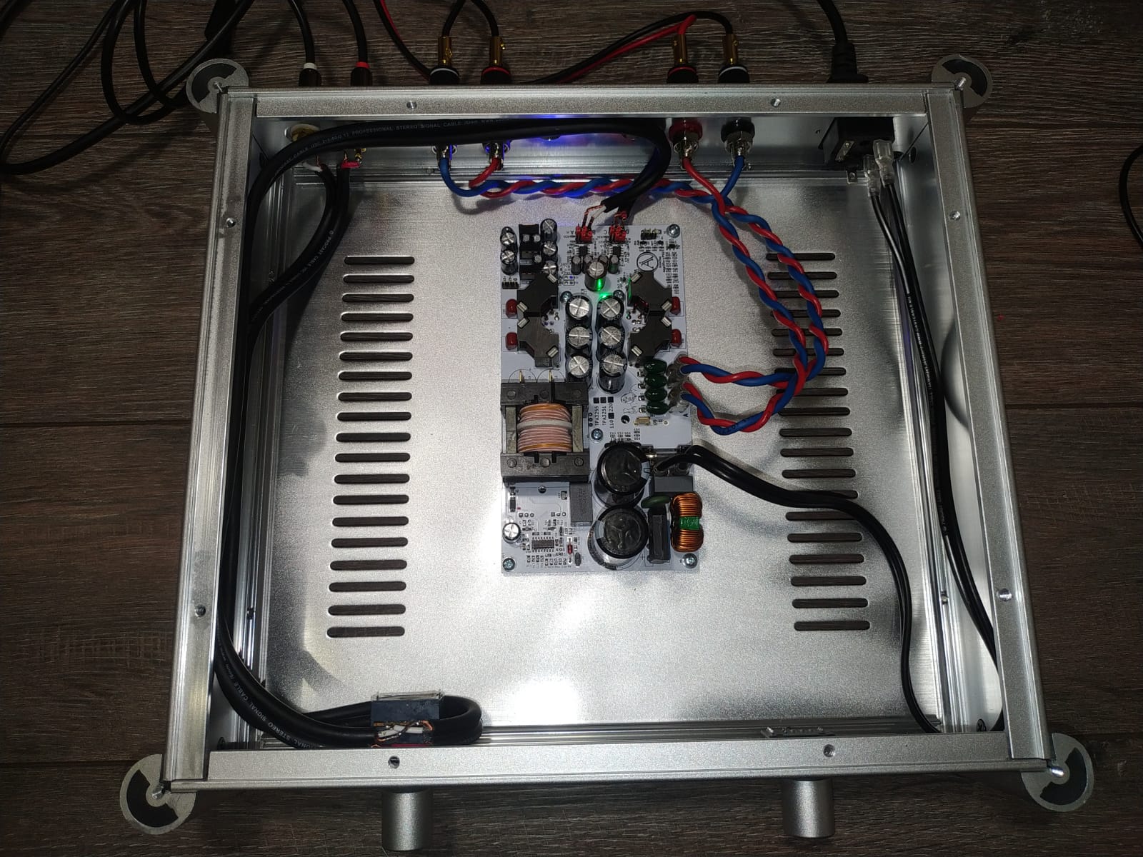

The case looks too big in photo. What size enclosure will it have?

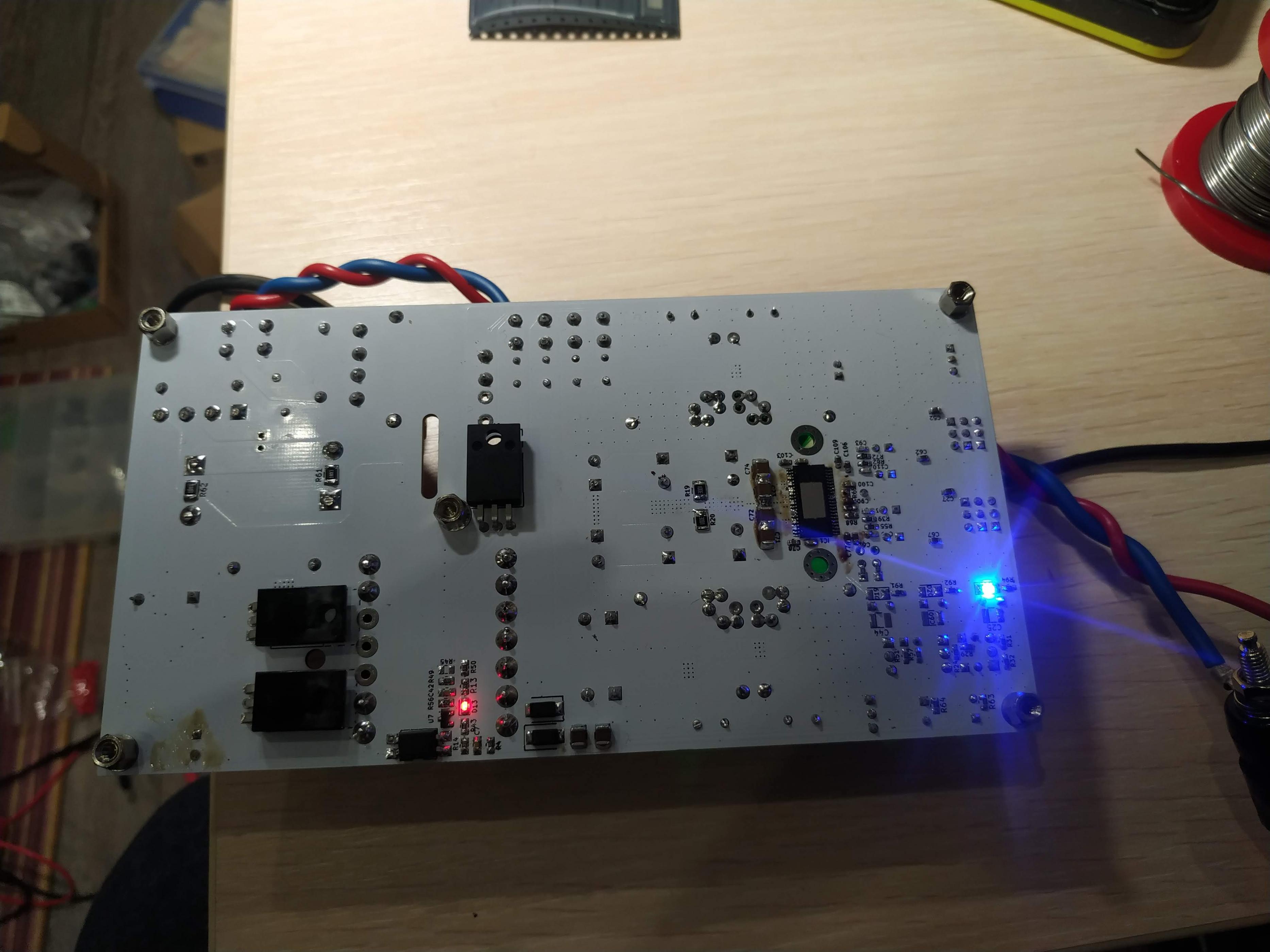

Where is the TPA3255 chip on the board? Heatsink?

0hm5law
No case.
TPA3255 and heatsink in bottom side.
If need 48V- i do 48, input AC 110-220V
I do socket for opamp and input connector before.
I'm sorry, i developed amp with PSU in one board
Amp have balanced and SE input
