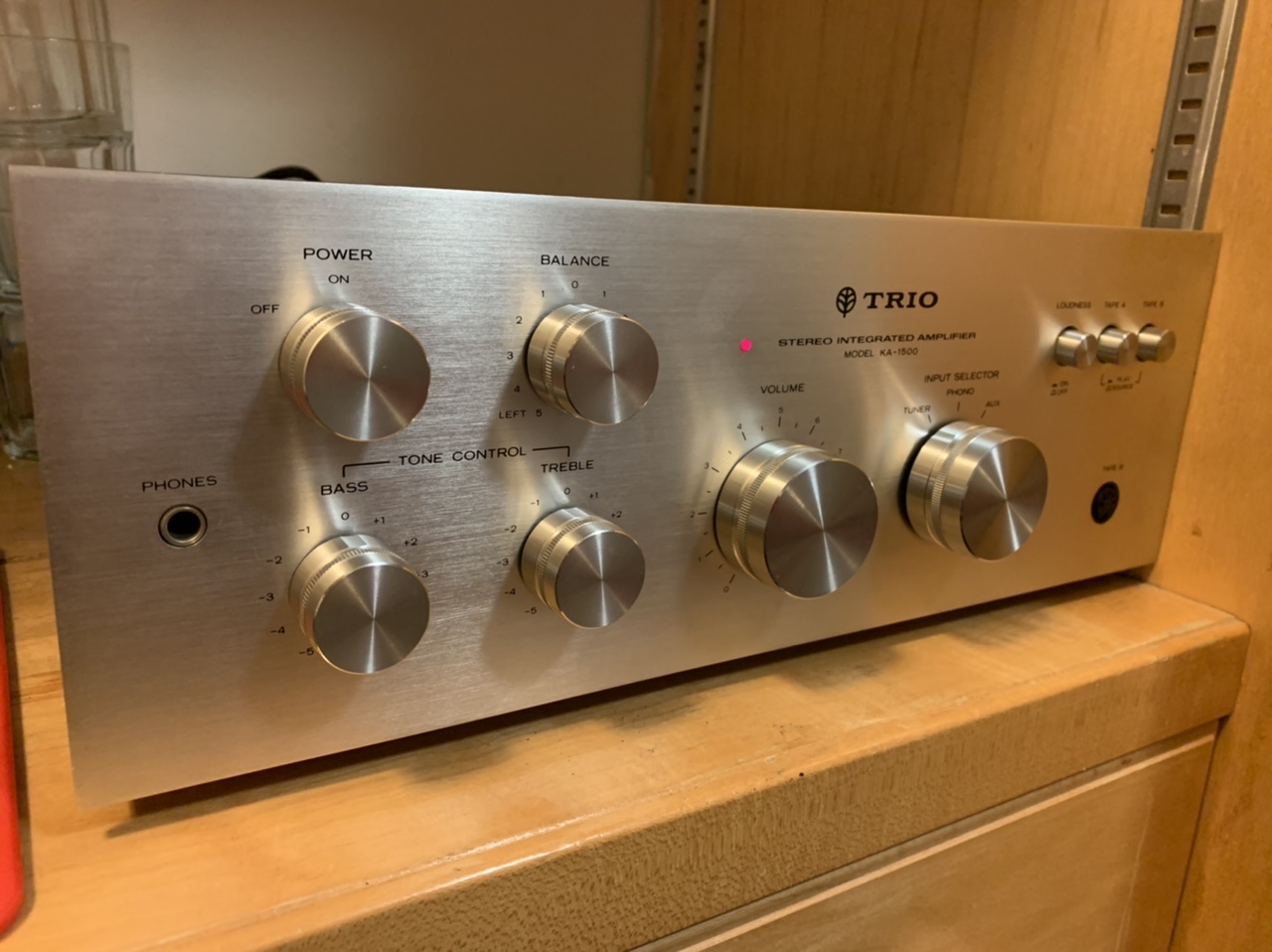

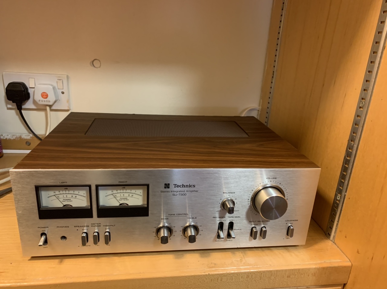

I have made 2 amps with old amps that had faults. My Technics has working VU meters. I only used the power switch, volume knob and input selector. It is VERY important to use a relay with the old power switch as it is not rated for a high current.
I am making a new front for my TEAC amp that will have 2 large VU meters for the AllInOne. I have also ordered a I2S balanced dac for it and found a 4 gang dact attenuator for the volume.
