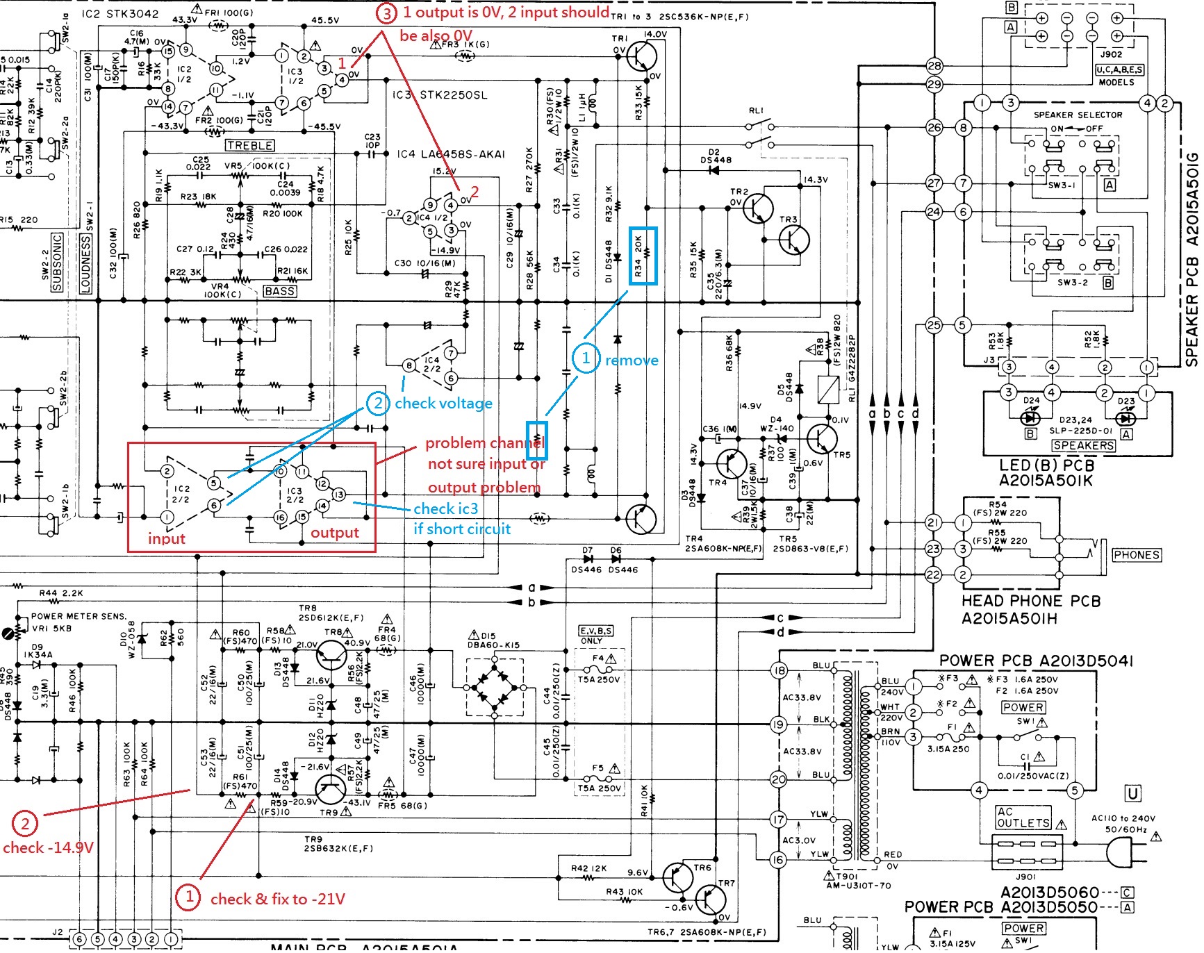

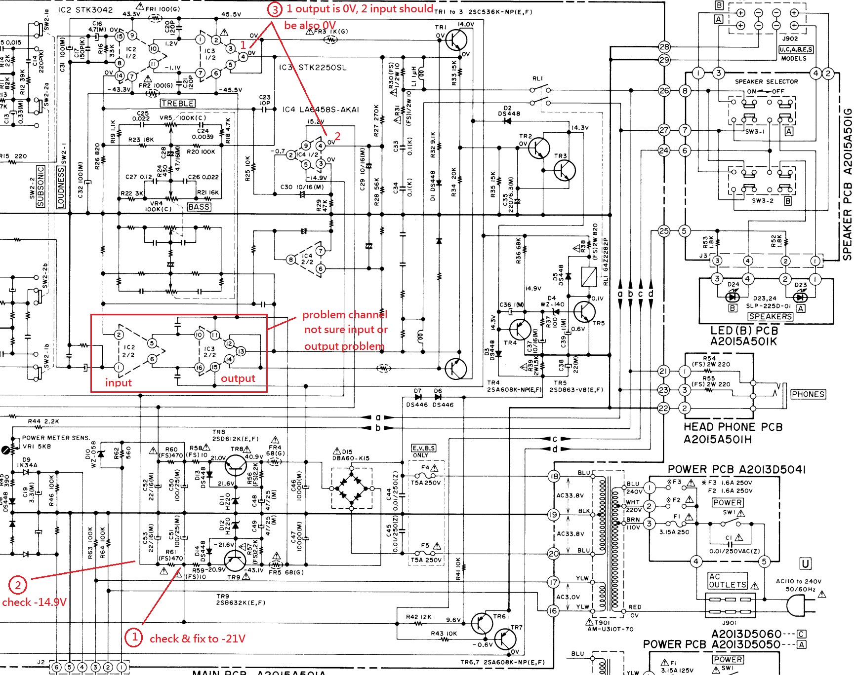

Many mistakes in the pins and voltage measure of transistor and ICs.
According to voltage, the right channel power amp has problem(not sure the input IC or the ouput IC or both ICs)

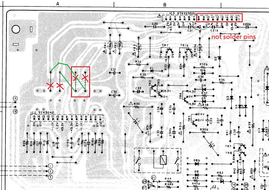

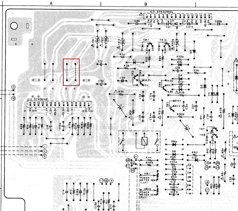

May remove the two jump wire from the PCB for the problem right channel to see if your amp can operate with left channel only.

Now for you notices form 3 to 1
3) ic3 pin 4 gave 0v
ic4 pin 4 gave 0v
2) ic4 pin5 gave -14.9v
1) tr9 emitter -21.1v

i've also remove the two wire jump wires but i didn't hear the click of the relay (RL1). and the measurement on ice on pins 10 to 14 gave -47v and for 15 to 16 gave 47v.

half IC3 possible short circuit and need to replace, unplug the power and measure IC3 pin 11 resistance values to pin 12, pin 10 and pin 16 to check if there is low resistance.
with 2 jumper still open, remove two resistors and turn on the amp to see if the relay will work and measure the IC2 and IC4 voltages

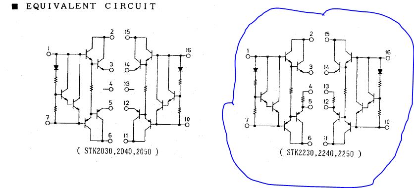

what i did is to take the stk2250 out of the circuit and to the measurements...

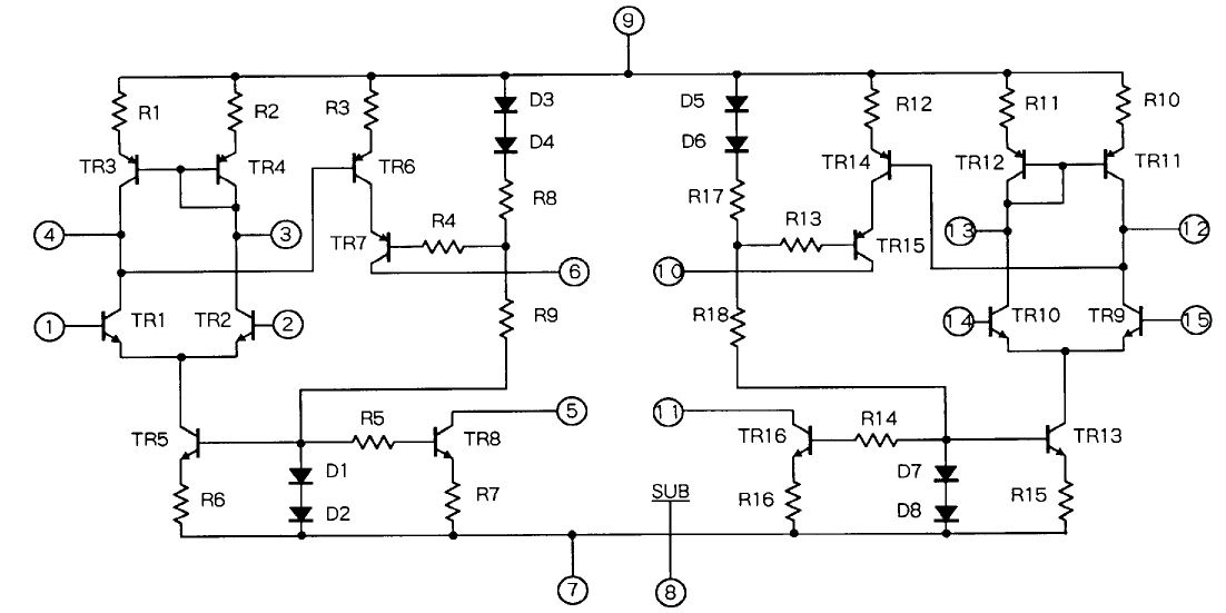

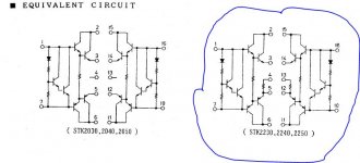

with multimeter in diode measurement i tried to face the pins as a single transistor... (see the pic) what i took was pins 16,15 shorted and 10,11,12 shorted in contrast with pins 1,2,3 and 7,5,6 which reacted as a single transistor.
Do i need to proceed in replacement of the stk 2250 or keep take measurements in case of other faulty part?
How possible is the stk 2250 to be burned without any other problem...
half stk 2250 is dead, you also need to test the input IC stk 3042 half channel ok or not, any short circuit or not. if stk 3042 is ok then replace the output stk 2250 should be ok

for the power ic stk 2250 pins 8-16, you can bend the pins forward or just cut them off and put back the PCB to test the other stk 3042 channel by remove old jumper and connect new jumper to test it, if stk 3042 all ok then you just need to replace the power ic stk 2250
if you can't find a stk 2250 ic, you can built it with discrete transistor, a simple 3 transistors and 3 resistors can built a channel

You were right! So i purchased the stk 2250 and changed it...
I have back my amplifier!!! 😀 :cheers: 😀
