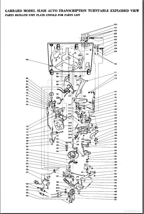

If you go to Vinyl Engine | The Home of the Turntable and register you can download the SM.
The pic above is poor quality, but the best I could manage with Print Screen and paste.
In the middle of the pic you will see a cam wheel (165) with two levers attached (164 and 163).
These levers seize (dead grease) and kill the auto operation.
Remove the cam wheel, remove the levers, (you may have to heat with a hair dryer) cleanse all old lube, refit and relube.
There is also a roller on the end of an arm that follows a groove in the cam wheel...same deal, cleanse and relube.
Also under the arm are levers (127, 128 and 133) that can seize due to dead grease.
The bottom line is that all old grease should be removed, and then relubed so that all parts are freely moving.

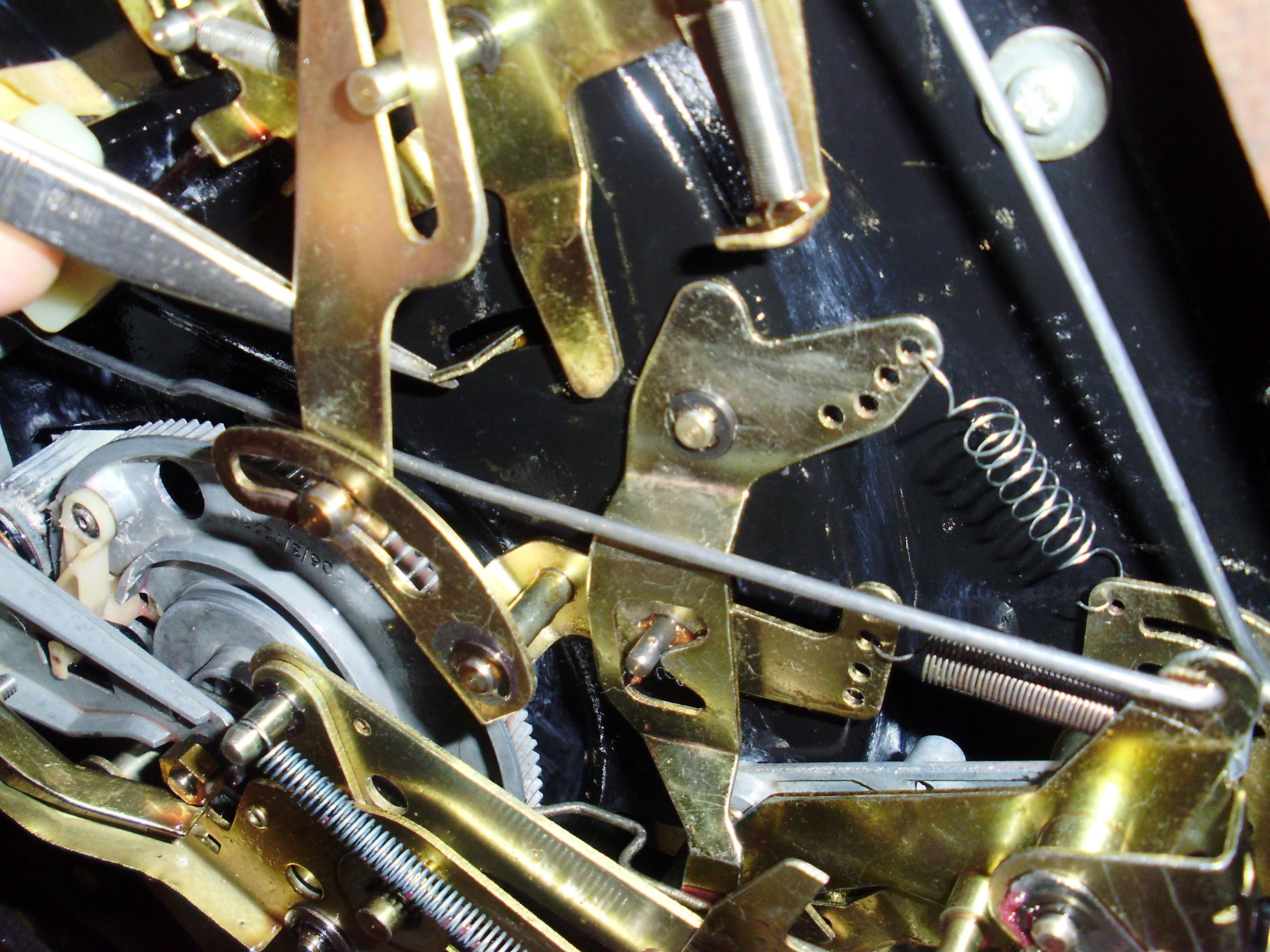

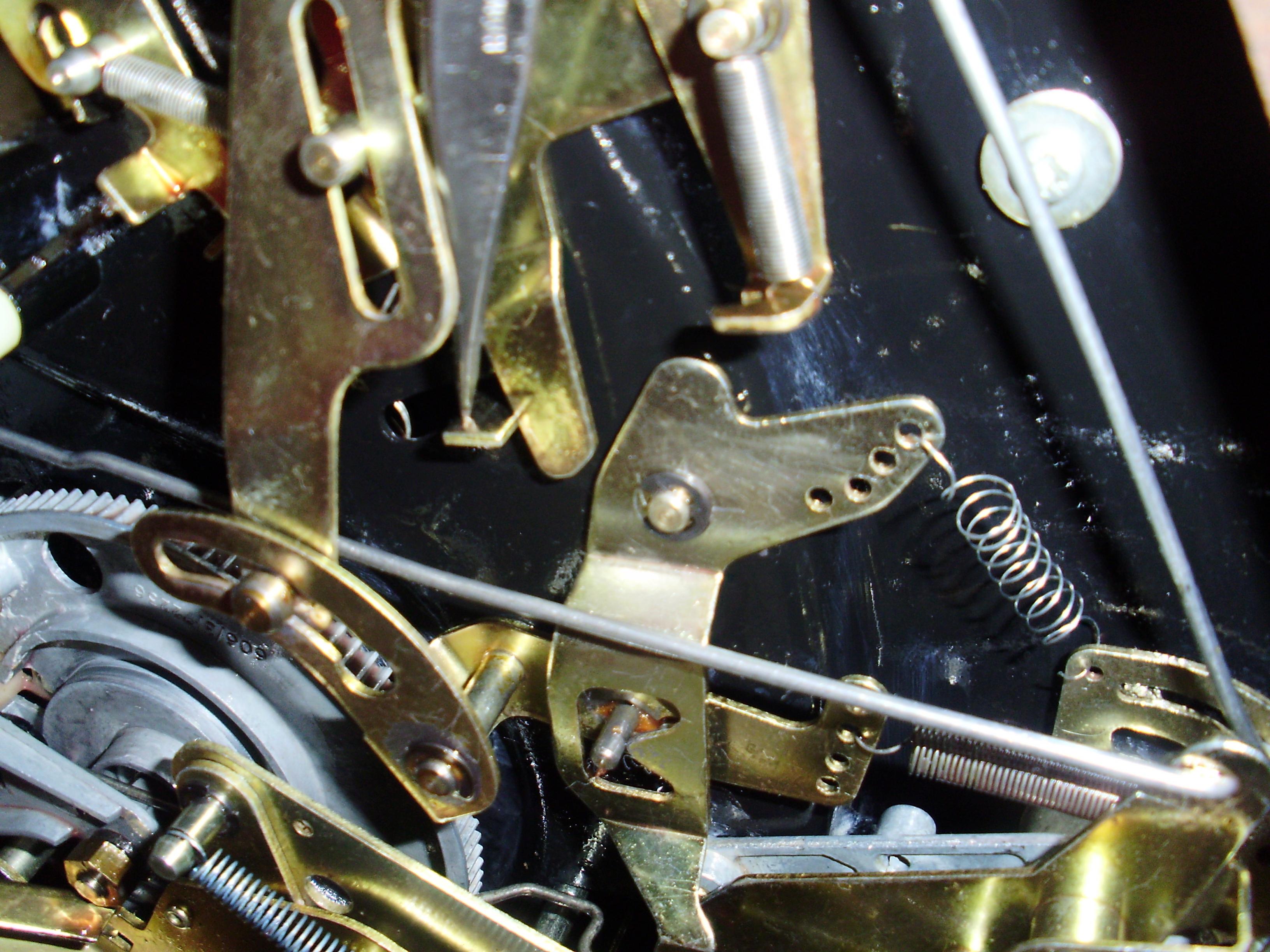

Yep...cue teh arm across teh platter, to end of record location, and let it return automatically, shuts off teh switch after the arm parks,,, Then in operating teh manual lever, the linkage won't lock switch on, as the switch lever, needs to move to teh left...Tweezers point to switch lever...
Pic 1 shows switch lever to Left
Pic 2 shows switch to right, as after auto mode stop... teh vertical lever touching it, doesn't seem to have enough travel to push it Left, so over center spring on switch lever can snap it to Left...
Clear as mud, I imagine!!!
All the involved linkage has been removed and polished...
I'll search for a thread of this TT, being run ... maybe I can see what it supposed to do,, The spring I replaced, will not let teh auto mode engage, when removed,,, I have yet to experiment with tensions...

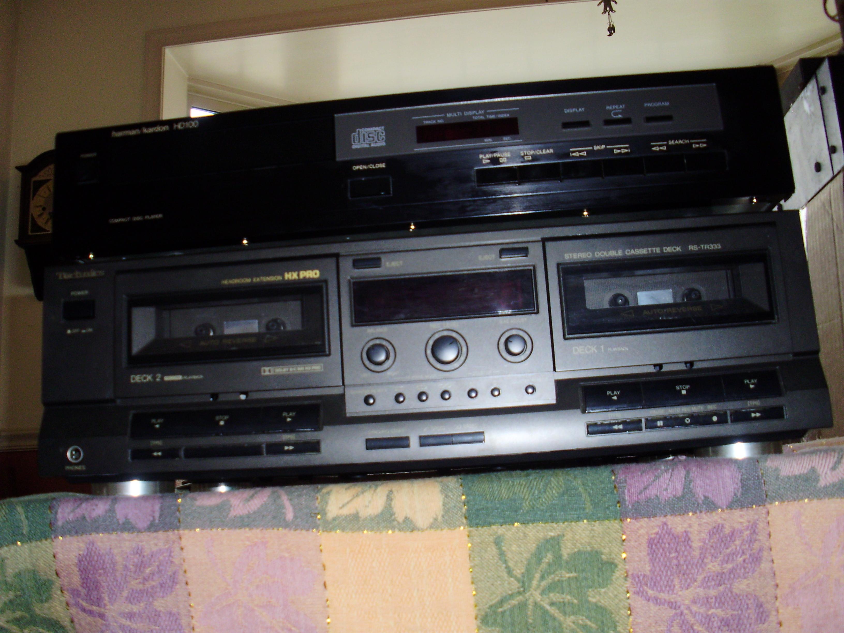

Got a few more CDP's and a cassette deck to "learn on" at an auction yesterday...HK HD100, Sony CDP C335, Technics RS TR333 deck,,, Also, lined up a scope, didn't pick it up yet tho...
Very addictive hobby!!!

A couple pics...
John
Hi John, you have the whole range of gear to play with now 😎 ....a few more lessons and you will be expert 😉.
I'm glad to help you learn this stuff, you choose the next project (after you have mastered the TT).
On the subject of the TT, the center spindles have differing ends, according to tall multi-play spindle, or the short single play spindle....IIRC, this influences the auto/manual mode operation...moves a mode select lever under the center of the mech IIRC.
Also, mis-operation occurs if the TT is not dead flat whilst manually spinning the platter.
