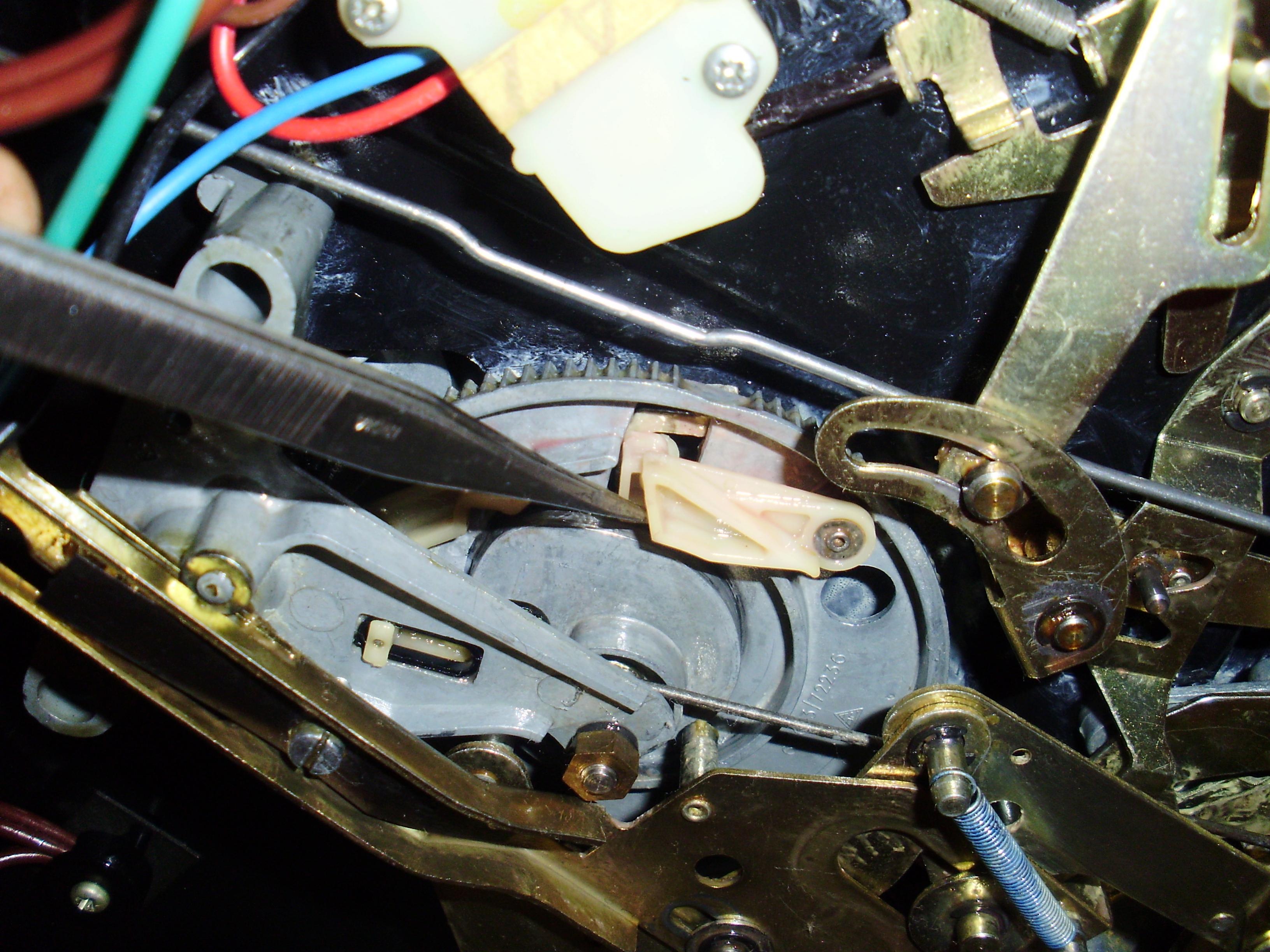

OK Back to where I left off...
1st Pic.... This plastic lever (164) seems to be too tight on teh rivet,, seems it should move more freely, so when auto lever is pulled, trip rod (143) can move it out of teh slot in nteh cam, and start the cycle... I can do it by hand, but the rod can't move it from teh auto play lever.... 143, can't seem to release 164, after the lst cycle...

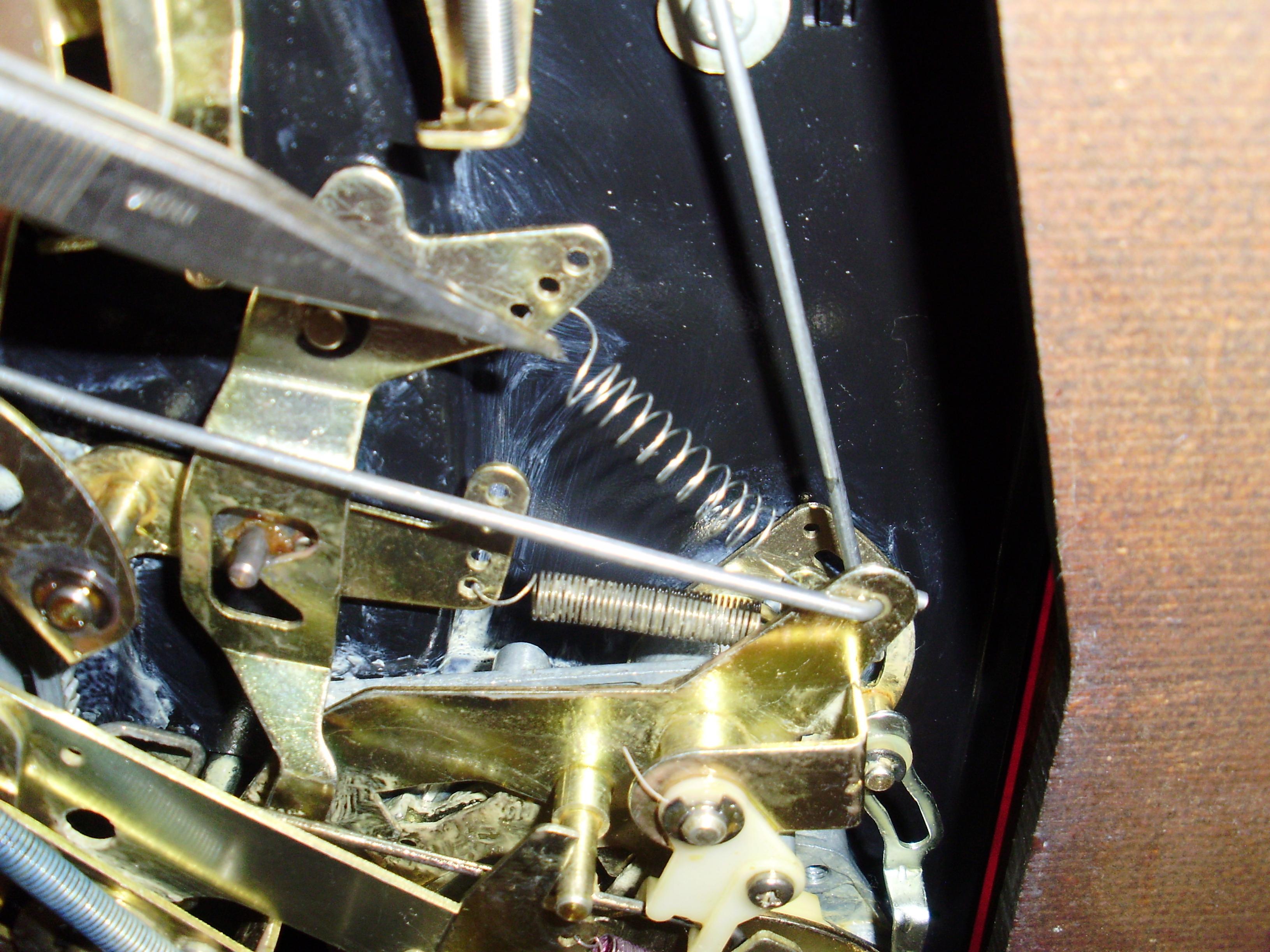

2nd Pic.... Spring (120) was missing, so I found/made a similar(??) spring and installed it in trip lever (118), and hooked teh other end i the wrong spot,, I now see, it should be on friction lever (133)...
It still doesn't work from teh auto lever, as 164, seems to be tight on the rivet, as I noted above...Not sure how loose it should be, or how to loosen it slightly without breaking it,,,
Thats the challange, in a nutshell,,, maybe the "new spring" isn't heavy enough, but it really seems like 164 is the main problem...

The levers on the diecast wheel should rotate perfectly freely.
Diecast (shite metal) has the nasty property of sucking the volatiles out of lubricants, and turning lubricants into stiff/sticky gum.
My method is to warm (not cook/melt) with a hair dryer and whilst applying solvent (isopropyl, metho, shellite etc) work the item a million or so times until the gummed up lubricant washes out.
Applying Dexron II and then solvent in cycles helps also.
Once this lever is running perfectly freely you ought to be good to go.
The spring you have fitted looks good...the original was pretty light weight (that's if it was actually missing ?)
The lever connected to your spring in the second pic needs to rotate perfectly freely also....all slides and pivots need to run perfectly freely.
You are nearly there 🙂.

164 is called "friction lever" on the parts list, and is riveted to the wheel, it does move, with a little pressure,,, The other lever on teh wheel, 163, is fastened with an E clip, and is spring loaded, it moves easily... I don't think either of those levers are the problem, because, when teh rod is pushed manually, it goes thru a complete cycle, and returns, ready for teh next start....
Problem I see is this,,,The auto start lever on top of the TT, only releases trip lever (118).... The only mechanical connection to push trip rod (143), is teh spring that was missing (121), I tried a few different springs, but none seem strong enough to push the rod to start the cycle ..... I'll try the heating/lubing fix, and try to loosen the riveted lever,,,and report back..

PS: Yes, the spring was missing,,, I fitted one last time I worked on it, but didn't think it was heavy enough...

Freed up the lever with a little heat,, works a little better, intermittently,,still need to sort out the spring tension for the one I fitted, I think... we're getting there...
I'll fit a cartridge and see about dialing bit in a little closer,,,

From memory I think the riveted lever should be perfectly free, but damped with a little grease.
Diecast metal can also change dimension slightly (swell) in addition to causing grease to turn to stiff, dry wax.

I'm thinking I may have a problem with teh spring I replaced, as I don't know how much tension it should have,,, I found a link to the same problem, but with a Zero 100 TT,,, always starting at 7", I'll study that and see if I can apply it to mine,,, There is obviously something I'm missing, as all teh rods and levers seem very free...
