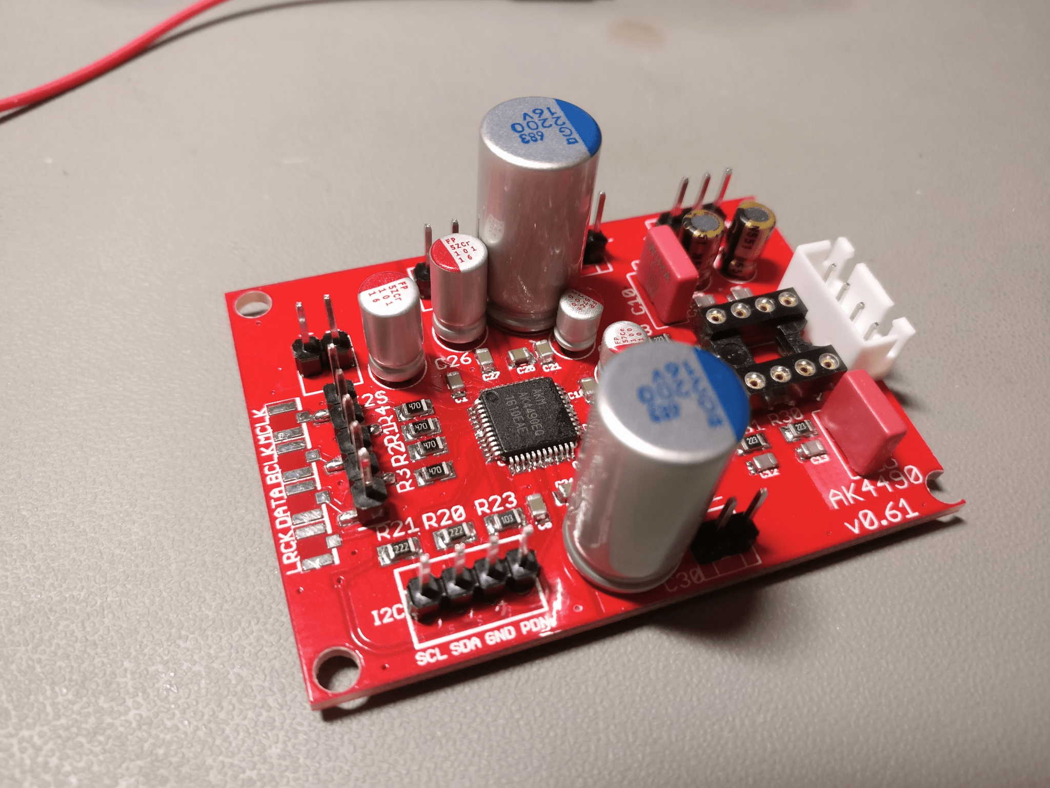

For example, regarding AKM dacs, I started with this little AK4490 proof of concept board:

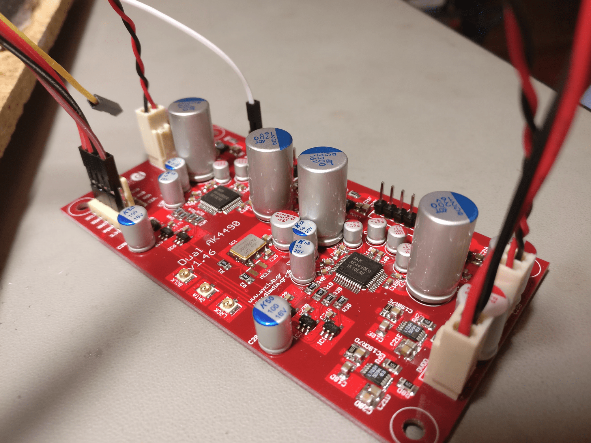

moved up to a dual AK4490:

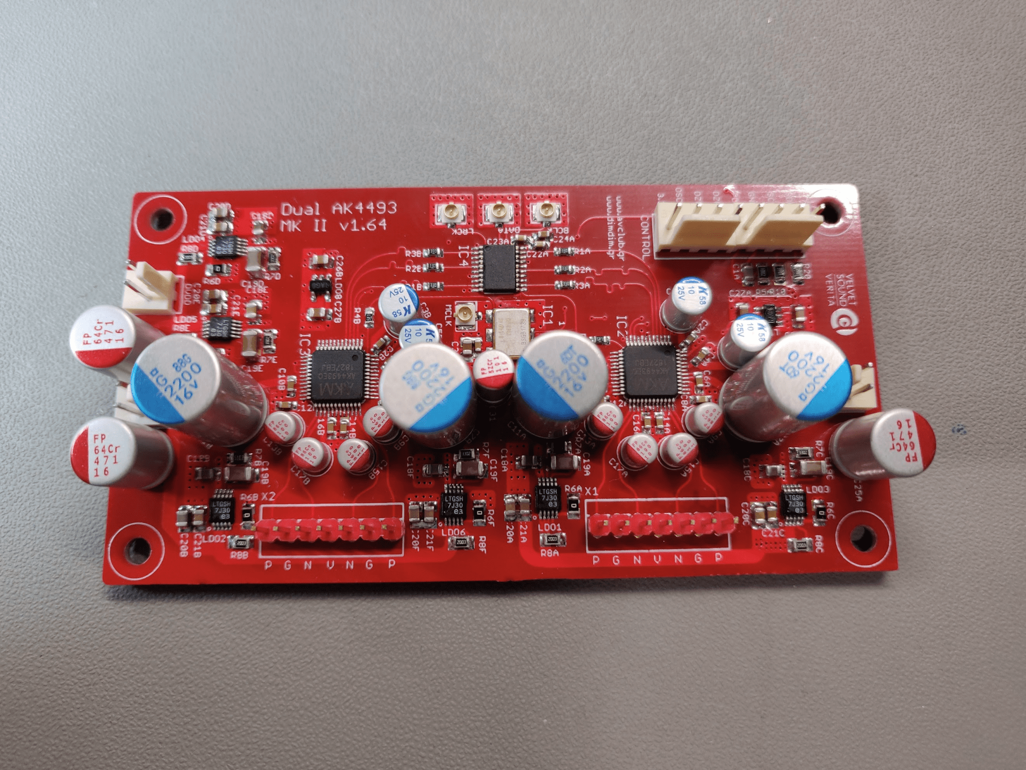

..then on to a dual AK4493:

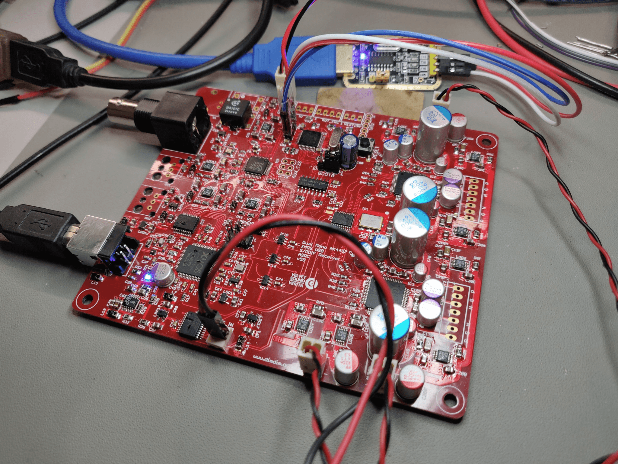

..then on to a dual AK4497 with integrated XMOS and S/PDIF receivers, as well as the controller:

But each iteration has taught me quite a lot.
