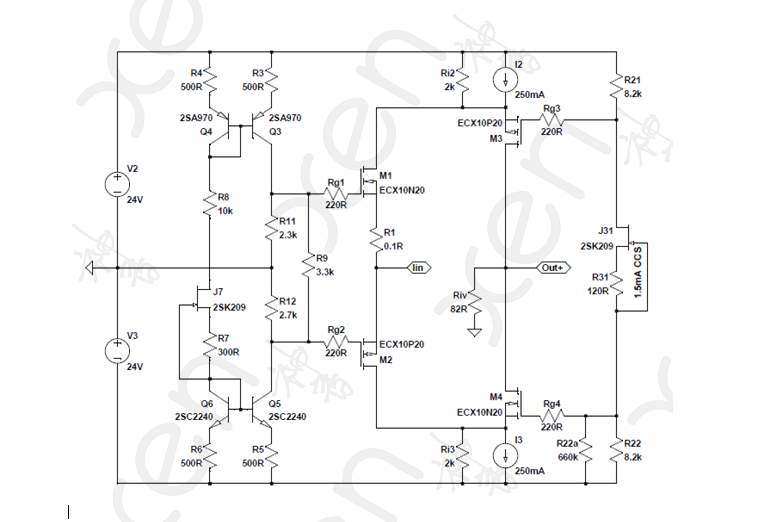

Do you know of any Zen I/V implementiation that might suit the AK4499?

The I/V stage opamp for the 4499 needs to be comfortable driving low impedance loads whilst swinging significant voltage too. It needs to be able to source/sink the output current of the DAC whilst doing so linearly. There are plenty of opamps that have a short circuit current delivery way beyond the output current of the ak4499 but they start to show nonlinear current delivery way before getting near that. Capacitive load drive is also important.
Ultra low noise isn't as important as you'd think. Each half of the differential signal needs to be around 2.3uVRMS with respect to the 4.65VRMS to hit the 126dB non A weighted SnR figure (129dB differentially) with a 20-20kHz bandwidth. The OPA1611 would contribute only 0.43uVRMS to this figure so other factors dominate here. Of course a noisier opamp will degrade things but probably not by as much as you might assume. The OPA1622 would be interesting to try although only for lower distortion due to its ability to deliver loads of current and handle capacitive loads easily. If the 4499 is already the limiting factor with respect to distortion, when using the 1611, then going to the 1622 would only do one thing. Make it noisier whilst giving you nothing in return.
This is an interesting question.
Most (IMHO) good-sounding discrete IVs like the Zen IV use some form of current steering and without global negative feedback.
And they also mostly work in pure Class A.
With a differential signal current of 73mA p-p, One would need a bias of 150mA or more for the input stage alone.
And assuming that we want to have good PSSR and no coupling caps, we would need to use a cascode on top.
Something like the Loesch IV circuit published quite a while ago.
Zen -> Cen -> Sen, evolution of a minimalistic IV Converter
For DC offset & bias stability, one would also want to use devices with negative tempco, e.g. lateral power MOSFETs for audio.
So here is one example of such a circuit.
I did not put in an additional buffer as Zout is very low at 82R for line level.
The key to low distortion are the two 250mA current sources.
They want to be DC stable (or at least track each other) to < 0.1mA.
And the dynamic impedance should be higher than 2k.
Not sure whether I want to burn 50W for two channels of balanced IV.
But that would be the price with such high output currents.
Patrick
