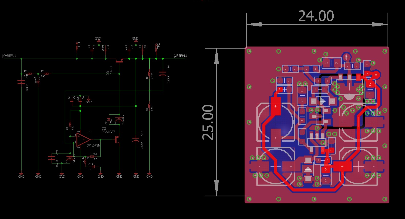

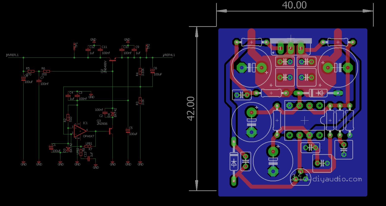

Opamp wiring looks basically right. No offset pot is needed. Don't know if you have zener symbol for the diodes that could use it.
Regarding circuit operation:
Basically, there is a pass transistor that is biased on from filtered input voltage. An opamp can steal the transistor base bias and turn it more towards off. A zener is in series with the opamp output so that the output is offset lower and doesn't risk hitting its upper voltage limit.
The regulated output voltage passes through a voltage divider with speedup cap and is returned to the opamp inverting input for comparison with a zener reference at the non-inverting input. The zener reference and the opamp Vcc are powered from the regulated DC output.
Does that help explain operation? If not, please ask any questions you want.

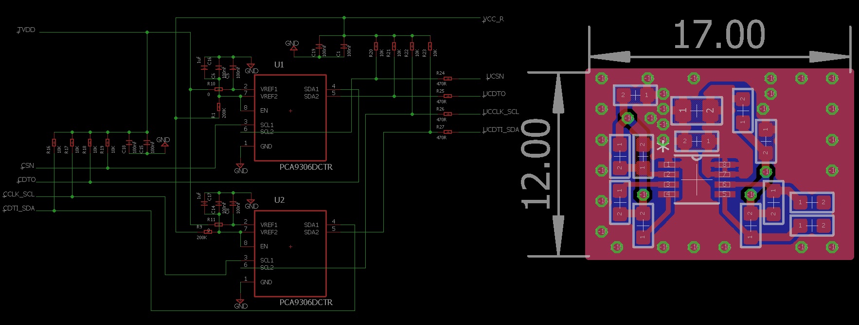

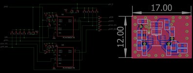

sry cant edit last post, here is isolator part of pcb, well half of isolator but other half same.
edited picture, sry for messy schematics.
also few questions.. please confirm, are diodes on VREF part supposed to be Zener or Schottky?
also is there reason that bypass caps on ISOLATOR part is before 200K resistor on VCC_R.
...here is isolator part of pcb...
Pic is illegible.
The forum software will reduce picture resolution if file is 1MB or larger. If smaller than 1MB forum may or may not reduce resolution, but more likely that the pic will be left intact.
The diodes are actually placed on the analogue supply pins, Vdd/Vss, not Vred, but the question about the Zener or Schottky confuses me too. The datasheet mentions placing Zeners at this location to breakdown if the supply voltage exceeds the breakdown and protecting the device.
Placing a Schottky here isn't going to accomplish the same task. The device will conduct if the negative supply voltage goes higher than the Vdd supply voltage, so essentially protects against reverse polarity on the Vdd pins.
