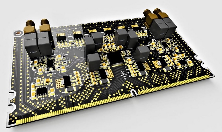

have not read whole thread but if i understand correctly you dont have time to do pcb.if eagle cad is option i could do pcb work for you in my spare time, even finish schematics if needed.
my issue is i have time to design pcb-s yet no money to test all of them, also i make mistakes as i am no professional.
attached is picture of 2 channel adc pcb that i never made with akm-s 5397 ADC with bit overkill regulation that i wanted to connect to "motherboard" that would contain power/mcu, my idea was to make it like this using ddr2 connector so i can prototype easy each part separately, dac/adc/mcu... if interested just say i would love to design pcb that people would actualy use.
