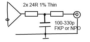

Probably the same reason Topping and SMSL use analog switch ICs instead of discrete transistors: Better linearity with the ICs.
Much better to use a relay with NC contacts to short the output.
Relay quality is not important because in "play" mode it's contacts are open.

You found this out when you switched from being an audiophile to a non-audiophile?You just have to think like an engineer and not an audiophile.
but there are bipolar transistors specially designed for this task.
Yes, usually used in reverse polarity.
And the first thing that “tweakers” often do is to remove these mute transistors from the board.
Alex.
It doesn't have to be reliable? Have low contact resistance when shorted?Relay quality is not important...
Reliable - of course, but all relays are enough reliable at so small current.
Low contact resistance? Sure, but all relays have enough low resistance to do this job.
I use small signal relays from Panasonic(NaIS), Takamisawa, NEC, Omron, because they are small and not expensive.
I mean - these relays don't have to be "audiophile quality" 🙂

Nonlinear contact resistance at low current density can still let some garbage get to the analog outputs?
Some of the the ones with gold-flashed contacts over silver are reasonably priced, at least seems reasonable to me.

Maybe. But only at "Off condition", where there is no sound.Nonlinear contact resistance at low current density can still let some garbage get to the analog outputs?
These relays has ~140mW heat from coil, about what you are talking?Actually, relay life can be impacted by heat from the coil.
Yes, very expensive: NEC UD2 at AliExpress are ~$6.50 for 5pcs, including the shipping to USA.
Long-term, Continuous ON Contacts • Using the Relay in a circuit where the Relay will be ON continuously for long periods (rather than switching) can lead to unstable contacts because the heat generated by the coil itself will affect the insulation and can cause a film to develop on the contact surfaces. We recommend using a latching relay (magnetic-holding relay) in this kind of circuit. If a single-side stable model must be used in this kind of circuit, we recommend adding fail-safe circuits in case the contact fails or the coil burns out....about what you are talking?
Quote from https://omronfs.omron.com/en_US/ecb/products/pdf/en-g6k_2f_rf.pdf
This might happened at high ambient temperature.
In fact, I have not encountered or even heard of such a problem in this application (output mute).

Yes - best solution is acc to Altor - a short circuit of output by a ON relay which is lifted when output is wanted and thus nothing in series in the signal path. Hopefully the circuit before the short can endure for longer period - perhaps a resistor is needed to limit current but this might let som dirt pass?

Since relay circuits have been mentioned, are there any that I could implement with this DAC?
So 24R on both + and - (earth if SE) output and the cap across, after the R?I always use RCR "T-circuit" at any OP output, going outside.
24R+100pF+24R.
Alex.

A bipolar transistor specially designed for this task (I will not specify the type) used for muting by short-circuiting the output will be in OFF state in normal operation mode and will present a load of the line only with a capacity compared to GND. This capacity, in the case of the transistor I'm talking about, is specified to be a little over 10pF at under 0.5V voltage and drops to 4pF at 20V. For the normal range of use (0-> ±2V) the capacity variation is only 3-4pF.
Compare this capacity with that presented by a small signal cable that will have a capacity between 50pF and maybe even over 300pF, that is between at least 10 times higher and over 100 times higher. Even only the PCB will be able to present a higher parasitic capacity than this transistor.

If you have a circuit idea, why dont you show a schematic? The thread starter even asked for solutions.
Saying A but not B will not grant you any points.

Because 0.1% are mostly used thin film resistors, but 1% are also enough at this place.
Alex.
P.S. There are lot of places in DACs, where <1% resistor are highly recommended, but capacitors are also should be 1% (differential LPF).
