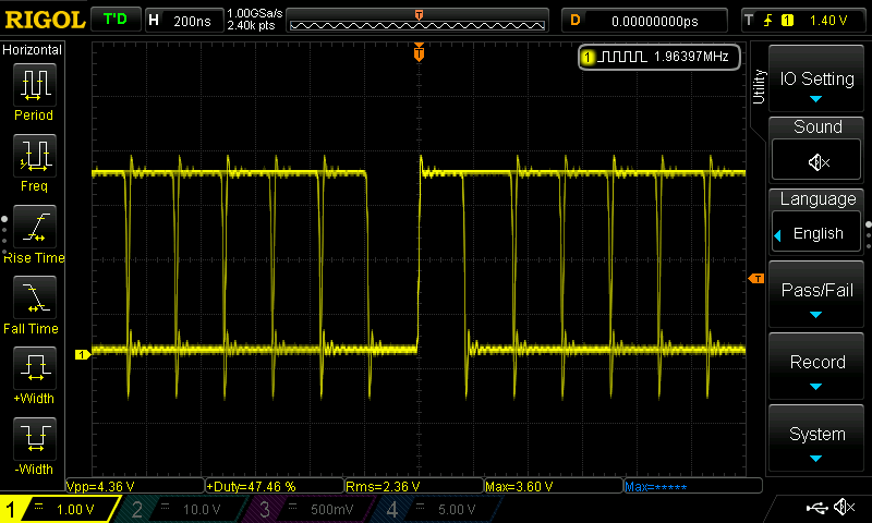

After building this circuit I'm having issues getting DIR9001 to output data. The error pin is always high. With CKSEL disconnected from ERROR, the clocks are ok but there's no data. The signal from the picture is the input on the RXIN pin, is it a good SPDIF signal?
Could be SPDIF. Can't tell for sure. Looks like scope is retriggering so you have more than one sweep superimposed. Also, probe ground may be causing some ringing. To know if its SPDIF would require a single sweep capture of enough data to then decode it. If you scope doesn't support that, then the best way is probably to try a different SPDIF receiver. Do you have any other dac or other device with a SPDIF input?
