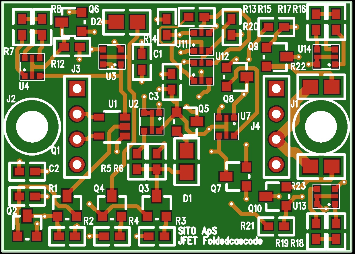

Discrete opamp for new outputshield
We have just ordered the discrete opamp modules for the balanced shield.
The opamp if 35x25mm in size even though the pinout is identical to standard single opamps, the row spacing does not match. Simply .. it draws to much current to replace any opamp. It is drawing 30mA, so i decided not to cramp it down.
Row spacing is 20mm.
Mountinghole spacing is 29mm.
It is an JFET folded cascode design with very low distortion. See it as an AD797 seasoned with jfet's (the salt).

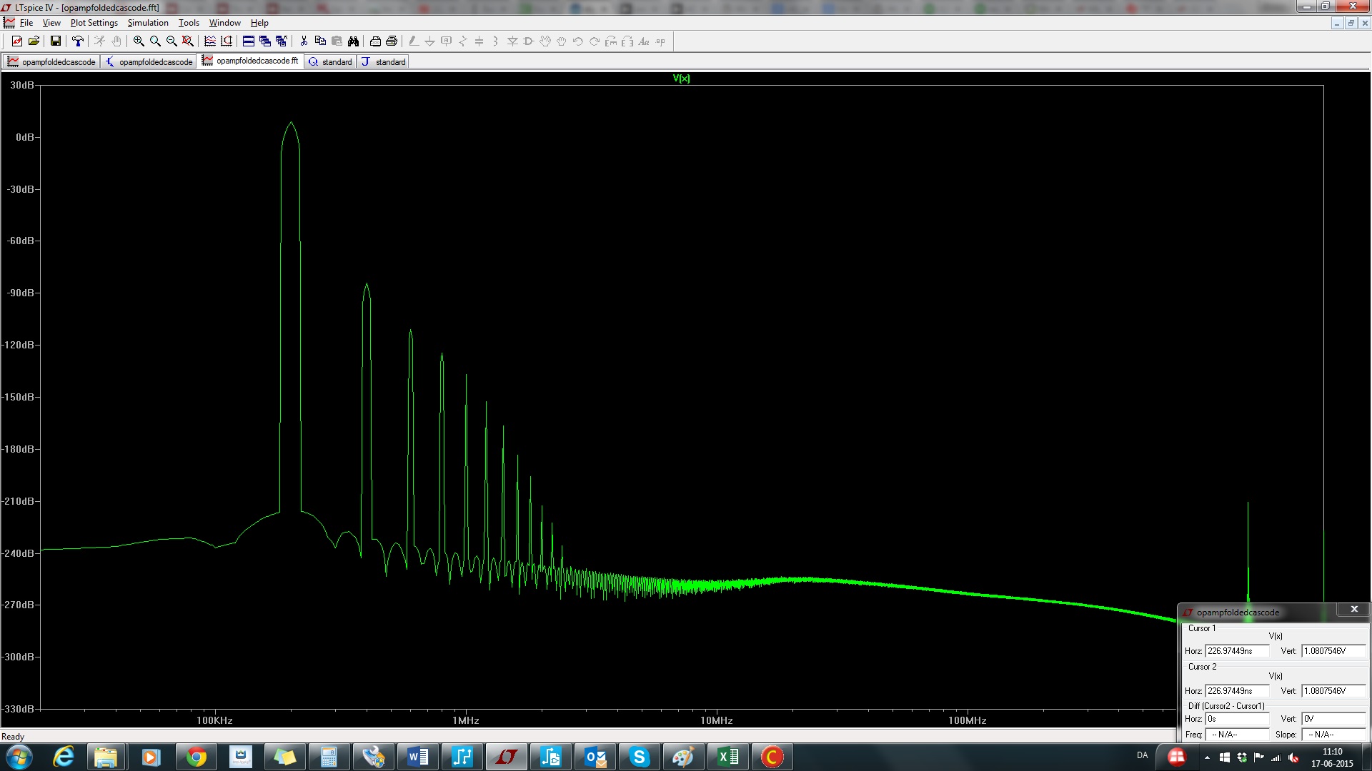

Simulated distortion with 2 x gain is 0.002231% @ 200KHz, 8Vpp, 10kload, feedback resistors 2K,2K.
under same condition 0.000120% @ 10KHz
The opamps them self will cost 50€.
But the shield with 4 x of the opamps will cost 166€
How many active parts? 24 bjt's,4 jfets, 2 leds.
