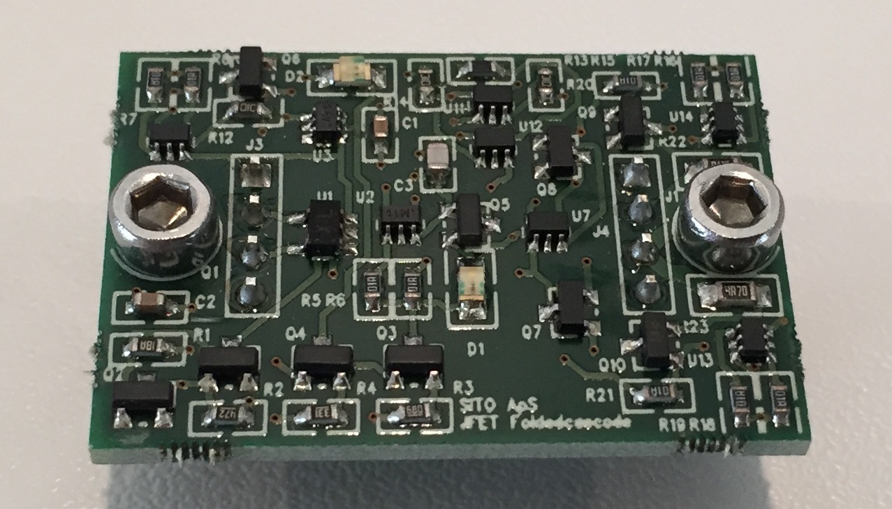

Hello, i am back.
Just some update on the shield. The opamp modules are assembled..
As you all can see it is very compact.
It is true folded cascode, with jfet input pair 2SK2145-BL.
It runs from around +/-15VDC
But at is right now. I have started on the shield layout with the use of my opamp modules. I will upload info this evening.
But i have also two frontpanels on completion.
  • One with LED for source format, and one filter select button. Very simpel.
  • One with OLED display, buttons and IR input.
After the shield i will shortly after make the preamp sections using the discrete opamps.

Jfet folded cascode amp measurements.
We have measured on the discrete opamp. Normally folded cascode does not have high open loop gain, but we managed to pull out and THD+N of close to -110dB with 2x gain (2K + 2K) and 4Vpp at 1KHz.
DC offset is only a few mV.
See the FFT signal i have attached. Below 1KHz there is some pins but it is 50Hz and harmonics of it.
BR Sonny

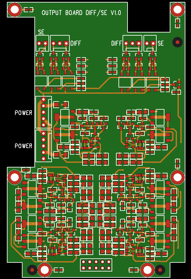

OUTPUT Shield DIFF/SE V1.0 Discrete
Hi.
Just an update.
The Shield takes form now. It is an 4 layer board. Each opamp uses around 40mA. So this board need +/-15V and 300mA (The optocouples uses a bit 😉 )
The board has the same size as the DAC mainboard.
There is no relay on this one. It is replaces by SSR with very low RDS on and very low QR for minimal insertion loss of sound quality. Less than with relay, and no clicking as well...
It is laid out now, so we need to route it and put it into production.
The opamps are identical to the ones used in the TSSA V2/V4 and V8 control which works very well.
>220 components on this one! 😀
BR
Sonny

OUTPUT Shield DIFF/SE V1.0 Discrete done!
Hi, The new output shield is now done.
It will be ready to ship within 2 weeks.
The shield alone will cost 167,5€ + shipping.
An combo pack with the USB DAC mainboard 326€ + shipping.
Early bird on this one is:
The shield alone will cost 147,5€ + shipping.
An combo pack with the USB DAC mainboard 306€ + shipping.
It is fully discrete. 71x110mm
Filter components is thin film resistors in 0805 layout 0.1% 25ppm and capacitors is PPS also in 0805 and 2%
And output relay is replaced by ultra low distortion SSR switches.
The odd shape is because of USB and connectors on the mainboard
BR
Sonny
