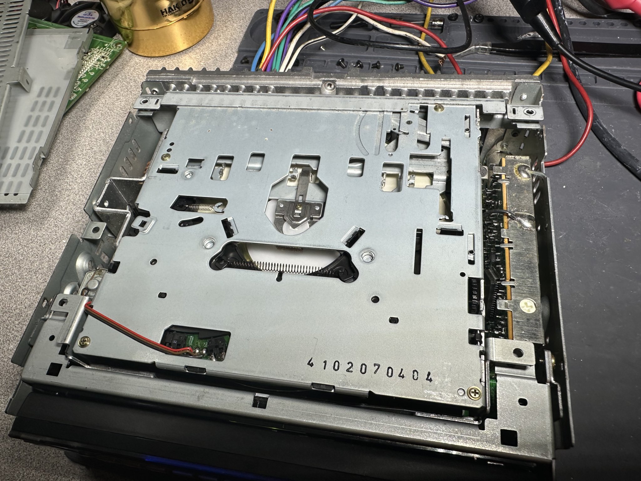

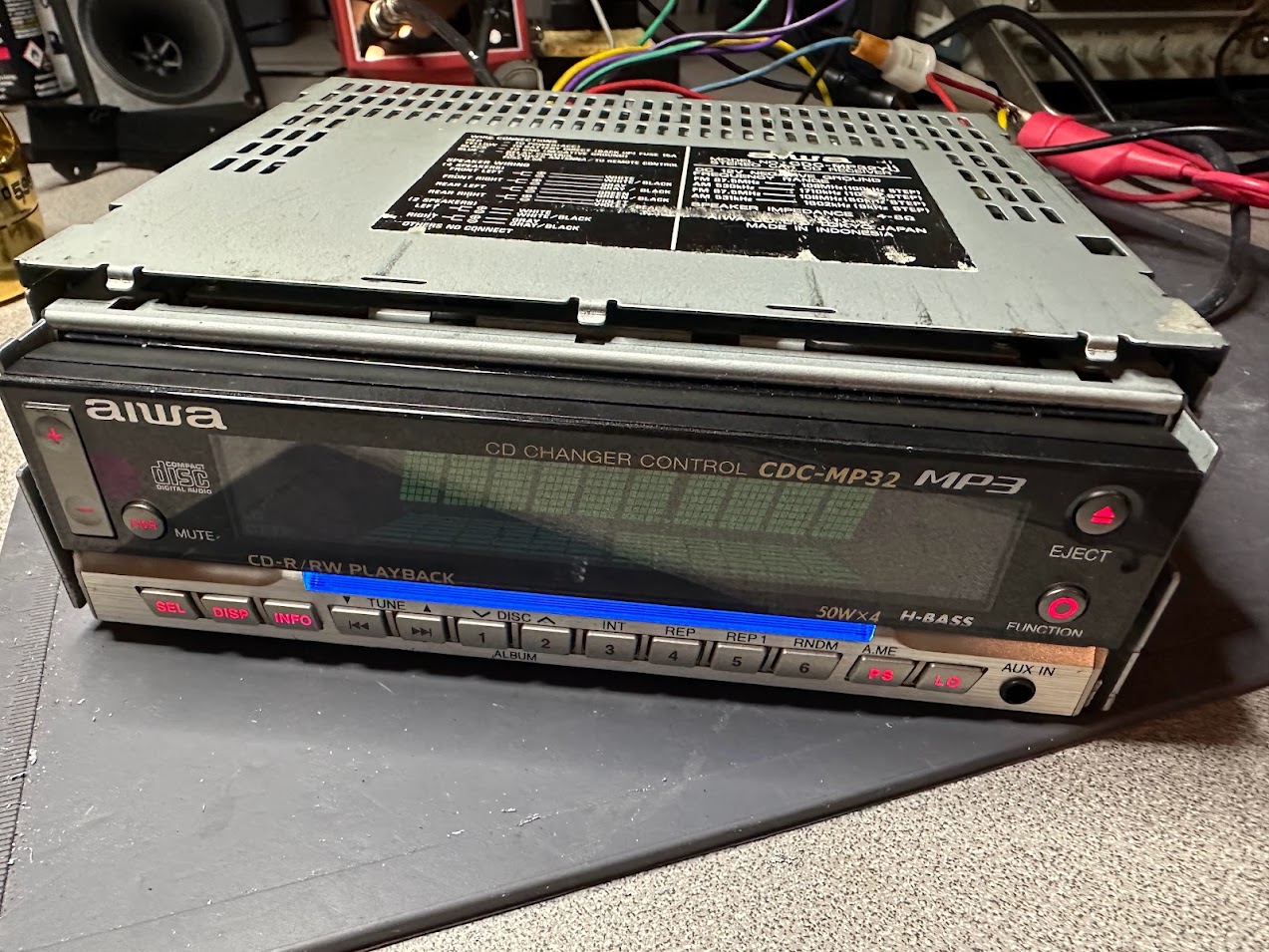

Hi, got this older flip headunit that isn't fully working that I'm not really sure what the problem is.

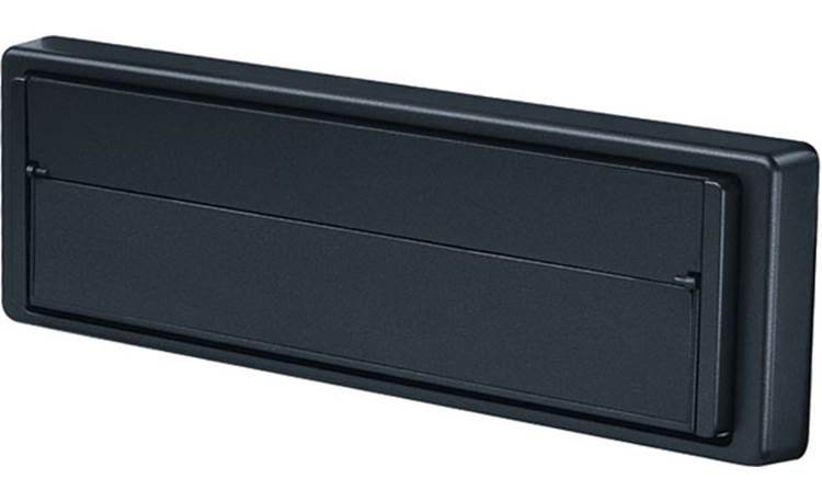

Display turns on and lights up, however no text or anything appears, all buttons are unresponsive (besides reset button) and the display does not flip as it should (second image).
Reset button moves the flip mechanism gears very little that you can hear it and see it (only after looking inside) 1-2 seconds after pressing. The display will not move when this happens (besides very slightly that it is easy to miss as if it tries to move).
Tried putting standard 12v to it, and the recommended 14.4v, same result.
When it turns on you can hear it start to read a CD that is inside of the CD slot then stops.

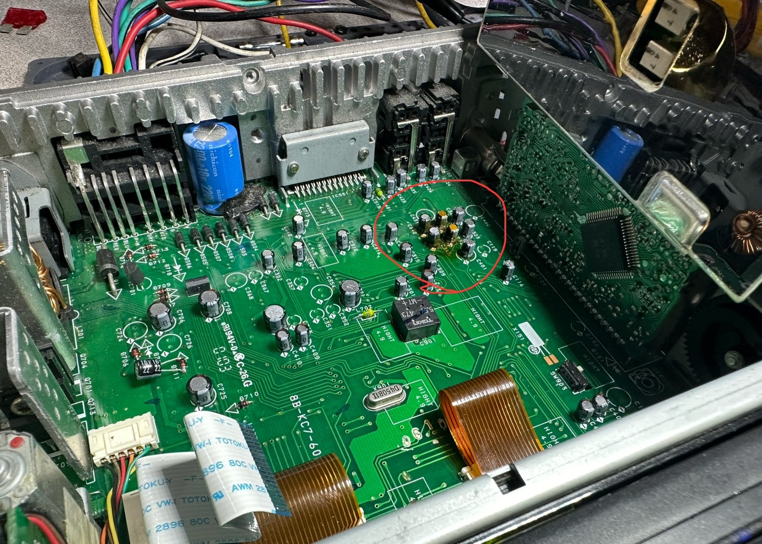

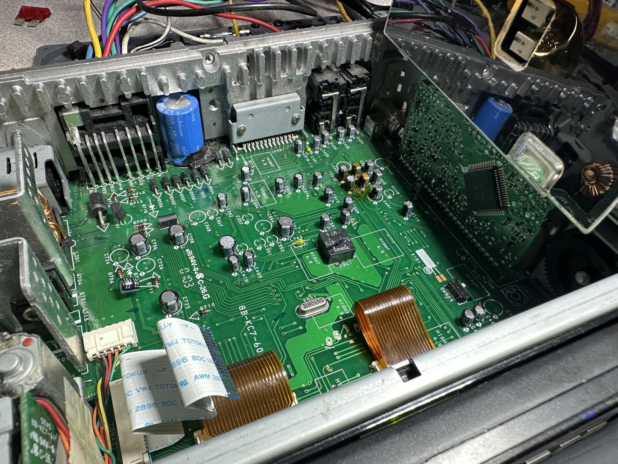

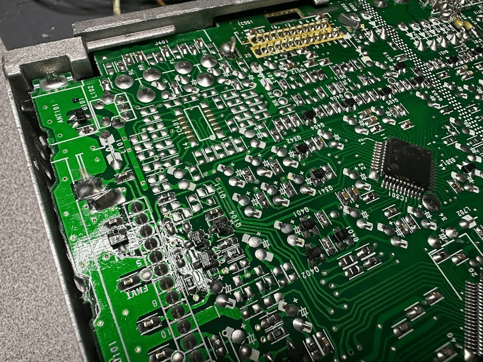

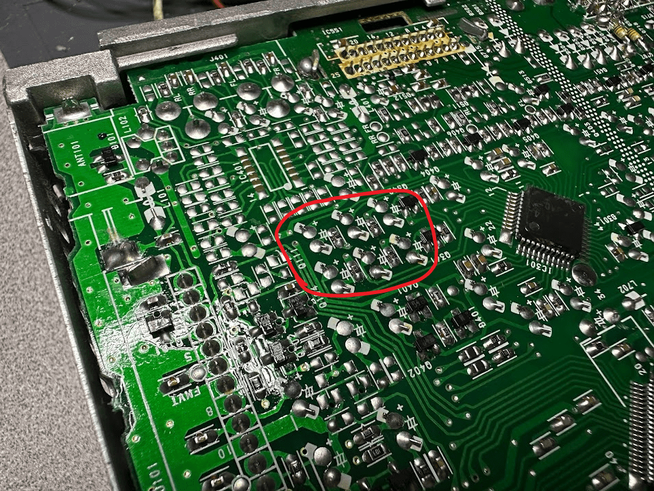

Only thing I saw when I opened it up is these groups of caps covered in something although I think it may just be flux (this is under the cd player)
Flux rarely has a smell. If that's electrolyte, you should replace all 6 of those large caps and you may need to replace other components near them. The board will have to be cleaned thoroughly and inspected for damage. You won't know much until you get the caps out and examine the board.
I have a pretty strong feeling that is flux then, there is almost no smell, and it board does not seem to be damaged
It cracks like flux normally does when moved and it looks a lot like flux

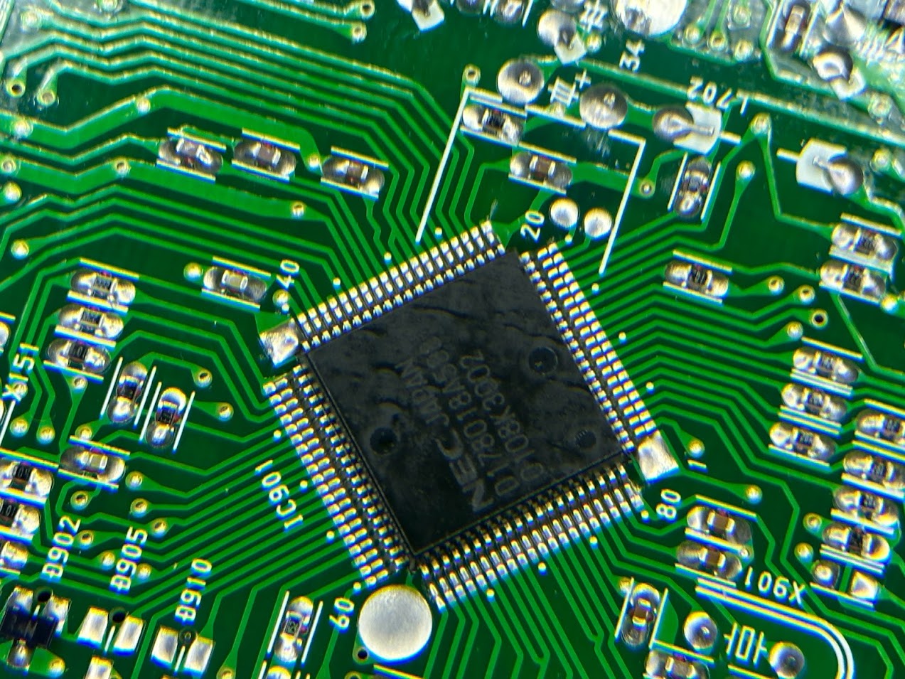

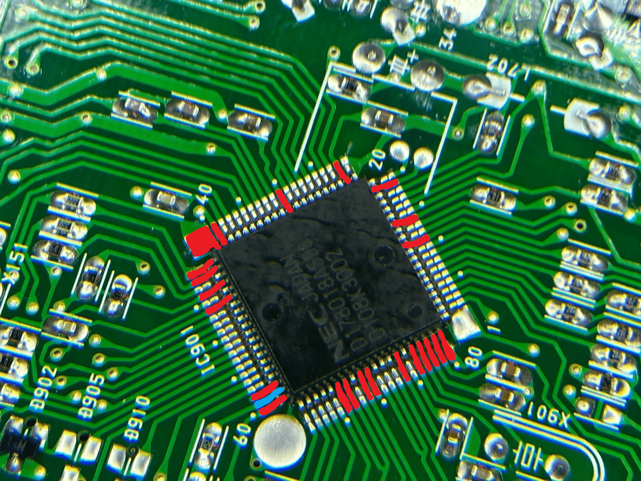

Highlighted pins are which showed positive DC
Blue showed 2 rails, ground and positive DC
I believe I accidentally shorted 2 pins which caused that smell and for the headunit to reset as I shorted it, whoops 😬
After letting it sit for a bit and restarting smell went away and did the same as it had and that's when i checked the pins
This is what the blue showed
I don't have a thermal imager but I have canned air
The IC doesn't heat up while idling

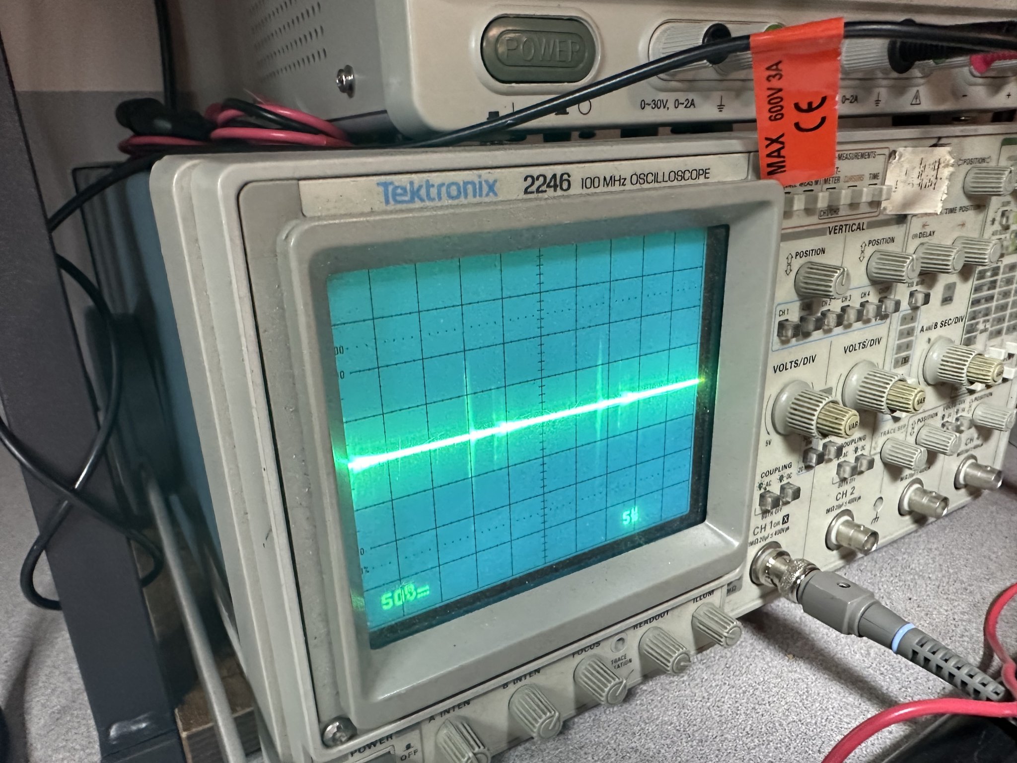

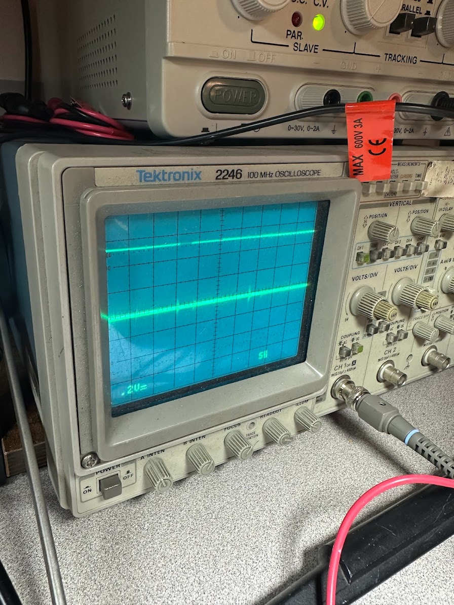

I thought so as well but it wasn’t, it was pretty weird but this is what it shows now, voltage increases when reset button is pressed so I think it has something to do with reset
