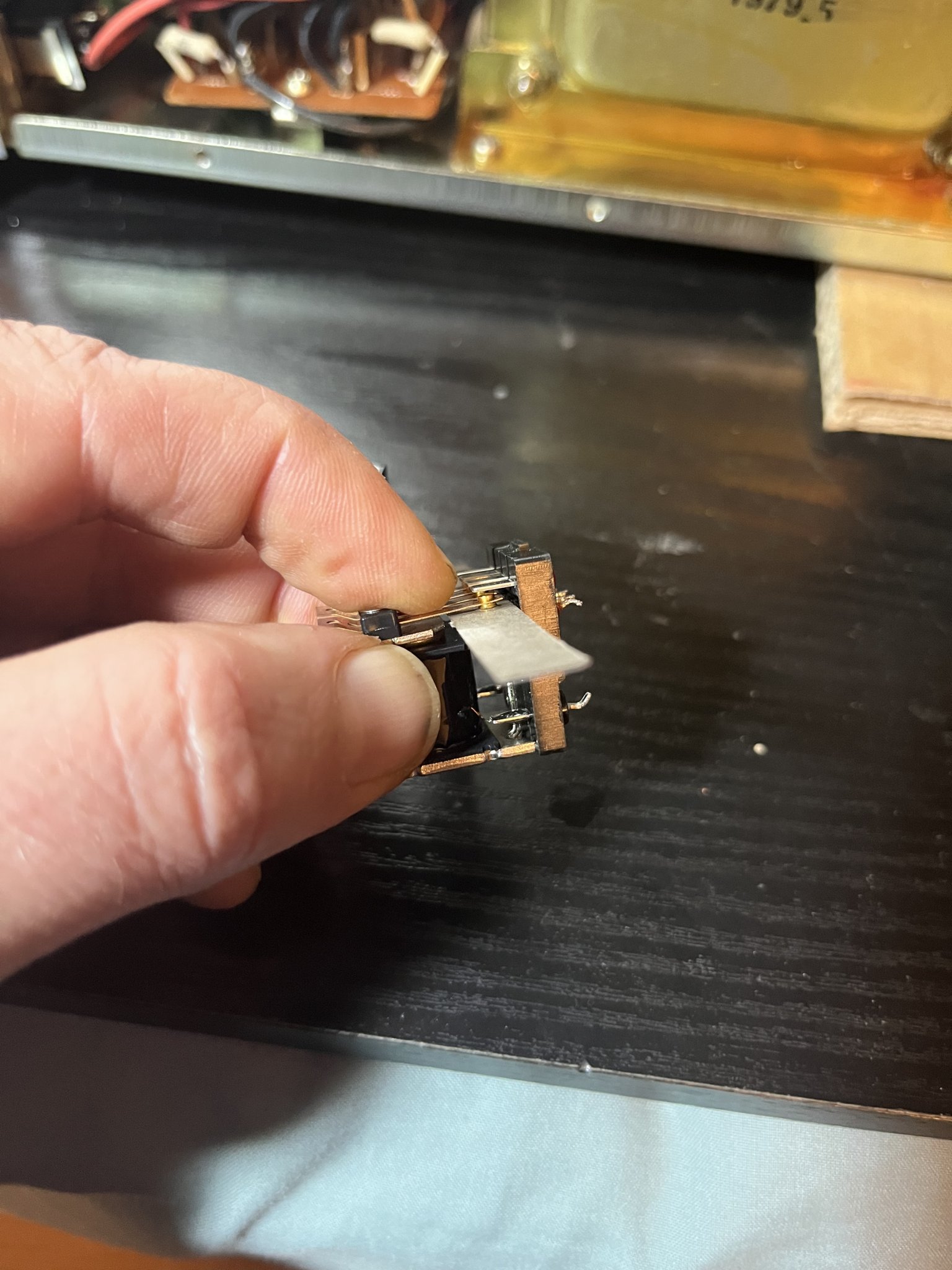

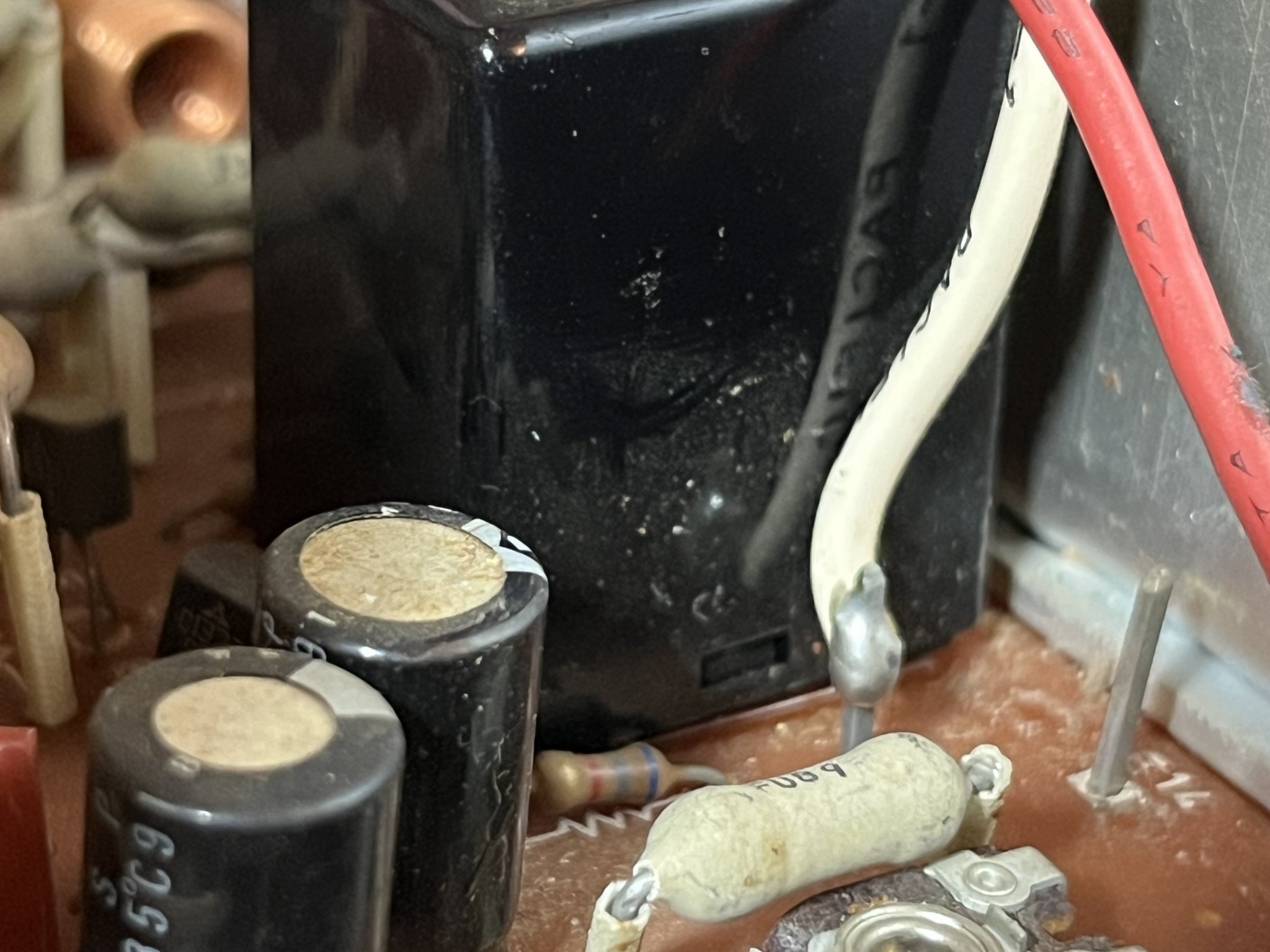

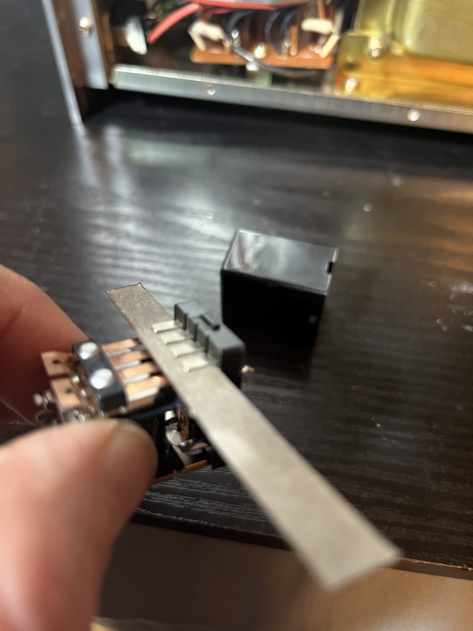

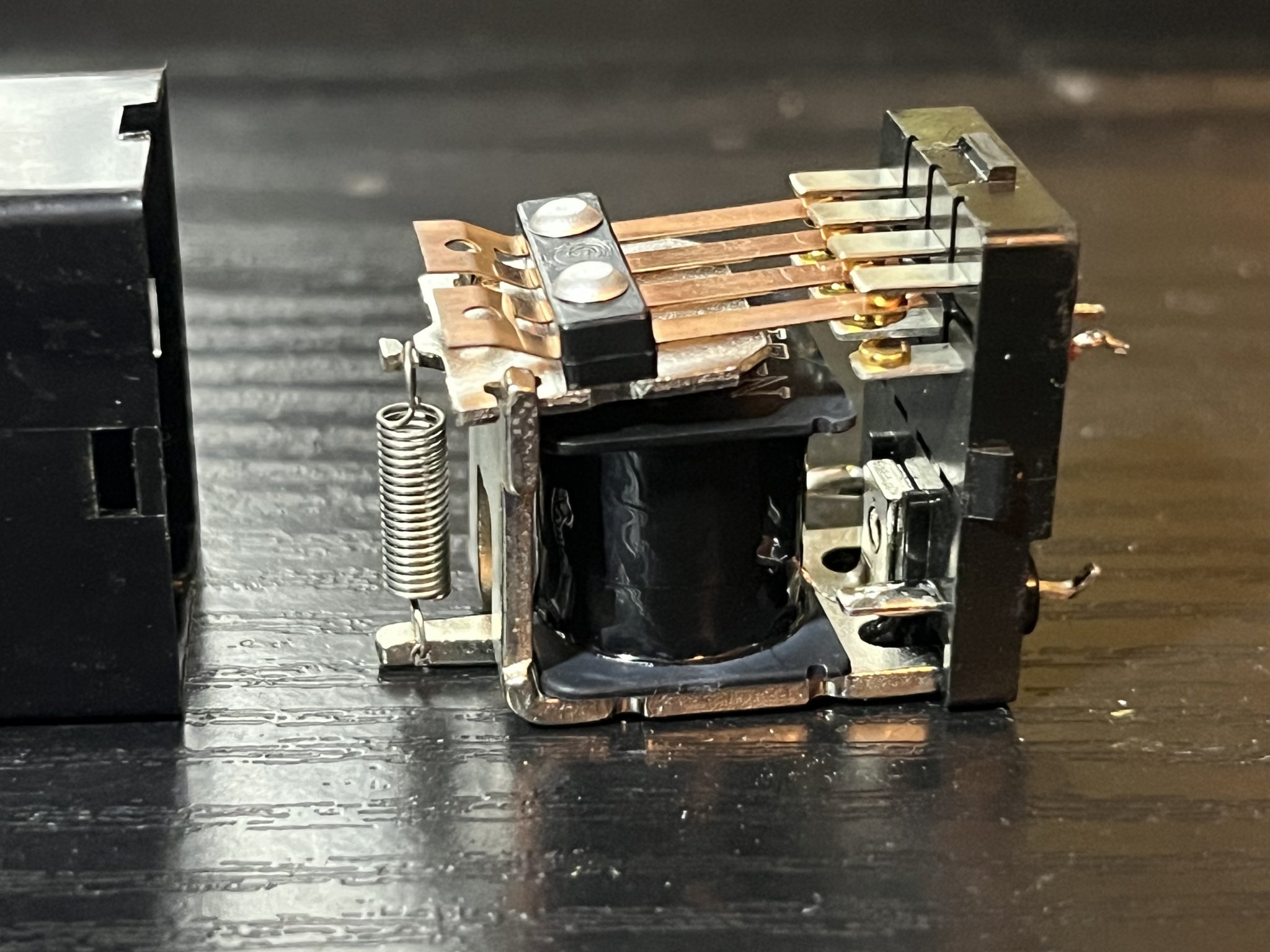

It’s out! And I was lucky, it is like that 👍 Cleaned by thicker paper soaked in isopropyl alcohol..Many just clip on, you might get lucky with a bit of force without removing it.

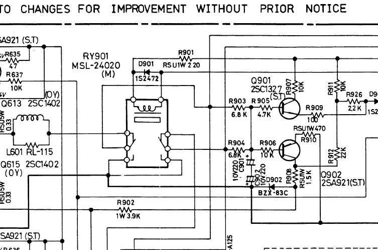

Looks like pretty uncommon connection solution - the sidemost contacts are bridged by internal connector?
Oh excellent stuff 🙂 That should be be good to go then with a good clean like that. Do all the contacts look good?It’s out! And I was lucky, it is like that 👍 Cleaned by thicker paper soaked in isopropyl alcohol..

As to cleaning, it's much easier to remove the spring, lift the armature out and get a better look at the contacts.

This is what you see in SM:
- and I fail to match it with the contact layout in the first relay photo.
Probably label type from the relay cover would be handy also.

Perhaps I have just not met one like this yet.

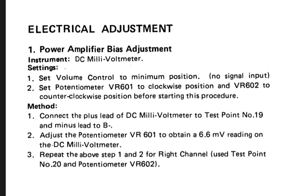

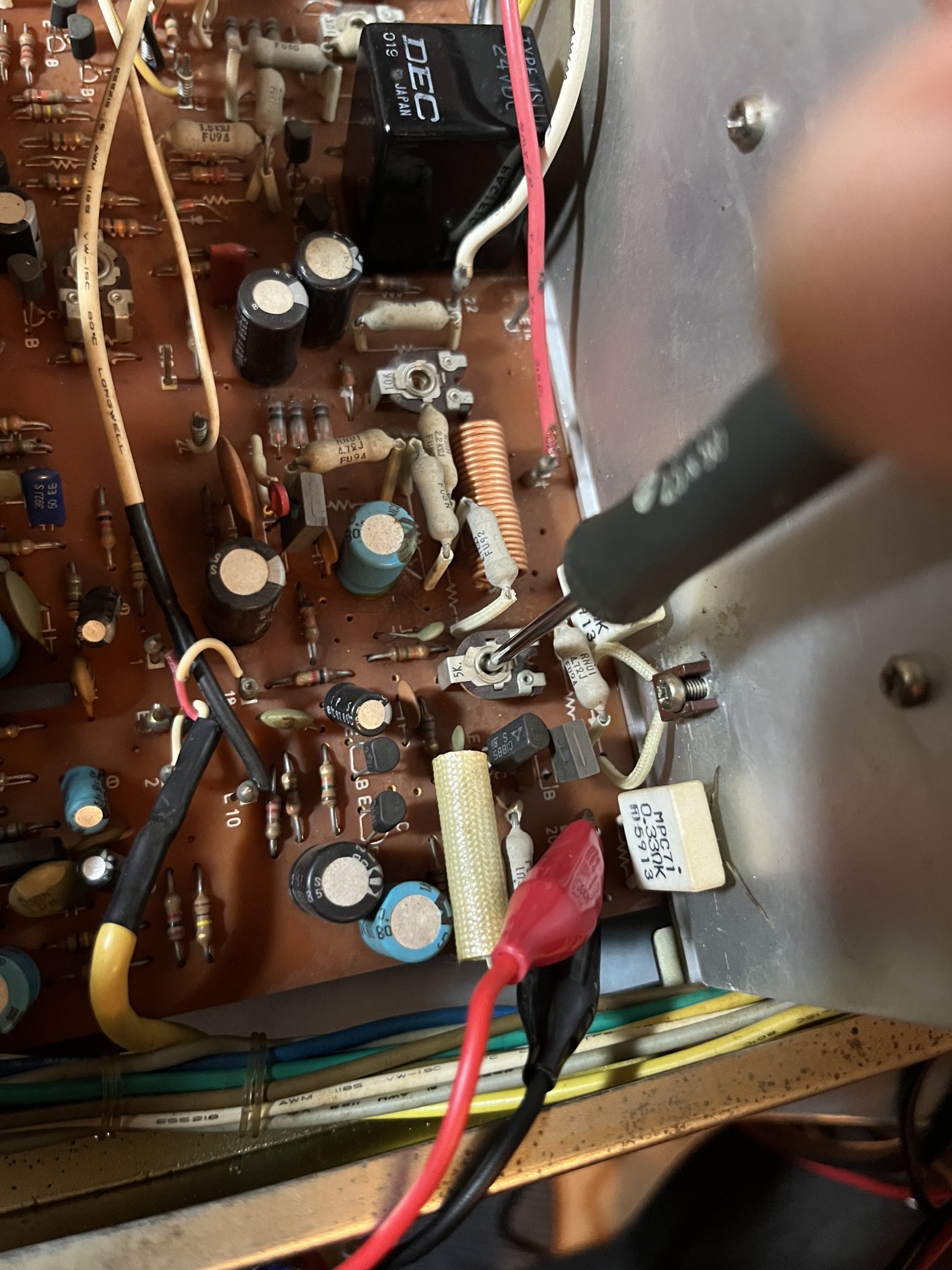

Yes, I have downloaded the manual, thank you, also tried to do the bias adjustment, first time ever 🙈🙂You've shown me a portion of the schematic.....

Yes, thank you, they seem to be like new🙂Do all the contacts look good?

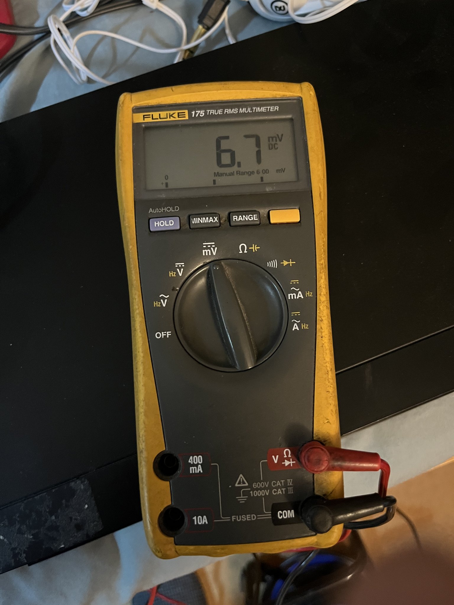

According to manual, I did adjust the bias to around 6.6mV for both channels, I think successfully 😉
When I tested the bias before, it was only about 2-3mV, now it is about 6.6mV.
While adjusting I did keep the amp on for a little while to stabilise, then I did adjustments, and when it fluctuated around 6.6mV, then a repeated the procedure on the other channel. Hope that was okay to do like that..

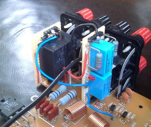

Seems that it is even possible to buy a new relay should it be necessary:
https://www.euromaxx.nu/product/marantz-speaker-relais-relay-mslu-24vdc-24v-speakerrelais/

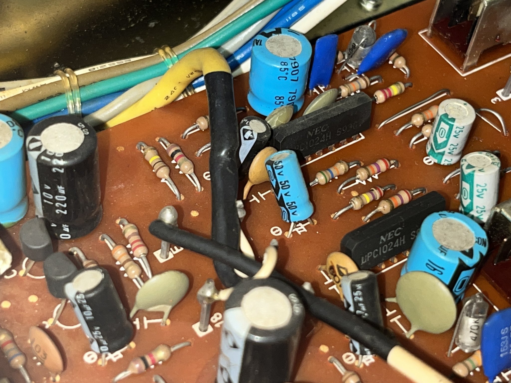

Great, thank you! I think, except a few parts maybe, all the standard parts - transistors, capacitors shouldn’t be problem to source, probably even 2 ICs uPC1024H..

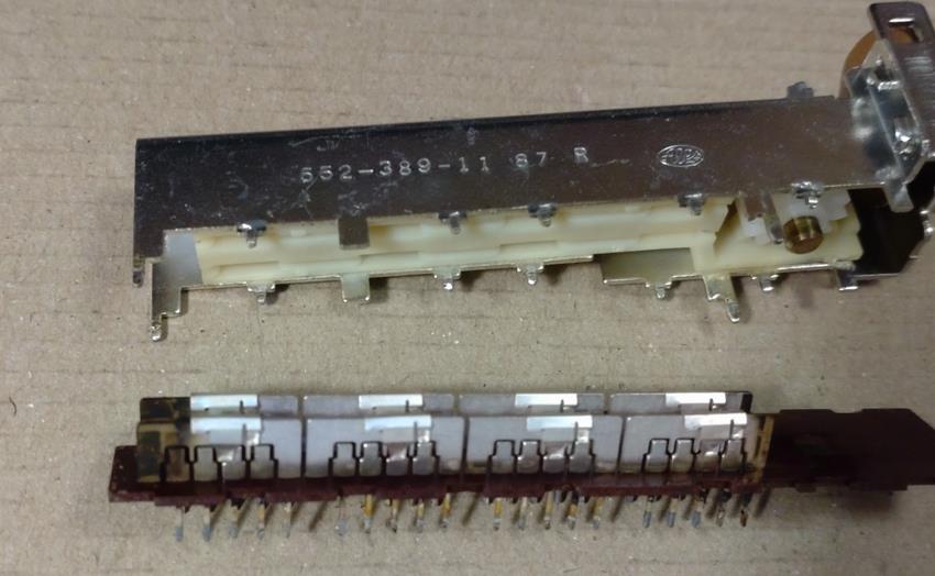

- clean the contacts of sliding switches.
