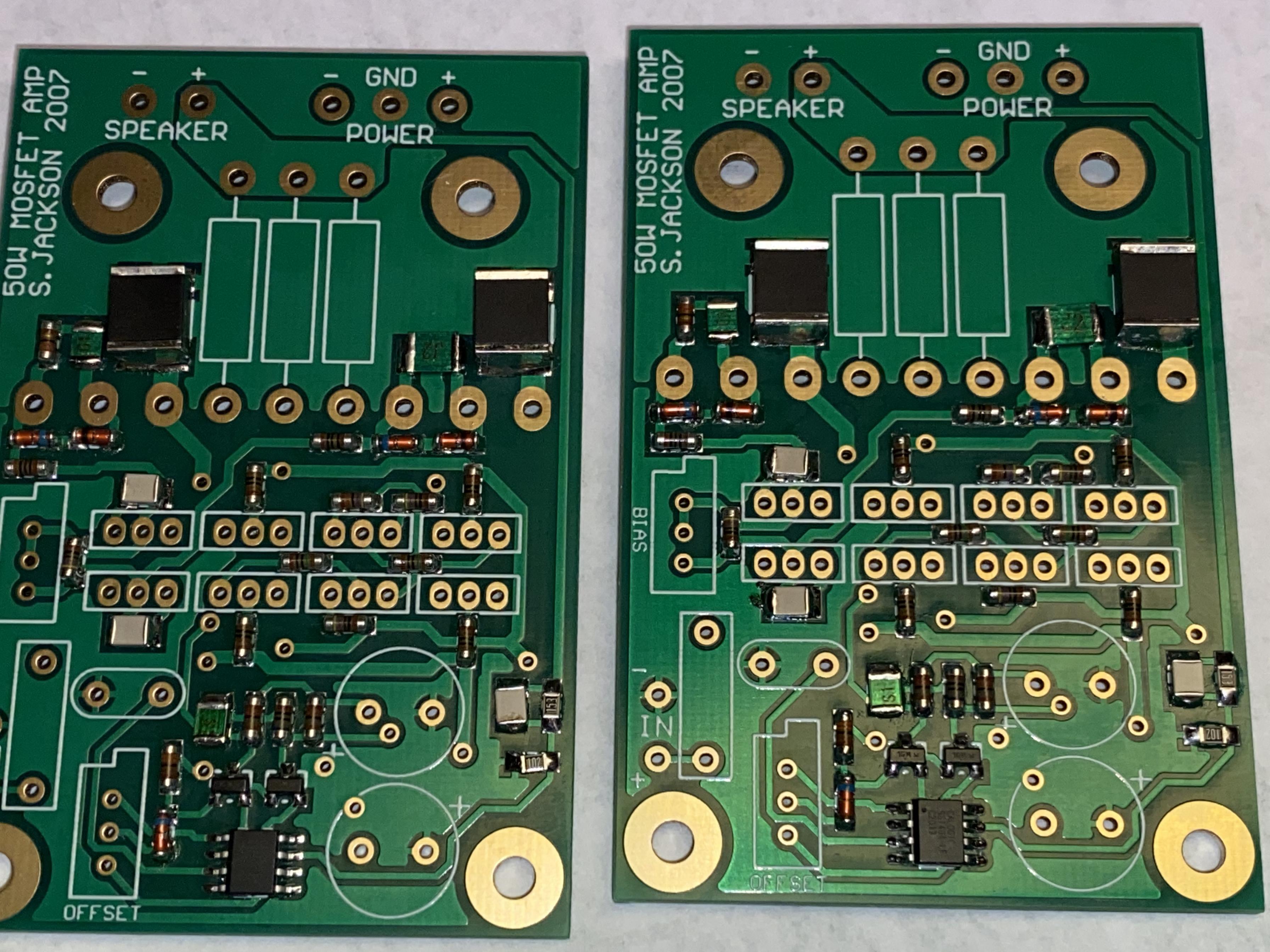

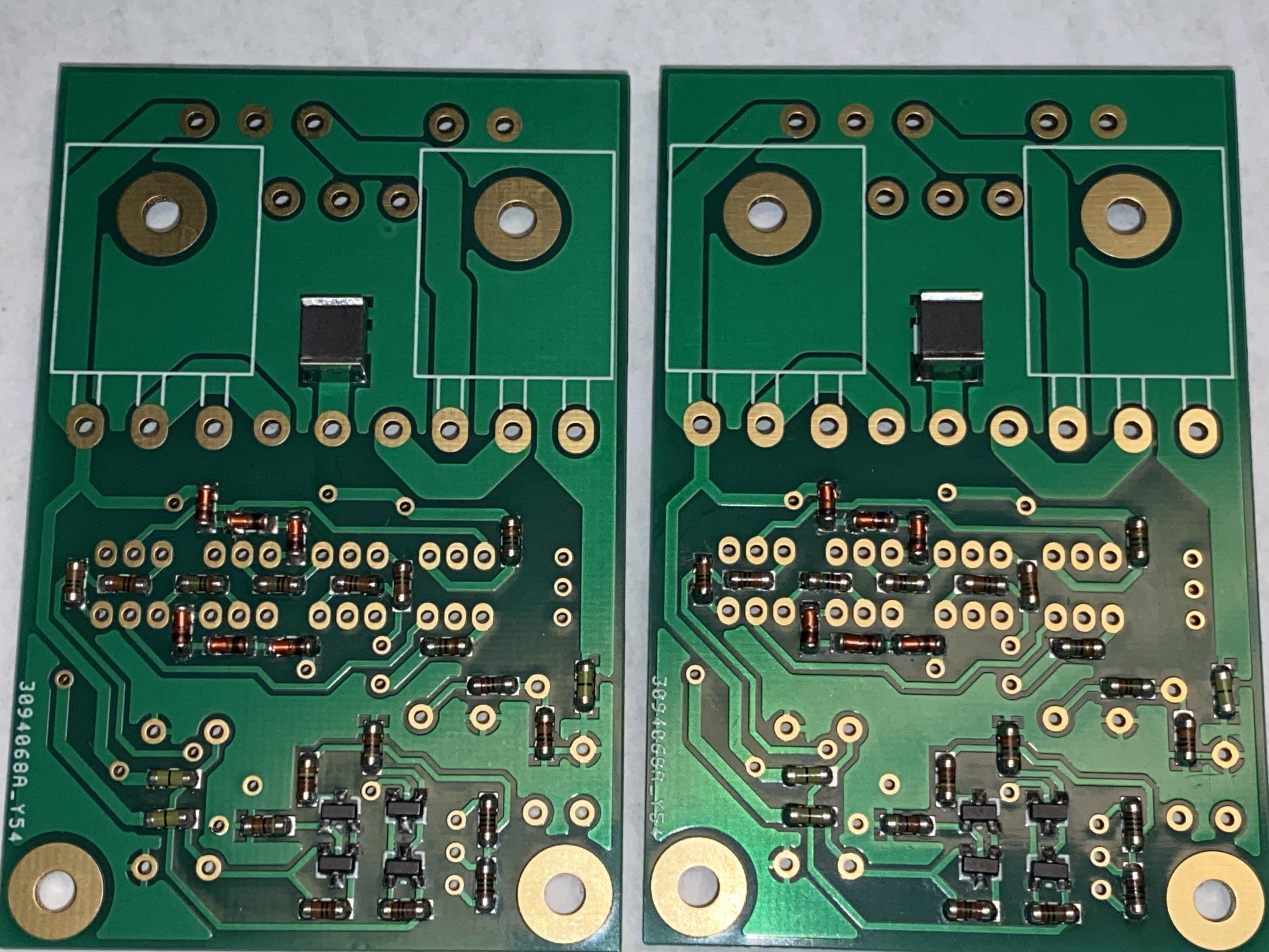

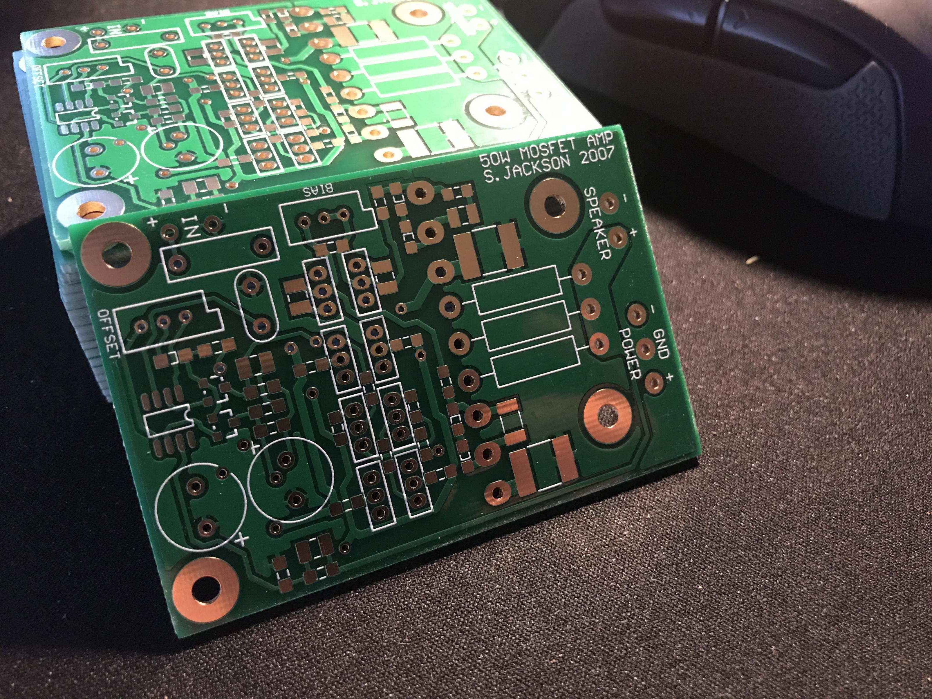

My PCBs also finally arrived
Not all the components are here yet, but that will also change shortly.

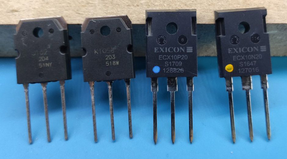

Your Exicon FETs have dots!

Hi Suzyj,
The dots refer to 'S' variants specifically selected by Exicon to be used in parallel.

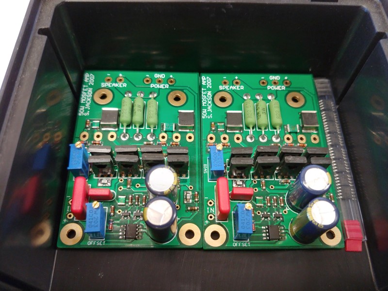

Happy New Year everyone!
What better way to ring in the new year than to start a new amp project. I made some progress today, all the SMD soldering is completed.
Happy New Year Vunce
Nice job! Did you use hot gun or oven reflow?

Hi Jacques,
SMD soldering method:
I use a hot plate with a pan to preheat the pcb, then use a hot air pencil from the top to flow the solder.
All the components larger than the MELF resistors were soldered with a fine tip iron. You must be very careful not to overheat the CDE film caps, heat is their enemy. Apply a bit of flux and get in and out quickly.

anyone having 2 pair SST404-LF left for me ?
These devices appear to be the Achilles heel of this design. I bought 10 of them and the shipping was more costly than the devices themselves. All of mine appear to be accounted for at this point in time. I should have bought a lot more to bring down the average cost per device.
PS. I just looked at their website and they offer free shipping on orders above $60 into Australia. My order came to $54 I wish this was more obvious when I placed my order.
