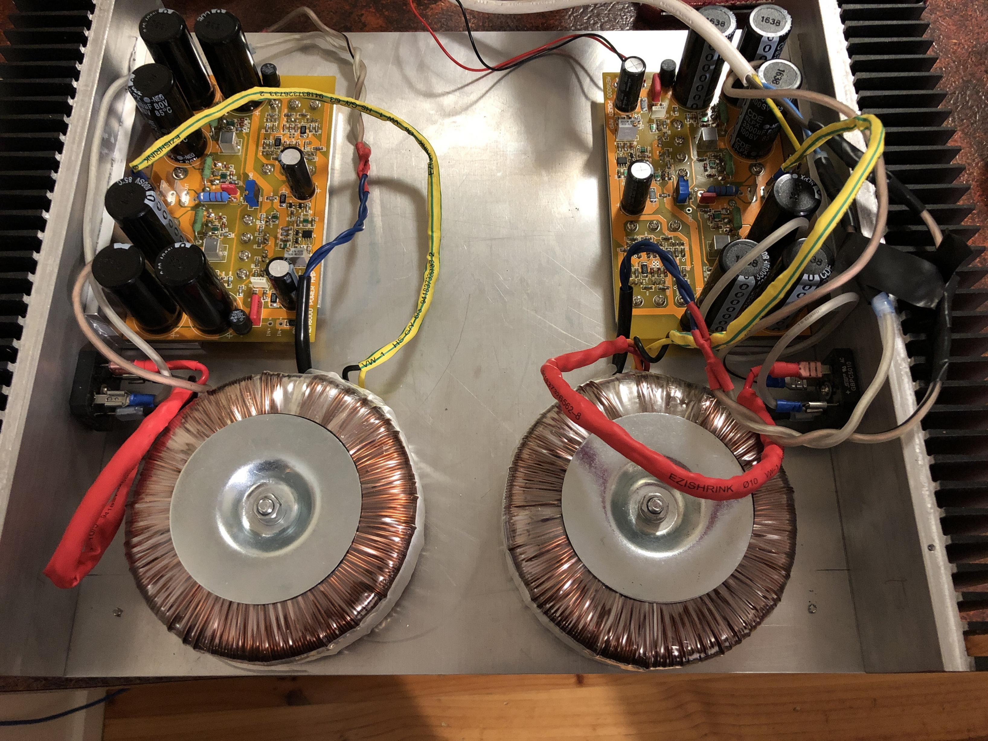

Awesome! Hope you enjoy it - I've just pulled mine out from the main sound system in our loungeroom after about 12 years (my speakers in there now are active two-ways). I did a quick test of noise level and 1 KHz THD and it's exactly the same as when I first built it.
AEM6000 in action 🙂

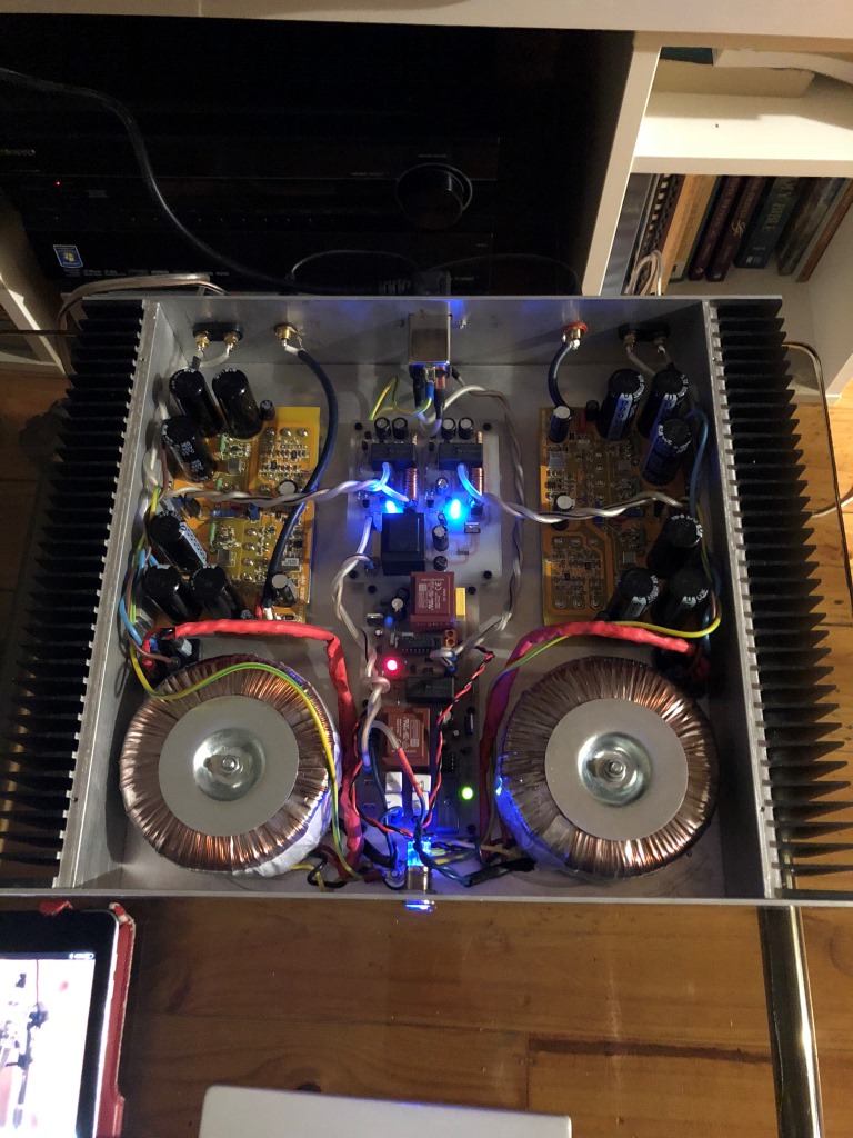

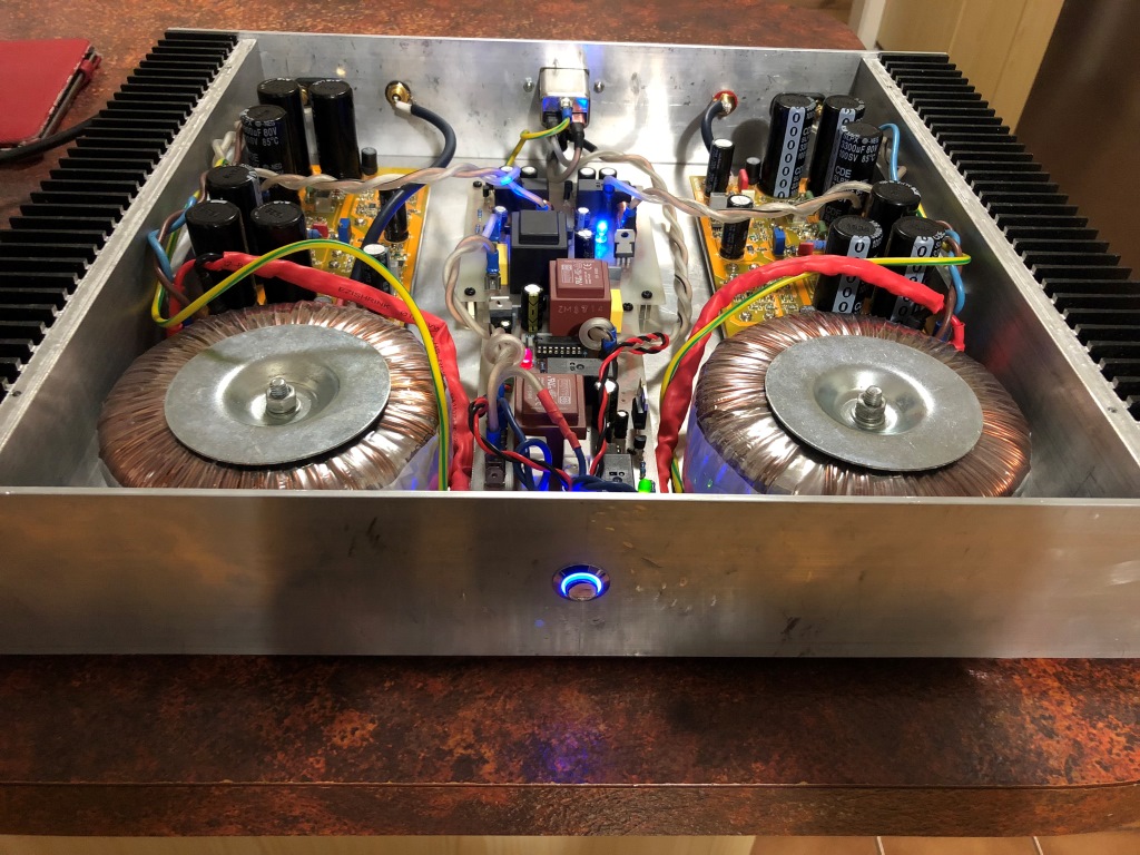

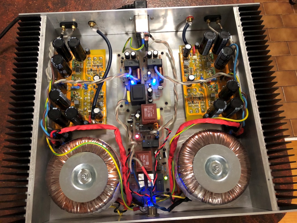

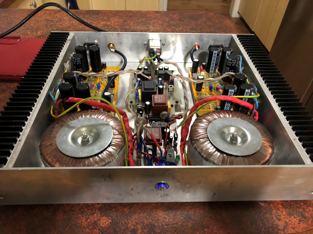

Hi Suzyj, got it all done, i add a toggle switch, soft start and dc protect on my build. first power up on the amp case hook up with the speakers with nothing connected on it and it is very quiet no hiss or hum. tried playing music using my ipad and it is truly amazing feeling, you can hear the individual instrument playing clear and defined, feels like a live performance. Thanks for a well design pcb and circuit. attached are some pictures of my build. It is an enjoyable experience.

Nice build , Marjohn.
Good to hear, that all works fine.

Dunno about the blue leds, but with their exception it looks fantastic. Hope it gives many years of reliable operation.
Excellent build mj777, I have had Günni's boards stashed for ages and this has made me get them out and start building. Thanks to Suzy and Günni for their work.

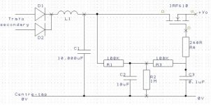

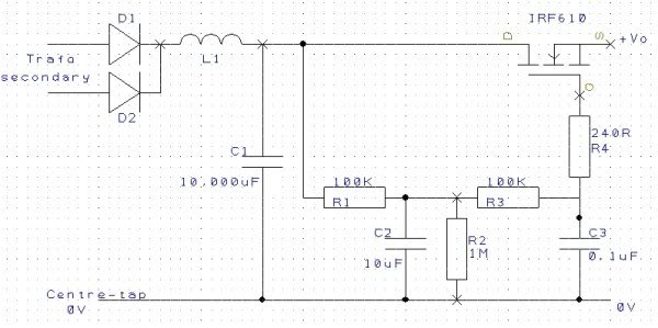

Another plan is to use a separate -/+65V 15VA supply for the front end, as per Suzy's recommendation, with a small cap multiplier for each rail. The PFM Gyrator circuit is one I have used before on a front end supply. Pic below, I may try and make some boards if I can get the hang of Eagle. The Gyrator circuit drops around 4V so will need to spec carefully.

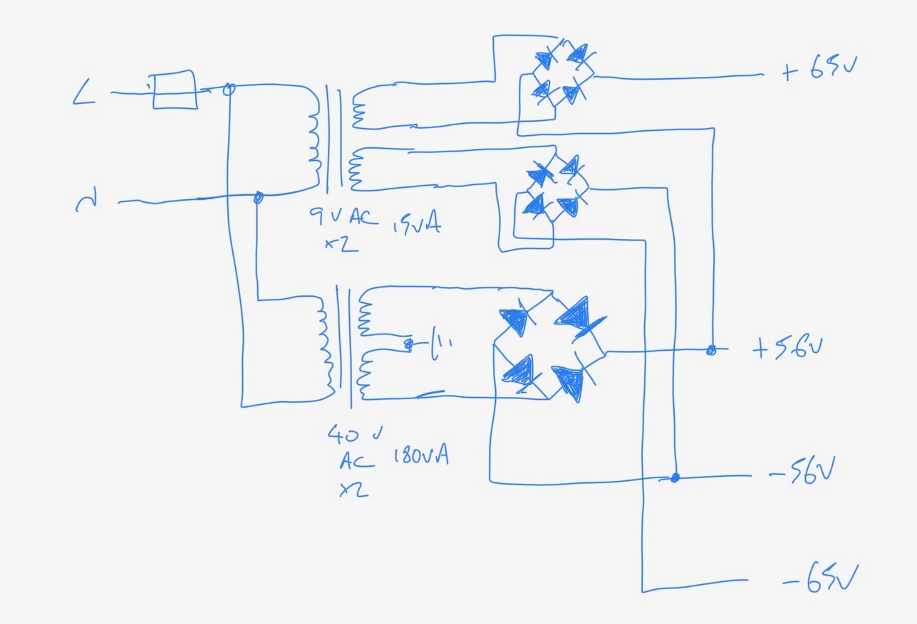

Suzy, how do you get 65VDC from 9VAC? I'm hoping to get all the windings on a single dual mono transformer.

The 9VAC is rectified and added to the rectified dual 40VAC., so 56V+12ishV = 68V.

This is what I meant about the +/-65V supplies. The supply for the front end only has to be a little dinky transformer - even 5VA 9V will do:
Hello Suzy,
can the addition of the voltages also be made on the secondaries AC side or do we need the decoupling of the rectifiers ? That means, the main transformer 2x40V AC feed the OPS and the main transformer 2x40V AC + support transformer 2x9V AC feed the frontend.
