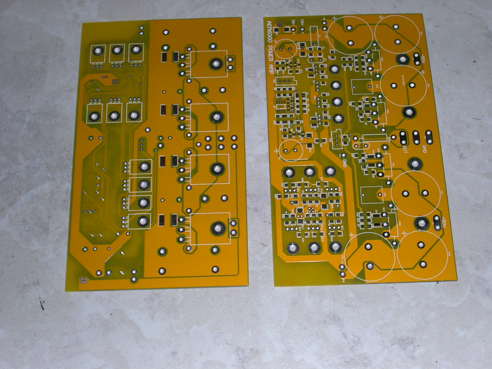

my bunch of PCBs arrived from PCBWay, and i am strarting now to build up the amplifiers. Thanks again for that wonderful design to Suzy Jackson.
So, what are the hints and tricks to make this beautiful amps successfully work.All parts (Melfs, capacitors, SMD transistors, driver and powe transistors are already available. The pcbs are double layers with 2 oz (70µ) copper. As far as i know, Suzy uses 3 oz PCBs.
Any comments to that project???

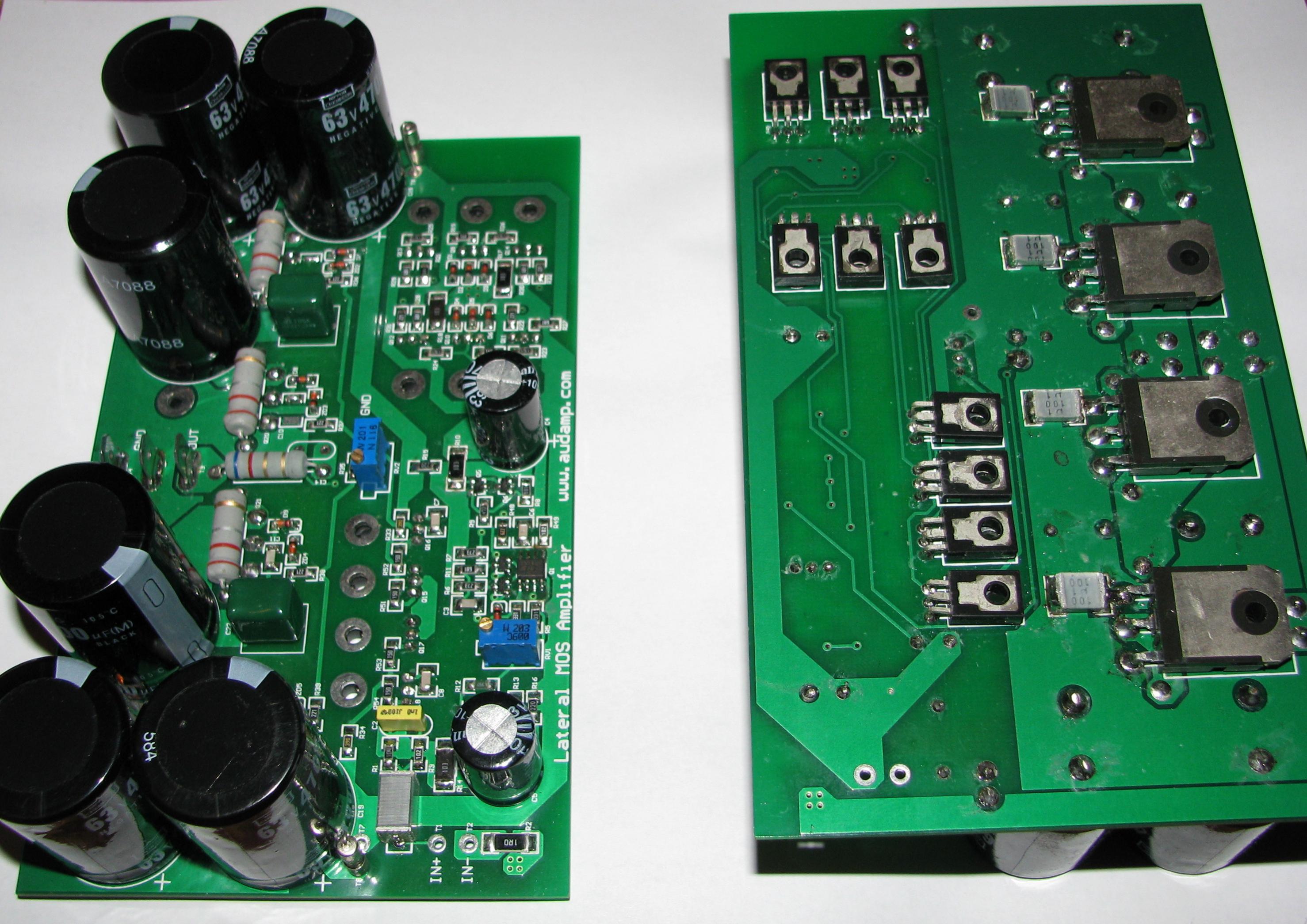

As i saw on the picture, you built already this amplifier. What's your experience with that nice amp.How do you estimate the quality of that design. Are there any tricks (Parts, type of parts. changes in equipment) to get the maximum quality out of that design.

What can I say , thanks for those kind words addressed to me , and about the boards ,they are with dust right now . They was never functional (lake of time ) ,maybe in the future. I think they will perform nice ,without any problems .
You must pay attention to rectifier bridge to be selected correctly ,something like 36A and voltage over 100V or so and heat sink for drivers and final transistors.

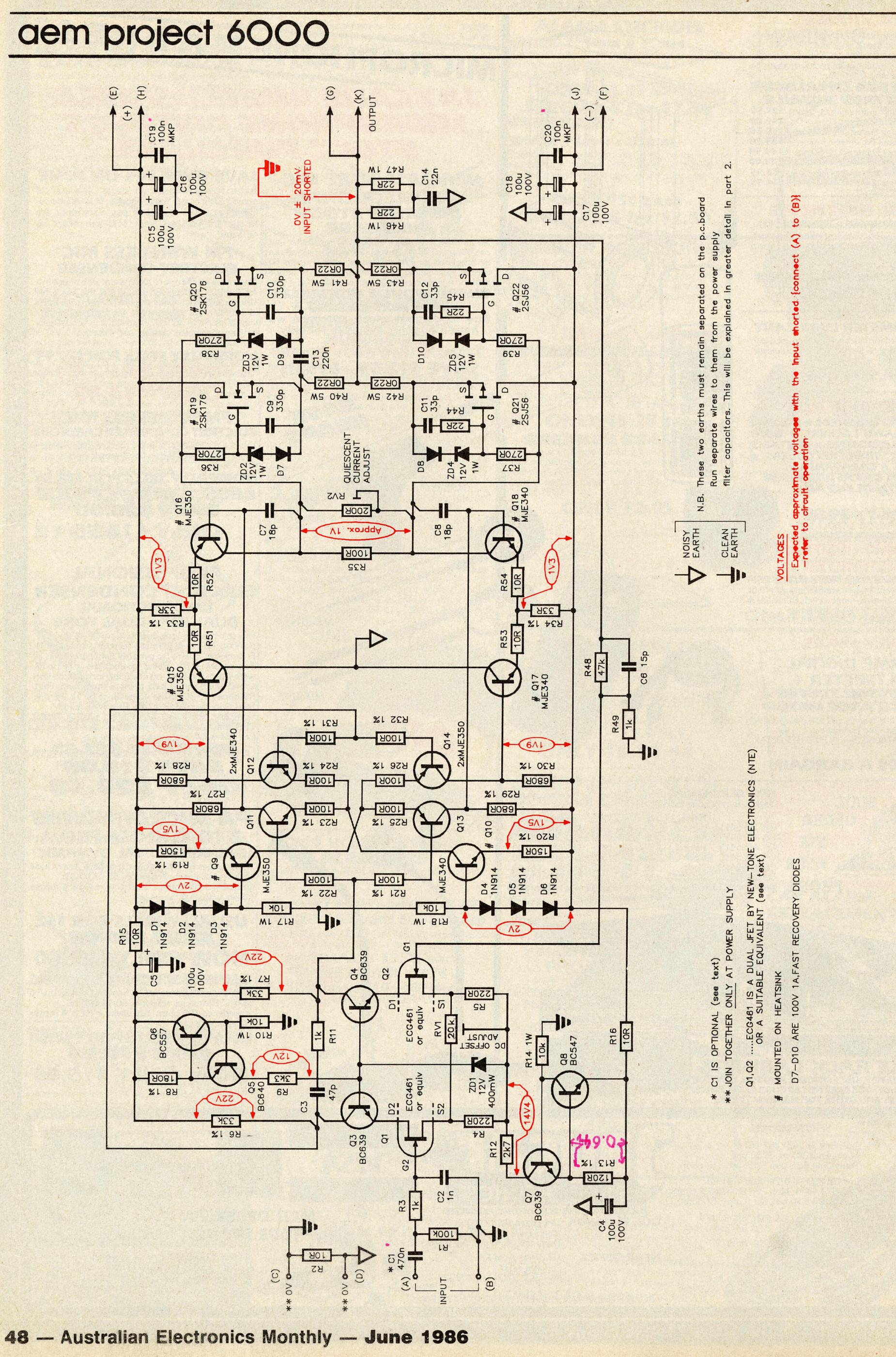

hello my friends, i'm now ready to assemble my own AEM6000, but in the schematic exist 2 trimpots and no reference about how it`s adjusted.
Anyone have any idea about the parameter to adjust this trimpots?
In the original schematic, i found the adjust of the second trimpos, it`s the most close to the output MOSFETs, but anything about the input trimpot. Even so, that value would only be useful if I were building it based on the original scheme, and I'm following the Suzy Jackson project.

I have the schematics and pcb plans of the original aem6000 designed by Dave Tilbrook. I do not know what Suzy changed in this design. I see that she replaced through hole components with smds, which I don't like but times are changing.
Attached is the original aem 6000 diagram.
