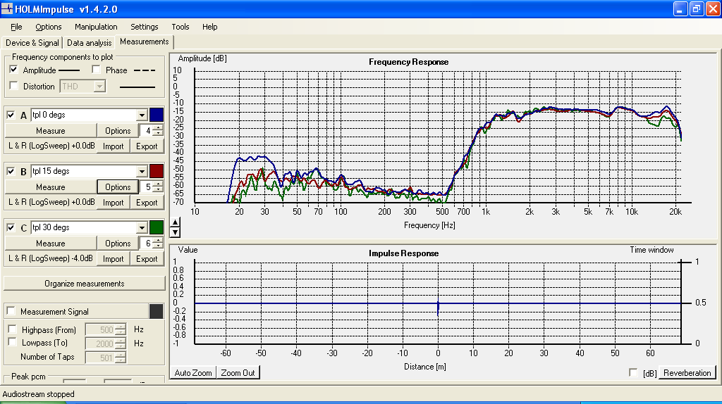

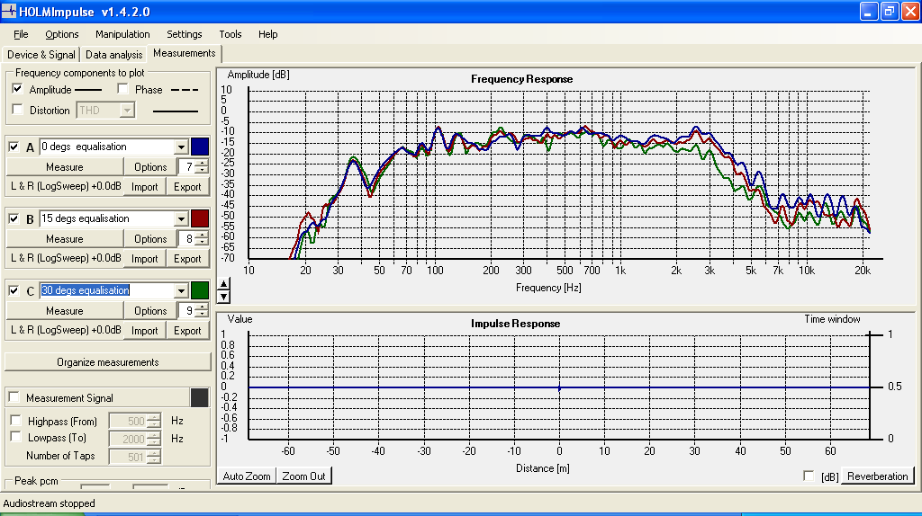

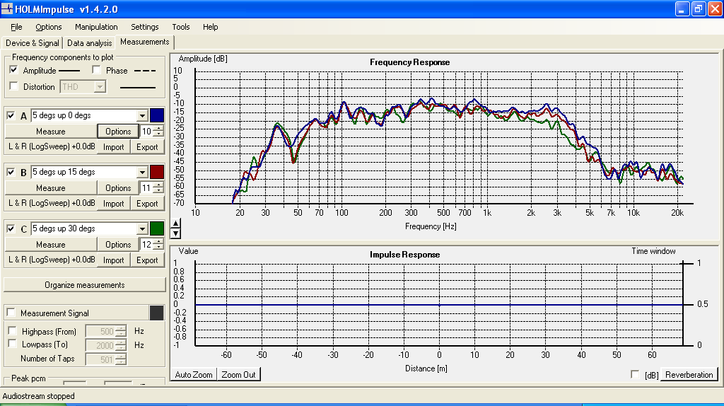

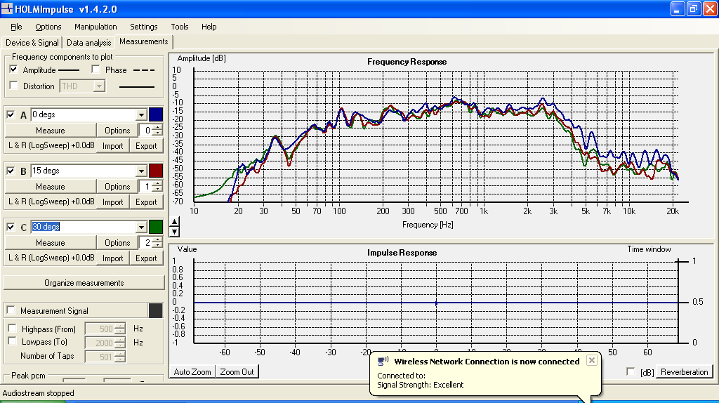

As promised here are a few more measurements. The measurements have been taken at 0 degs 15 degs and 30 degs horizontally from the centre of the cone with the mircophone 1 metre back. Put some foam on the floor in an attempt to reduce the influence of the floor in my room.
1) first set of traces are the 12p80nd without any equalisation running full range
2) second set is the TPL
3) third set of traces is with my equalisation (6 db step down)
4) fourth set of measurements as second but 5 degs above horizontal.
5) fifth set is how the 12" and TPl cross @ 0 degs.

230 Hz : first floor reflexion ?
That's funny : we saw clearly the little 1.6 K Hz behavior of the TPL150 !
Thanks for sharing.
Yes, thanks for sharing.
In my humble opinion you'd get more out of these if you go closer on the vertical axis. Ie, say 0 to -30dB is what might work for me.
The TPL appears to come out fairly clean. Maybe now I can see a reason why people say they like it.

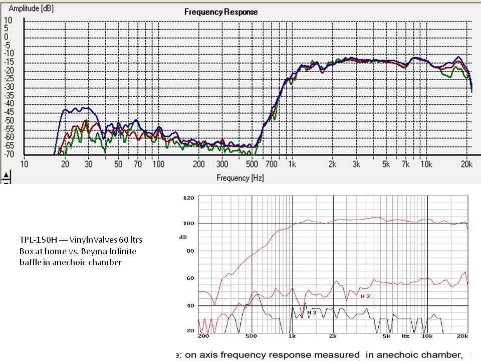

For comparison, I pasted your home measurements in a 60 ltr box above Beyma's measurements on an infinite baffle in an anechoic chamber.
Your 12P80ndv2 30degree polar measurement data around 1.6Khz looks promising for blending with the 80H polar horn on the TPL-150H. With LR4 slopes, both mid and tweet are -6db at the 1600Hz Xover, and the Xover can smooth some SPL bumps. What DSP delay did you use for TM time alignment?
I hope listening tests give you "shock and awe", and help justify the cost and time of this new "vocal range" midbass speaker design. Give some consideration to using DSP with a reasonable size sealed box woofer for better small-room fit.

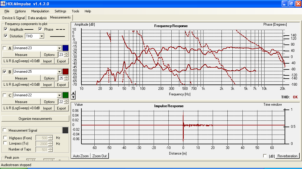

Knocked up a second cabinet, so i could listen to the mid range drivers in stereo. Attached are a couple of traces from the second cabinet, first shows each driver and then them combined. The second shows the combined response and the phase and THD.
I am not understanding the phase traces, was expecting a flatter curve as they are sealed drivers.

VnV,I am not understanding the phase traces, was expecting a flatter curve as they are sealed drivers.
The phase wraps look reasonably smooth through the crossover regions, which would indicate no major time alignment or polarity mistakes.

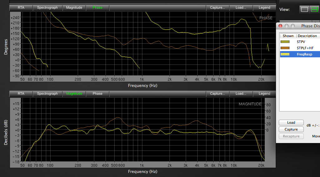

Each "pole" of the crossover and high pass used on the sub contributes 90 degrees of phase shift in addition to the phase shift of the driver in each acoustical crossover region.
Below you can see the raw combined response of the 10" and 3" diaphragm driver on the SynTripP horn in brown, then the equalized response with a 24 dB (4 pole) LP and crossover in yellow. Note the 360 degree phase wrap around 1000 Hz that results.

Interesting, i was under the assumption that crossovers with a DSP did not change the phase. I thought all they did was adjust the volume with frequency and when time delay is invoked that doesn't change phase either.

That's what a lot of people assume, active crossovers come in many flavours. In general a digital crossover has the same effects on phase as their passive counter parts.
Yet there are ways in DSP to circumvent that phase rotation. Such forms of DSP would lead to latency of playback and possibly (audible) pré ringing of the signal. It all depends on how it is used. Good results can be had though.
VnV,I do need to account for the "protection" caps i have on the TPL's though.
As Wesayso says, unless using FIR filters, you are stuck with the phase wrap.
That said, smooth phase wraps don't seem to be a problem, though I have purchased a DSP capable of FIR, I have yet to commit to the time it will require to implement them.

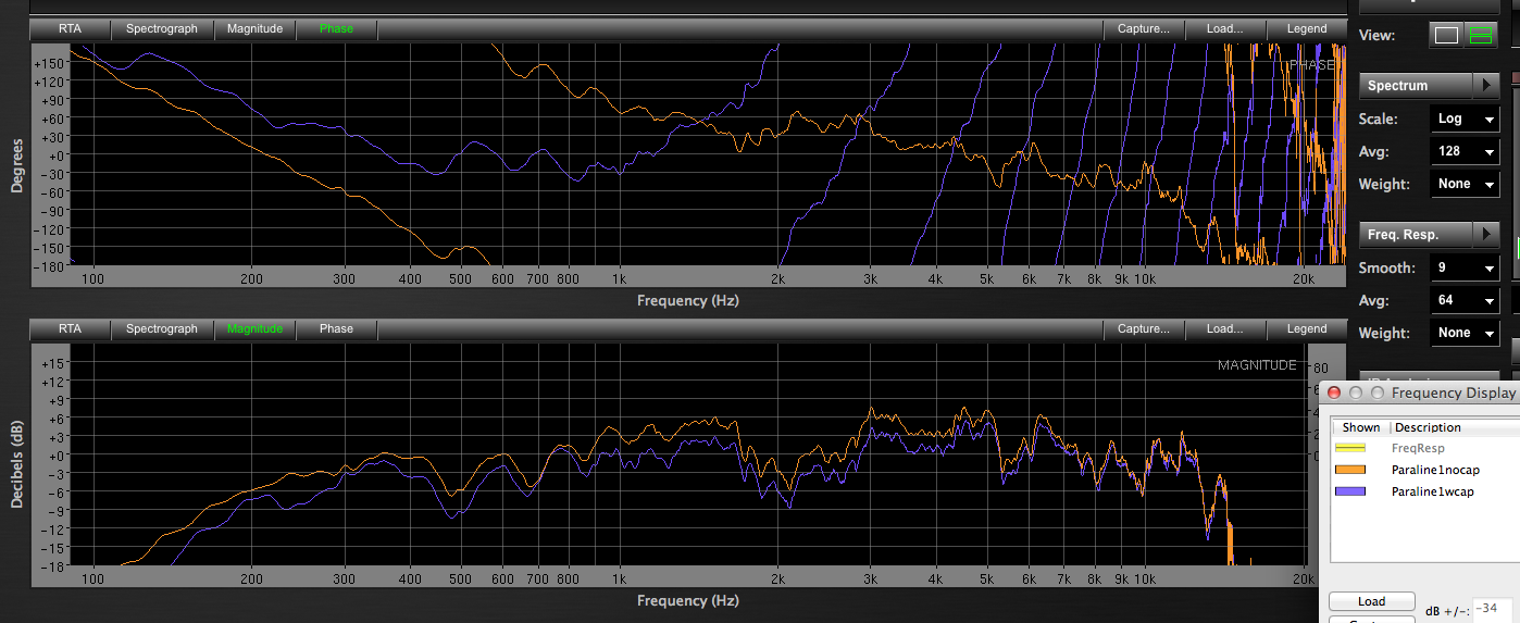

Below is the result of removing the "protection" cap, an 18MFD on a nominal 16 ohm driver on a Paraline horn.
As you can see, the cap affects frequency and phase response over many octaves. Removing them simplifies phase/time alignment.
What cap type & value are you using to protect your TPLs? I need to do the same.
A cap to give you a filter from about 800 hz down is what I use. If you need one depends on how brave you are and if you are confident the dsp won't misbehave.
