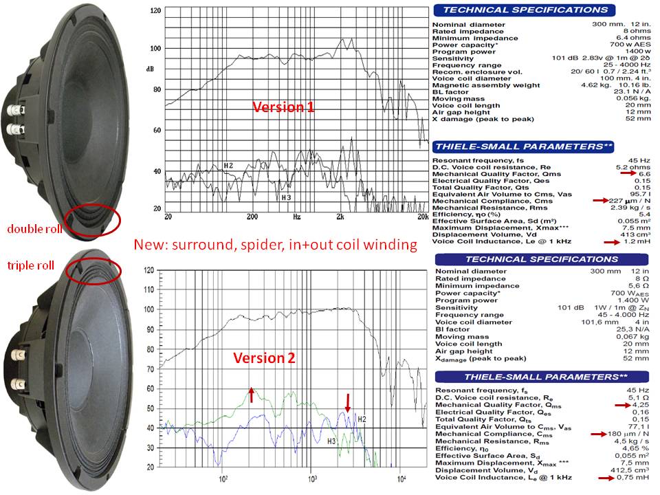

12P80Nd version2 has a 3-roll surround.... version1 has a 2-roll(M-roll) picture attached.

The driver i have been sent are version 1 ones, my supplier is goint to contact Beyma to see why i wasn't sent version 2 ones. Couple of week hiatus as beyma are on factory shut down.

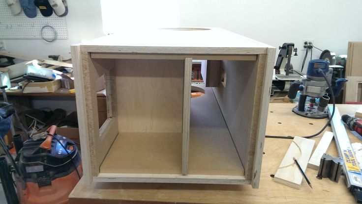

Noticed an interesting cabinet construction on the web, "innerchoic" on PBN speakers see image. I cannot see how to manufacture this without a laser cutter, which i haven't access to, interesting though if it really works. (Closest i can see of replicating this is to spray over egg box foam a pu coating to seal the pores and give a semi-rigid structure.)

Interesting cabinet. What do you think is the purpose of the rear chamber in the picture a the bottom left?

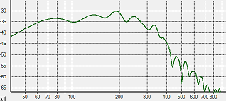

This is the floor firing woofer taken ground plane outside the mouth. The second plot is using damping across the back (taken off the floor). Low end isn't ready. Some crossing.if the upward facing sub- has benefit over a forward facing sub.
There could be slot load style cancellation above 400Hz. The modes are fairly simple, but set fH. This is a 15" with a back and one side. The opening is approximately Sd.

Maybe ported, isobaric 😕can anyone enlighten me on how this is working,

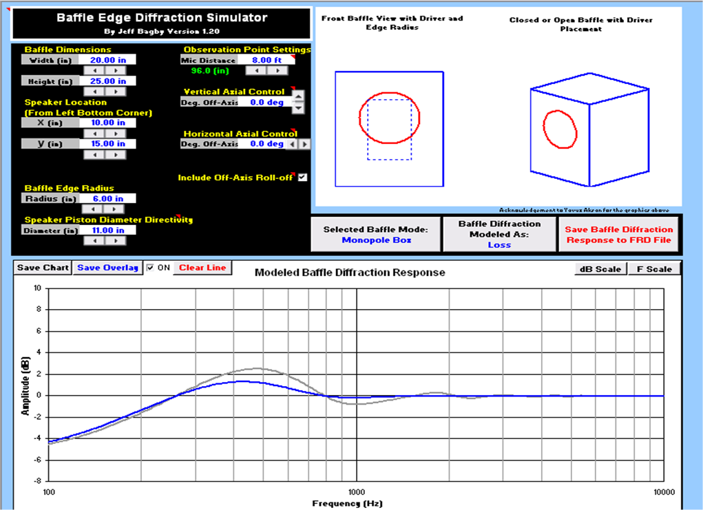

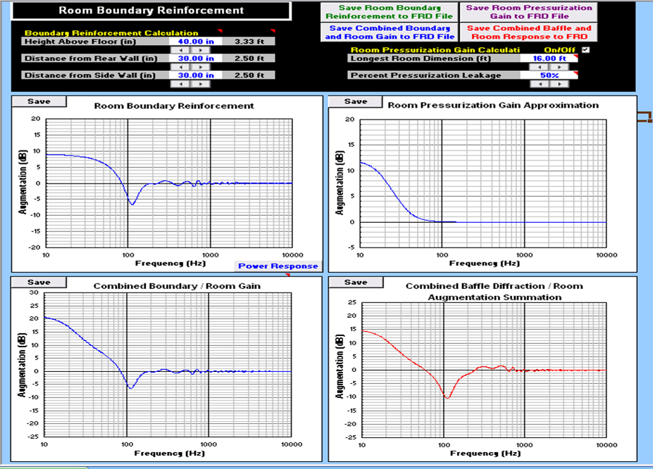

Whilst waiting for the drivers to be corrected, i have started playing with jeff Bagby's diffraction spreadsheet. I have attached a couple of screen shots of my simulations. As i was anticipating going from a sharp edge to a 6" radius improves things, obviously offsetting the driver to one side would also help. Ideally the response would want to be rule straight, can anyone give me a feel of what i need to aim for. the only thing i have been looking at is the off axis response. for both V & H angles the response remains flat past the cross over freq of 1500hz.
Not quite sure what to do with the room boundary reinforcement plots - enlightment please!
There are a few sources of sound. The first plot is the direct sound, combined with diffracted sound that directs toward the listener minus that which doesn't. This other sound comes back to the listener after interacting with the room.the only thing i have been looking at is the off axis response. for both V & H angles the response remains flat past the cross over freq of 1500hz.

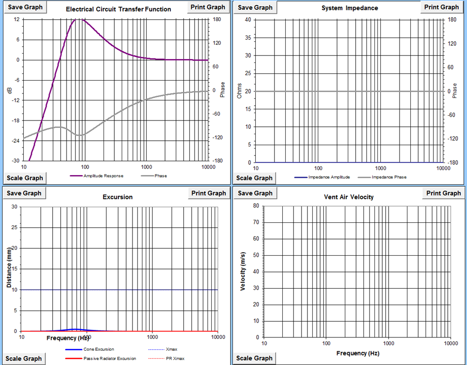

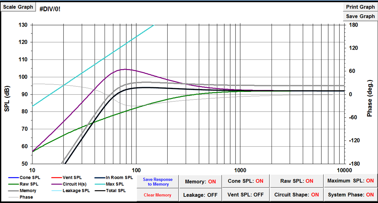

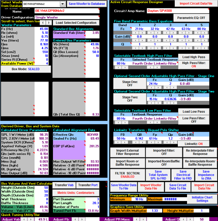

i have been playing with some parameters in the Jeff B's simulation software, for the sealed cabinet for the beyma 12p80nd. Interestingly increasing the cabinet size doesn't seem to lift the response at the crossover point [see fig 1] it does however drop fc. For 50 litres fc=70hz, for 125 litres fc=56hz, i assume as am crossing around 80hz keeping fc as far outside the running range as possible will be best.

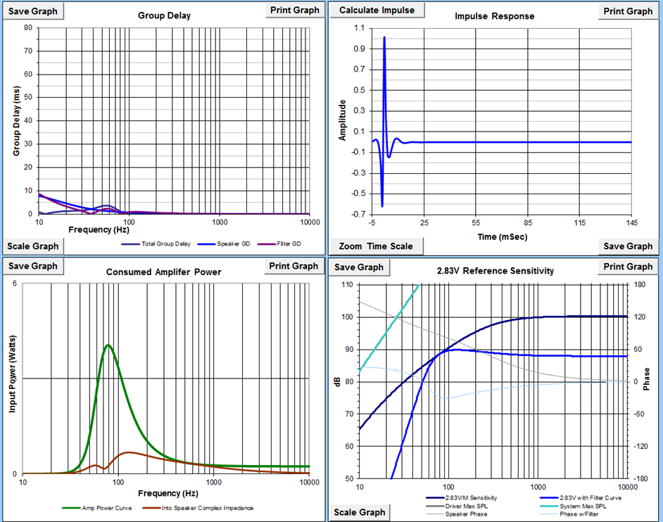

Fig 2 shows my input to the worksheet. Fig 3 shows the proposed DSP input to get a flat response. I show the response @ 4 and 8 watts the later being the max for my dht amp. The levels i think will be fine for my 1500 cubic foot room.

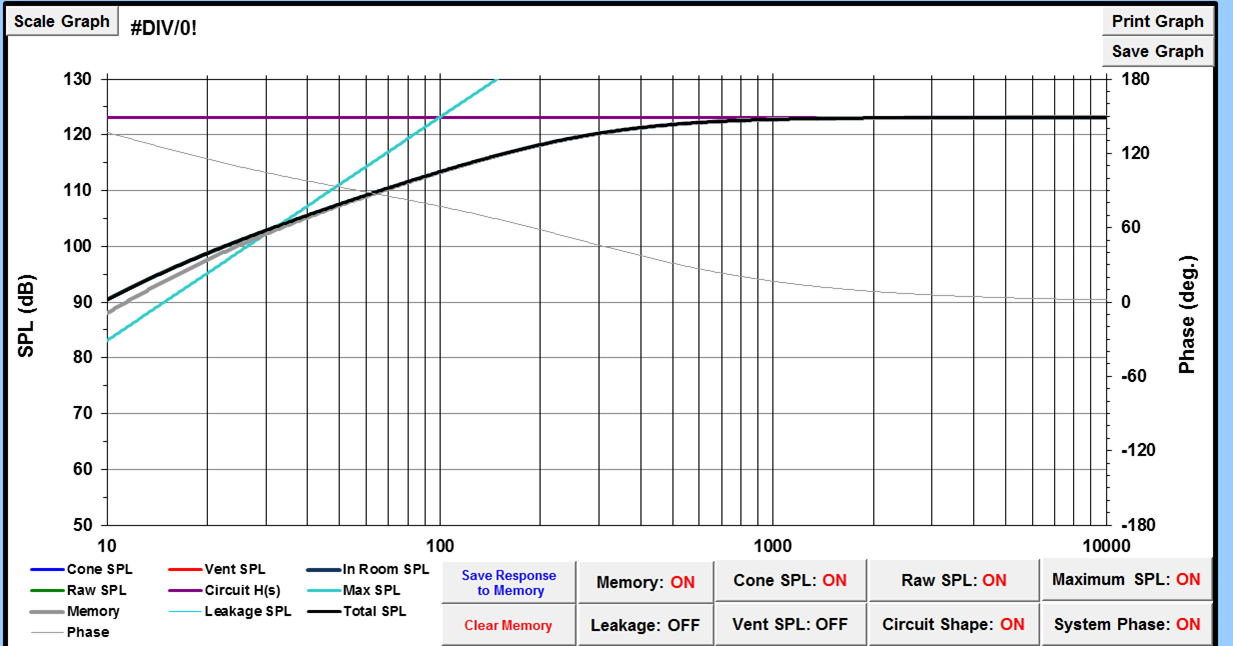

Fig 4 and Fig 5 detail the other outputs from the simulation.
Does it all look sensible, or have i missed something?

I ran the Bagby spreadsheet with your parameters and Qtc is coming out as 0.232. Isn't that so low it would sound "anemic"?

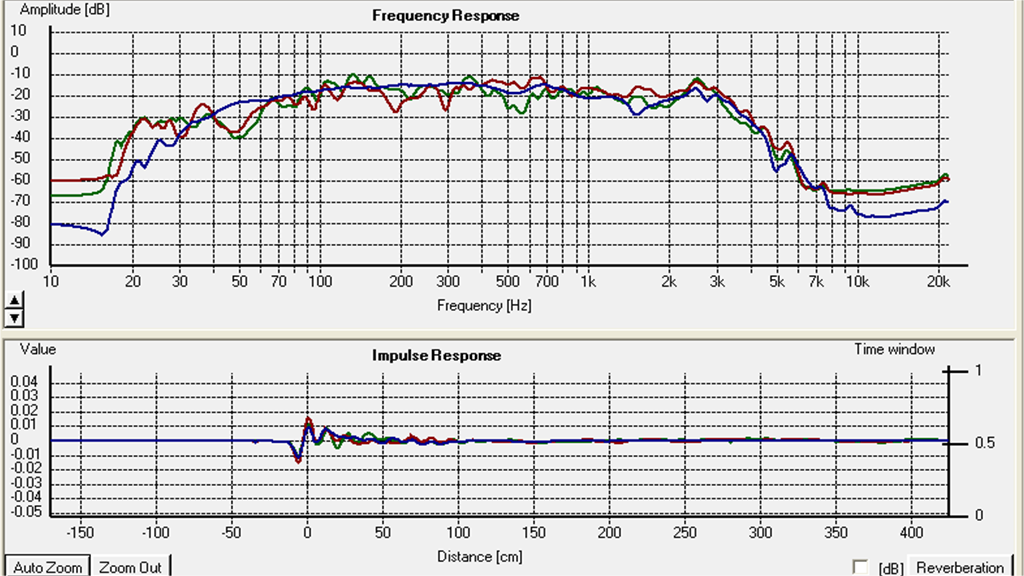

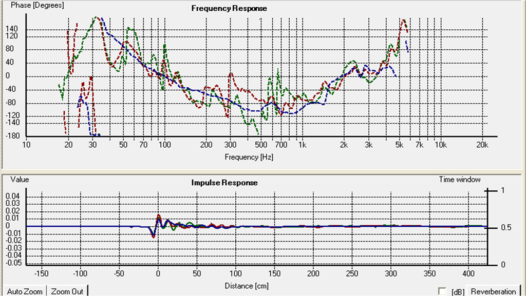

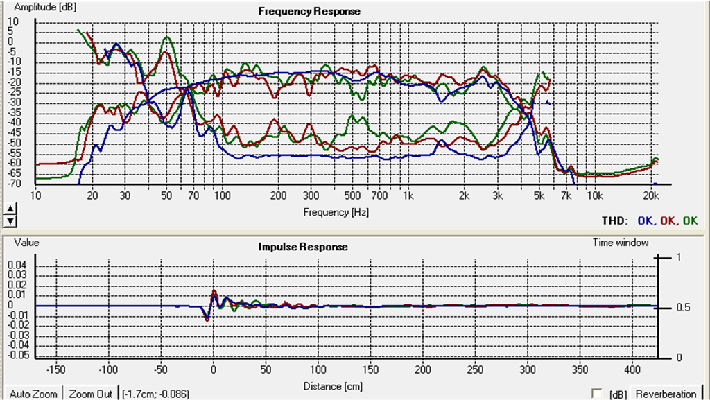

Drivers eventually turned up. Here are a couple of measurements i made "in room" so need to discount room contribution.
In a seal box of around 140 ltrs, 50% filled with BAF (all i had), LF is contoured with DSP to give a flat response to 80 hz ( ~+10 db low shelf)
Blue trace is at 10cm from dust cone, red trace is 1m away, greem trace is 2.4m away at listening position, traces normalised on SPL. Pretty true to spec sheet accounting for the room.
The distortion in the last picture is a concern if is real, seems to get bigger the further the mic is away from source - so i assume erronous.
Next phase to fill cabinet with concrete block to bring the volume down to 70 ltrs and 50 ltrs to see if my calculations match reality.
Thanks for sharing this. Were you able to listen to music? How did it sound?
Response looks pretty impressive from 80 to 2000 Hz. I guess people aren't crossing it over at 2kHz because of beaming. Would be a natural choice with a TPL, yet folks are xo this combo at around 1.6kHz.
Does your DSP "cut down SPL" only, or are you boosting down low? I ask because I use Acourate for DSP and it will only cut down.
Not had a chance to listen to then in speakers yet, listened to one driver on its own, initially sounded like a poor quality radio, but is improving as iit's being used more.
My aim is to use it with TPL, just got to understand how much of the midrange horn magic i am sacrificing, weighting this up with the better coherence i will have from not having a x-over in the critical 300Hz range.
As far as i know, cutting back is the best approach to defining gain structure with a DSP, which is what i have done.

Hi Vinylvalves,
Thanks for your measurements made in your room.
My eyes are not trained to understand all the substilities of a curve reading, so I just have two questions please :
- I don't see an around -6 dB Bafle Step on the raw curve : are the measurements made without a bafle ?
- Room modes give you a gain below 100 hZ ?
There was a baffle 600mm wide, with the driver 500mm (centre) off the floor. All room gains have probably been negated in my adjustment with the DSP to get a flat response in the frequency range i require (80hz to 2000Hz).
