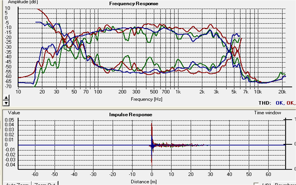

Ended up filling the cabinet up with loads of paper back novels to reduce the volume down to around 60 ltrs. Legend for attached trace is a before, was going to show a direct comparision to highlight effects of changing volume and lowering q, but Holmimpulse crashed half way through and i haven't removed all the books to re-do original measurements. Seemed to be very little difference maybe the loss of a couple of db around 60hz, which is as expected. Diificult to see if distortion increased as room modes over shadowing.

I'm curious why you are using such large enclosure. I believe it's sealed, right? Running UniBox for the 12P80Nd in a 140 liter sealed box returns Qtc of 0.178 and F3 of 307 Hz, while running it for 60 liter returns Qtc of 0.215 and F3 of 302 Hz.
Sincere question here. No challenging intended. I was told very low Qtc deliver dry bass, but maybe that's not your experience? I was told to aim for Qtc = 0.707.

Regarding a low box qtc - giving dry bass, how would you define dry bass? Without equalisation yes you would get less upper bass, if all you did was increase the cabinet size. But the system is being designed to be equalised. You get about 2db more response at the cross over freq and about 6 db down at hz compared to a 0.7 qtc cabinet, which means less amplifier power required. From a quality perspective you are compressing the air in the cabinet less - which has to be a good thing.
