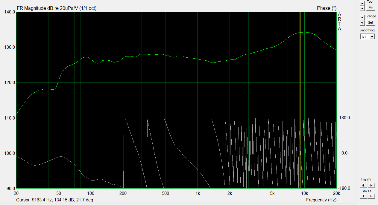

I managed to take some measurements with ARTA, using a Panasonic WM61-B capsule. There is an 5dB, broad peak at around 10kHz, which I do not know what is being caused by. Any ideas?
I've attached the Arta file too.

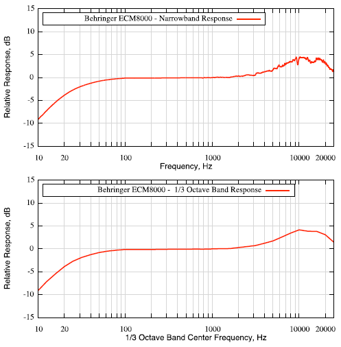

That is caused very likely by the characteristic response of the capsule you are using. Very similar result to the ECM 8000 microphone from Behringer. All my measurements looked like this -on all tweeters I tried- (broad peak from 3-4k to 15k then quickly falling), before I applied the ECM8000 mic.(calibration) file for the measurements.
