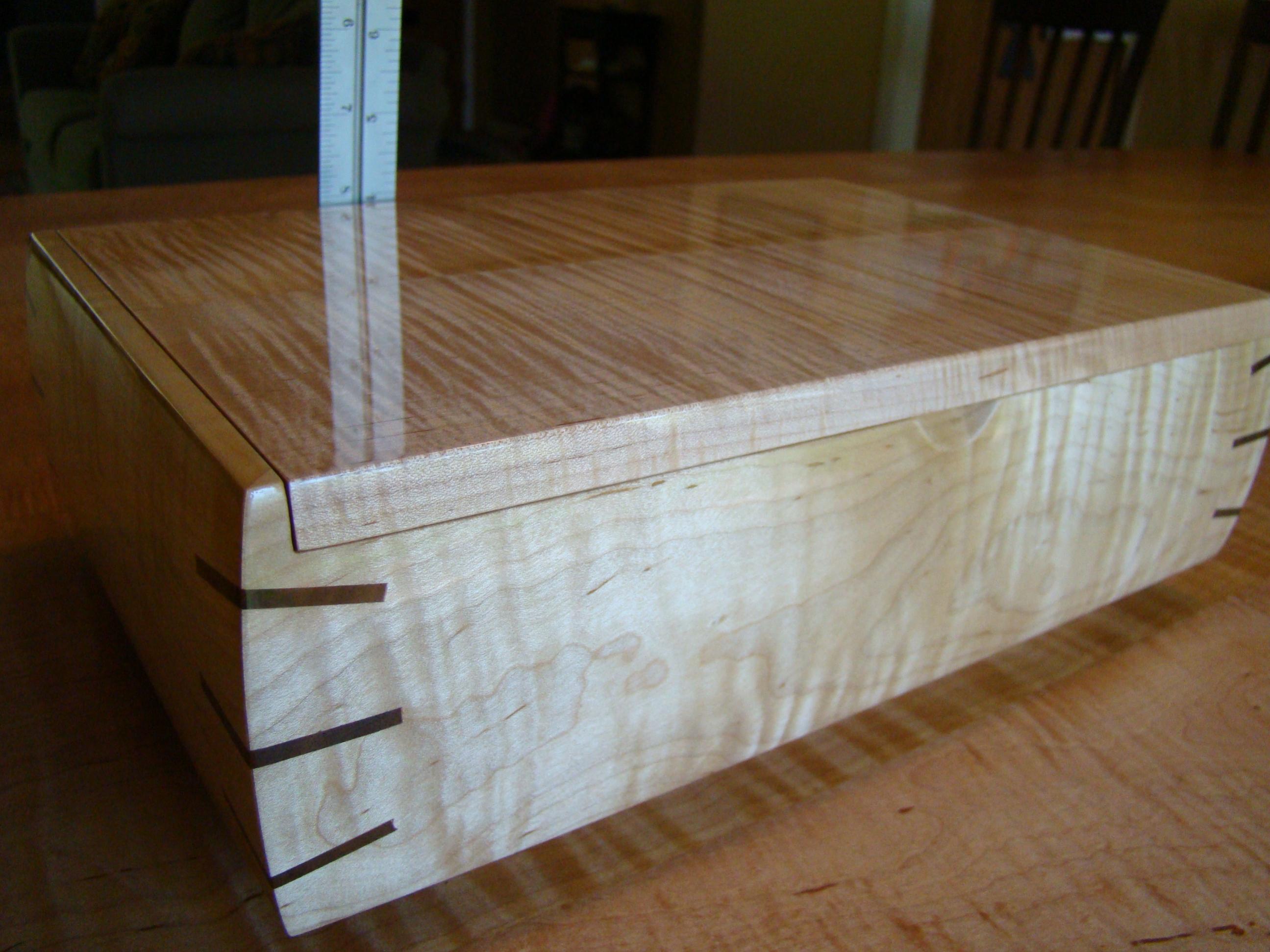

#5. Steel wool every few coats to help the finish build evenly. Two or three times in the course of building up the finish. After the last coat rub with 0000 steel wool using some wax to lubricate the wool. You will get a shine that you can cut back with dry steel wool.

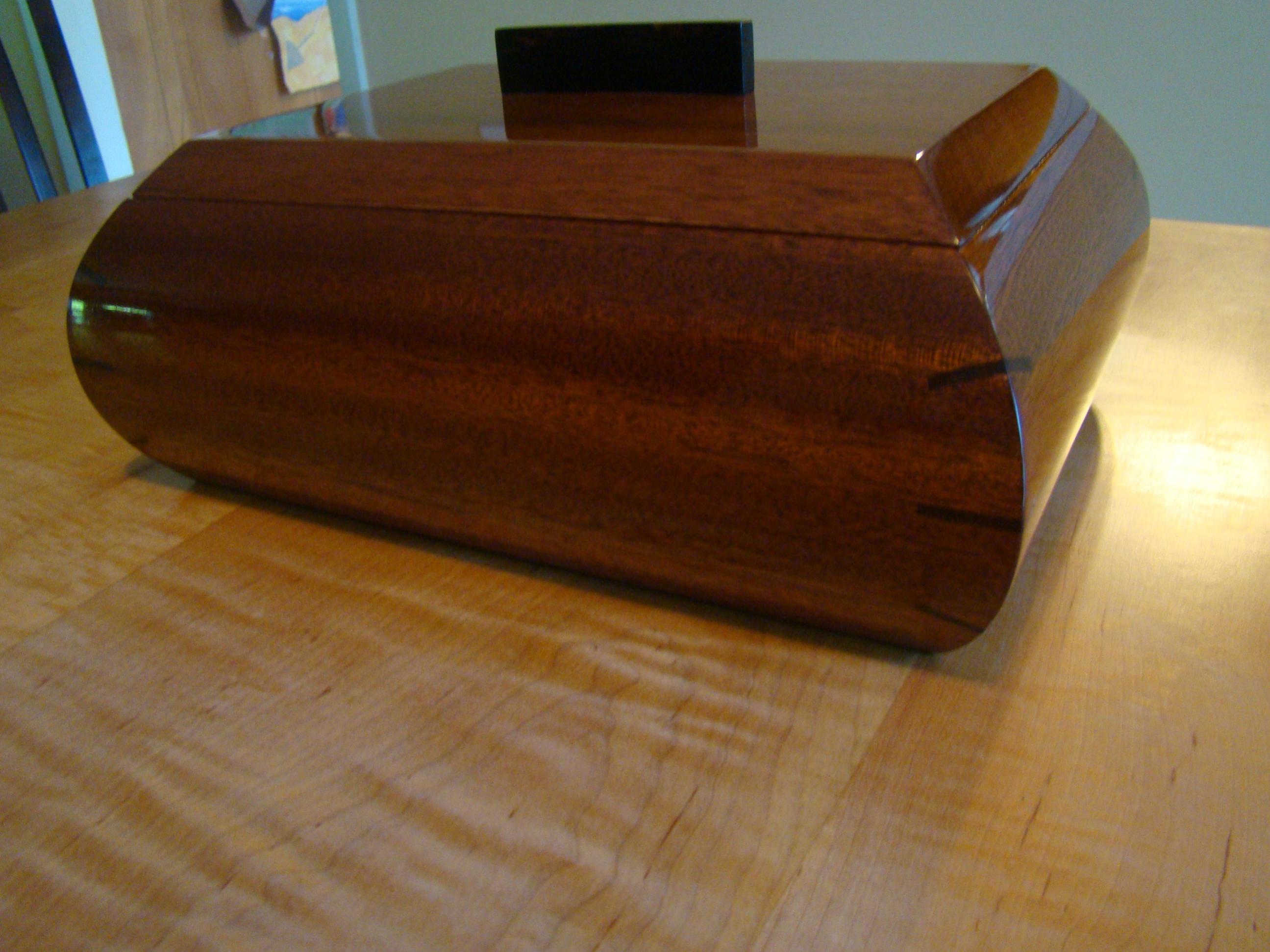

Thanks evanc great advice and pics, looks like you can get a superb finish too. I'll use a oil based stain rather than water based. Is the stain really needed though? I've seen different colours of shellac flakes and believe the more layers of shellac thats applied the darker it goes.
Would buying coloured shellac be a better option that oil based stain?
I ideally want a finish similar to pic2 from evanc but a little darker.

Plywood can be had with many different species of wood as the veneer layer. That box is sepele. If you want darker that wood stains very well ...looks great colored with a dark walnut stain.
You can get shellac that still has its color, but imo this is more for toning the final finish then setting the base color.
I think your right it does look like sepele and can understand your point about coloured shellac is more for toning the the finish.

Evanc, that ligth box is beautiful, is it ash or sycamore? I used a similar veneer on my Curvy Changs many moons ago.

Yes as far as I can remember it is English sycamore. I wanted birds eye maple for the speaker chamber and a quilted effect maple for the outside, but veneers over here are rather expensive and it was going to cost over 400 quid...
