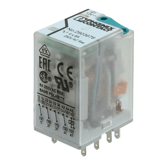

I use these in my speaker switch boxes...
https://www.digikey.ca/en/products/detail/phoenix-contact/2903676/5199620

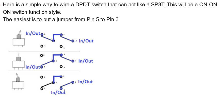

BTW, you can combine a few toggle switch work as DIP switch to get the job done.

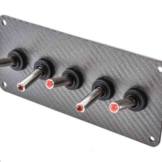

Thanks for the suggestion of this switch. I’ll have a think. Maybe for now, it’s more sensible to try to keep it simple just to stick to 4/8 ohms with a 3PDT toggle switch. Cheaper and less wiring that I might accidentally wire incorrectly! Going to a 6 pole 3 position rotary for 16/8/4 ohms looks a lot more complicated (and I’m sure 16/8/4/2 is more complicated and also means an even bigger rotary switch)

I’ve been looking at 3PDT miniature toggle switches. I have a 4PDT with same lug spacing at the solder points as the common side 3PDT/ you can buy. The solder points are so close together. Might be too close to be useable. I can see what you guys meant about it being easy to solder a rotary switch, so maybe I should consider one, for 16/8/4 ohms or maybe even going all the way to 16/8/4/2 and just get it all done and out of the way so the amps then have max flexibility

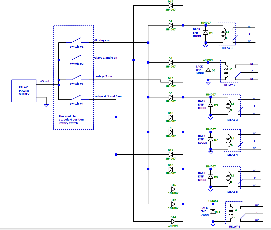

Hi, diode switching of relays is always an option for a task like this, I have drawn up an example of how diode switching is implemented, one could modify a cheap multiple relay PCB purchased from Ebay.
If not into microcontrollers one could cut off the electonics from a PCB like this and add some diodes to a rotary switch.

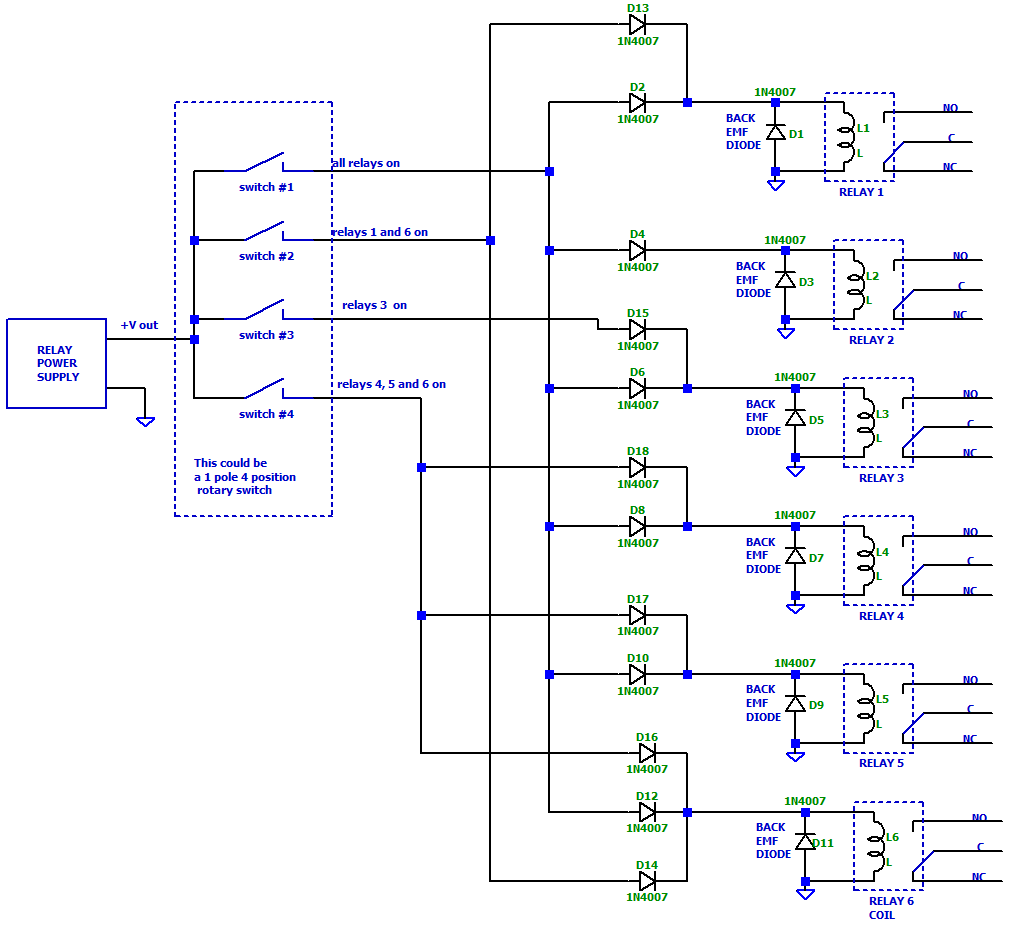

If I wanted to have access to all 4 output impedance taps (16/8/4/2, what is the advantage of the diode relay/switching method over a rotary 8P4T switch? Or advatages/disadvantages of both?
If the best sound is a priority, might a high quality rotary switch be a better option? (that has no PCBs)
Some advantages of the relay diode option.
1/ Sometimes it is easier to see what is going on for instance 1 relay could join BK to CL this connection is used for the 16 ohm selection and the 8 ohm selection so diodes are used to select the relay when 8 or 16 ohms, you could write BK-CL on top of the relay and even have a LED next to it come on.
2/ Cheap relays handle 10 amps or more, so good for very high power.
3/ Easy to remote control
4/ Easy to drive from a microcontroller. The diodes could be exclude and make before break implemented. A $10 micro board could give Bluetooth control; this is an advanced option as programming skills are required.
5/ One relay could use the NC (Normally Closed) to place a load across one of the output windings so if no power to the relays the amp output is loaded, this could also used to mute the speakers and feed a headphone connection.
6/ A rotary switch could control all the relays. DC only on the wires so the selector switch could be on the front panel.
A single pole 12 position rotary switch with a adjustable stop costs <$5 and could do 2, 4, 8, 16 ohms and headphones.
7/ Easy to reprogram by moving diodes about.
8/ Could be designed to use only NC contacts.
Some Disadvantages:
1/ A power supply is required, it could be floating and derived from the 6.3V supply.
2/ It might take up more space, this will depend on the relays selected.
3/ More complex.

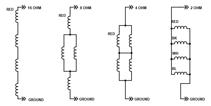

Without knowing the secondary windings design exactly, I'd be totally lost. Even the manual only gives vague hints. I'd like to see the transformer's schematics.
Anyway, isn't there a winding terminal that always connects to GND and another one that always connects to the output, hence doesn't need to be switched at all? And is there any need for the 2 Ω option at all?

Can you? I thought the diodes were there to prevent powering the other rails when the switch was turned on. These are DC relays?
Hi boyfarrel this comment was only for when the relays were controlled from a microcontroller, each relay could be powered from a single pin on the microcontroller, normally I would use a relay drive chip like a ULN3803 that has built in back EMF diodes; diode relay selection would be unnecessary as relay selection would be controlled by software, the make before break would also be under software control. The microprocessor option is a more advanced solution.
BTW if a micro was fitted it could also monitor the amplifier for RF, open circuit output and other faults without changing the performance of the amplifier.
Estimated cost of a micro <$5 cost of two ULN3803 (drive 8 relays per chip) <$1 each. A PCB would have to be designed so it might as well have the relays and power supply on the same board.
regards Ken

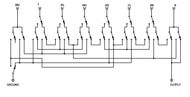

Hi Tubekwk,
I sketched a schemetic based on relay switching, seems like it required at least 23 SPDT relay to select 2-4-8-16 ohm output!
Hi chrisng.
I have done a quick drawing on some paper and believe 2, 4, 8 and 16 ohms can be accommodated with 15 x 2 pole relays ( one pole for each channel).
less relays if you drop the 2 ohms. I will post the drawing after looking it over when I'm next at the computer.

At some point the number of relays becomes ridiculous and I think a rotary switch is the best option.

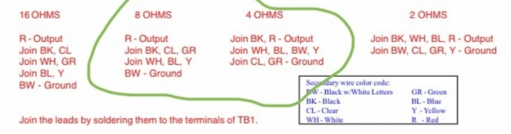

This transformer secondary winding wiring diagram is based on the info from post#12. You can see the output is always connect to RED wire, but the ground is not.
However, I can't figure out what is the impedance of each winding in order to achieve 2-4-8-16 ohm output. 🙁
One of the winding phase inverted for 8 ohm and 2 ohm?
Screenshot 2023-02-28 at 19-53-28 Scheme-it Free Online Schematic and Diagramming Tool DigiKey...png
Screenshot 2023-02-28 at 20-15-55 Advice on output Impedance selector switch.png
Each winding segment is 1 Ohm, giving 4, 9, 16 when series or series parallel connected. All in parallel is 1 Ohm, called 2 Ohms since that might be useful (two 4 Ohm speakers in parallel).
It would seem that two DPDT switches would do to select 4, 8, 16 - but the specific order probably matters - the 8 Ohm connection shown (center pair in parallel) may be better than other combinations at high frequencies.
